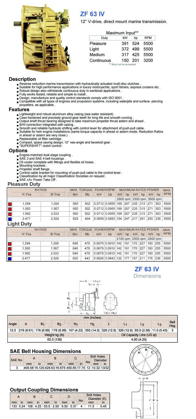

Regarding your Nevka transmission and spare parts if needed. Should you really have problems reassembling it and are in need even to replace it, let me know! I may try to find you a brandnew ZF gearbox for replacement, if you let me know your reduction ratio. You may get it then via your local dealer.
The enclosed picture is for a V-drive suitable for Volga and you may use it with a gasoline or modern diesel in combination with a bell housing + bearing and a cardanshaft in remote location. This gearbox replaces the engine mounted gearbox and the V-drive gearbox (direction changer) and should make you half the weight of those components. The power factor (rating) is pleasure or light and it should be able to cover also the more powerful Nevka engine.
Please mind, that this gearbox has a hollow bored output gear, and the propeller shaft is being therefor led thru the gearbox and then mounted via a companion flange on the forward position. The companion flange is mounted the other way round. A very clever solution as you can place the gearbox deeper inside and access the bolts of the shaft flange from above, rather than fiddling like dentist under the gearbox in tight areas.
There is also a bigger V-drive gearbox available with other angle which might be more suitable. I'll enclose this one next time.
ZF63IV (V-drive gearbox)S.JPG (183.35 KiB) Viewed 744020 times

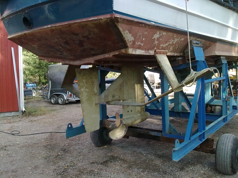

Regarding Nevka, I do not belive ZF can offer any replacement for this from any standard series. See enclosed picture of drive.
It is a "High tec" russian design of a Z-drive. Engine, gear, pod all in one beautiful package. No noisy shafts in between.
But thanks any way, I have at the moment one engine and one gear as spares. I also had one complete pod, but it was stolen from a garage in russia last summer.

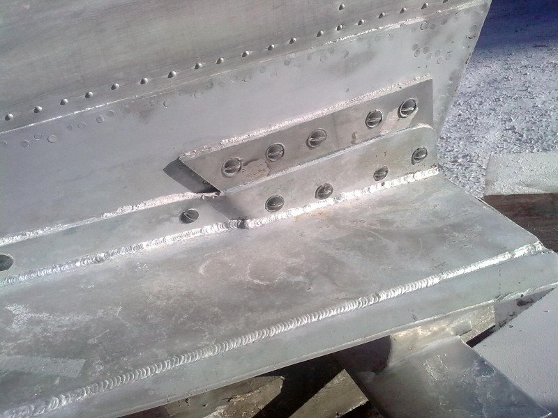

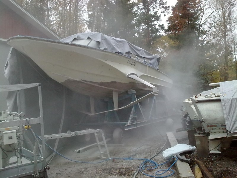

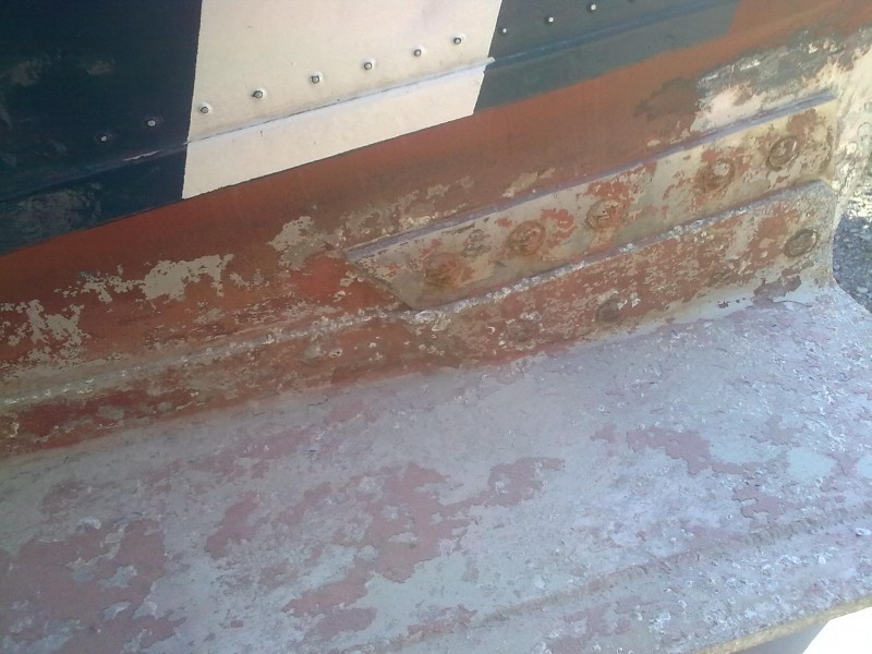

I just bought Soda Blasting equipment, have cleaned some aluminium boats and Nevka.This is the real thing for aluminium and composite.
br
Flying Finn
Before Soda Blasting
After Soda Blasting
After Soda Blasting
Soda blasting of Nevka
Nevka pod and back wing. Depth 1,85 m.

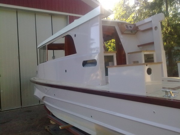

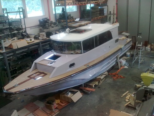

No so bbaddddd news here..... just been a hell of a lot of other work the last time. There were even NO Volgas on water here last year, even if there are several just to launch. This is unforgivable, yes I know it.

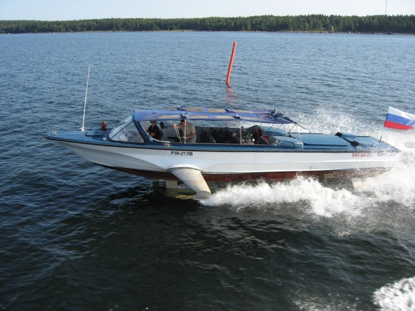

But something new has been done, a completly new Nevka. Only original, is the outside of hull and the drive line.
Enclosed some pictures.
BR
Robert
Original boat
Original boat
New Nevka
New Nevka

Aft deck
Aft deck
