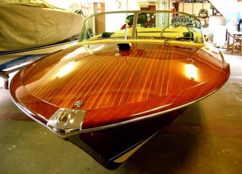

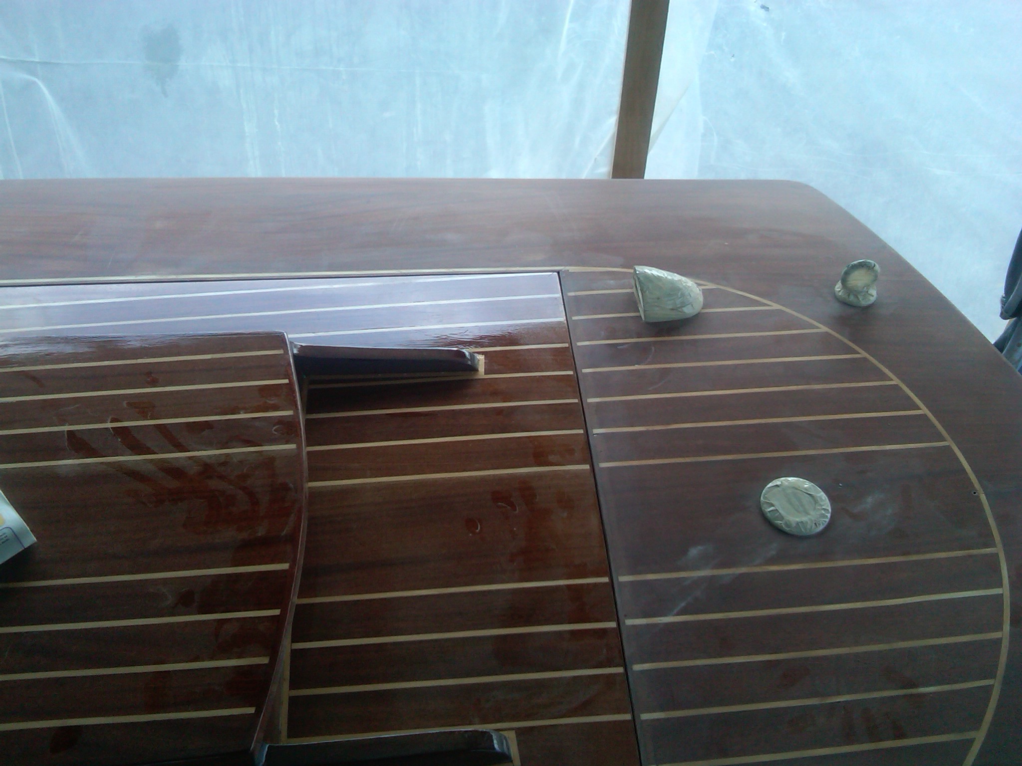

Rounded top wooden deck

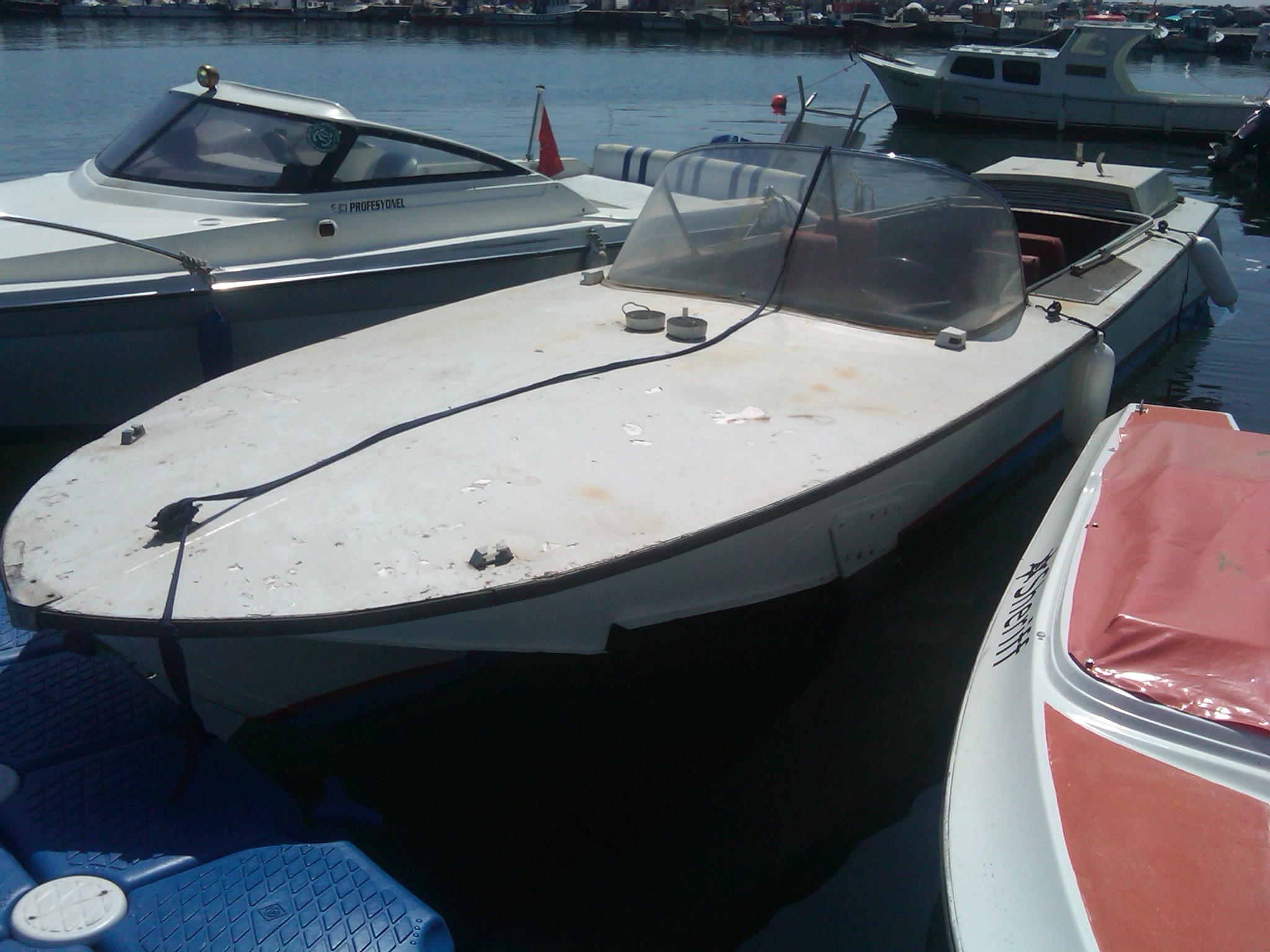

The story starts there where someone else says she actually was expecting a boat shiny painted with wood work, whereas I was already fine with what I had and intended to do some minor repairs to start with boating as soon as possible and then see what could be changed or refined. This someone was off corse no one else than my wife who then bluntly said that she will not join any kind of trip with a boat which was not completely overhhauled and probably putting our family's live into risk on sea.
Please mind the safety regulation on sea!
One boatbuilder, whom we consulted, made her believe that for all such repair work we should pay already so much money like for a new boat, because what was only useful would be the hull and nothing else. Which meant that all russian onboard equipment should be going directly to scrap, especially the engine. In fact he was right in what he said because we went to hell with my obsession to repair an engine originally (I certainly will be back on this issue) . I think that his intention was rather to sell one of his ready boats, which bursted somewhere in the darkest place of his body, due to the crisis. He tried to make his own boats more attractive propagating that they have a camera and also a toillet of which he said, that this is what women want/need.
Besides this the prices given for the overhaul were so expensive, that I had to made up my way to experience it on my own.

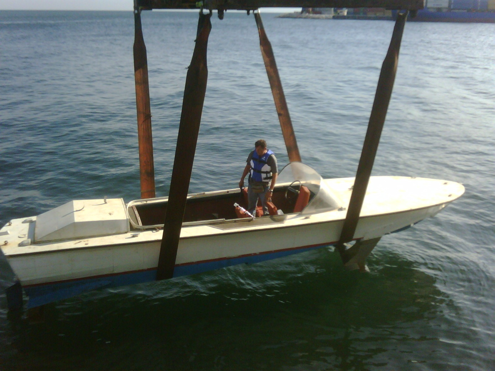

The boat was in a very bad condition after the transport from Batumi. Deck was bumped at several places, paint was so old and top coating was of poor quality cracked and dirty.
Hull bumped and paint cracked at several places

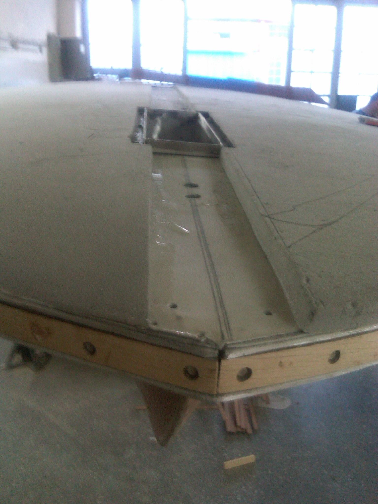

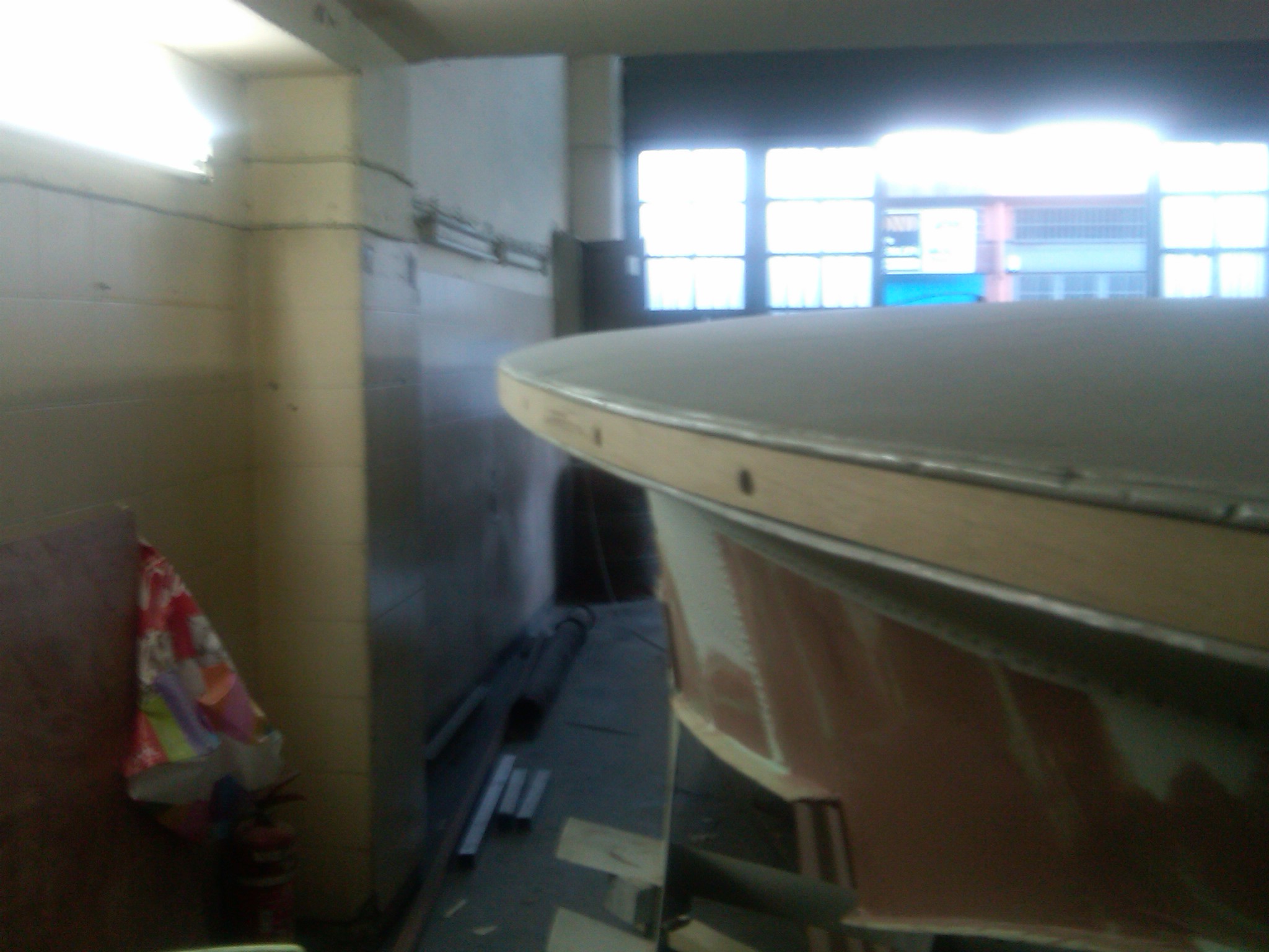

In the istanbul boatshow fair I ran into a boot/fair, which was selling superlight PVC hardfoam sheets, which can be glued on the hull with epoxy resin and later easily shaped by sanding. The material is extremely hard against impacts and superlight. It is extremely easy to shape and when used together with epoxy and glassfibre or fabric it becomes even more resistant. I bought 20 mm thick sheets glued them on deck with 2K epoxy resin,
Sheets glued on an cut.
cut away the edges and rounded them with sandpaper
Sanded and rounded
Sanded and rounded

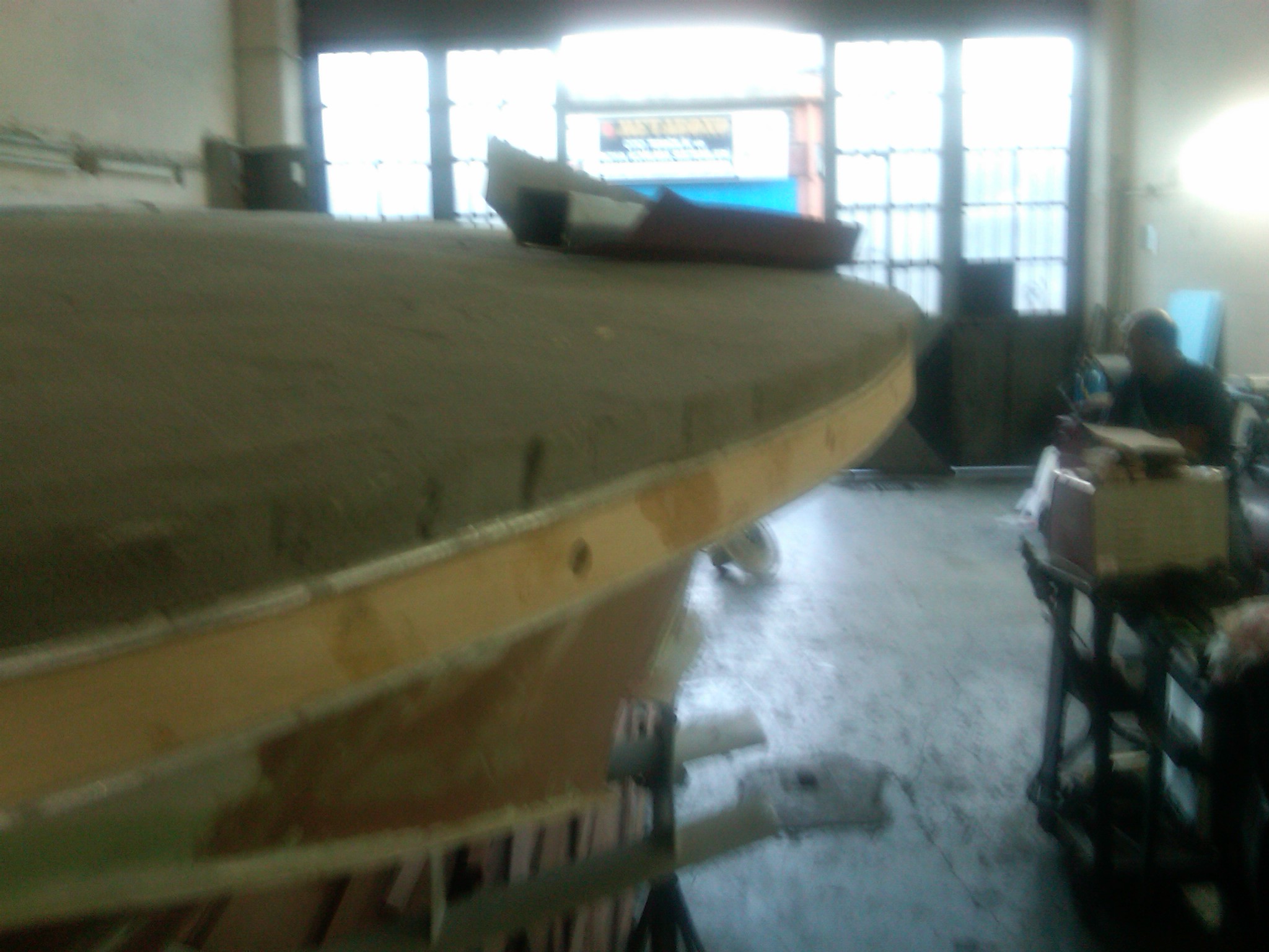

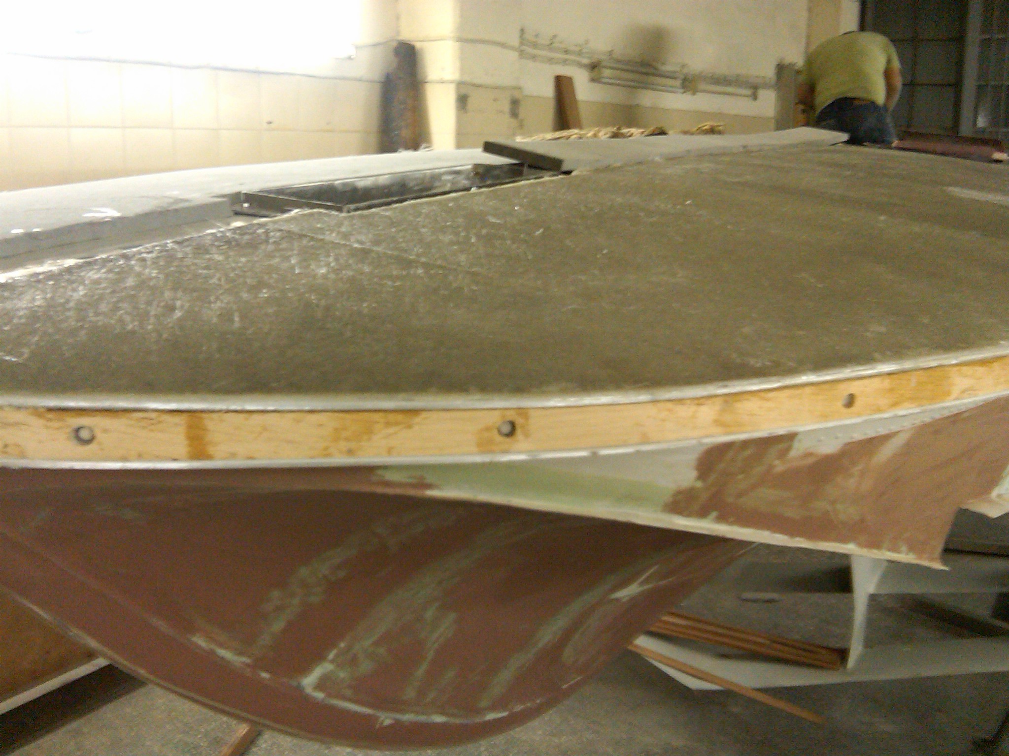

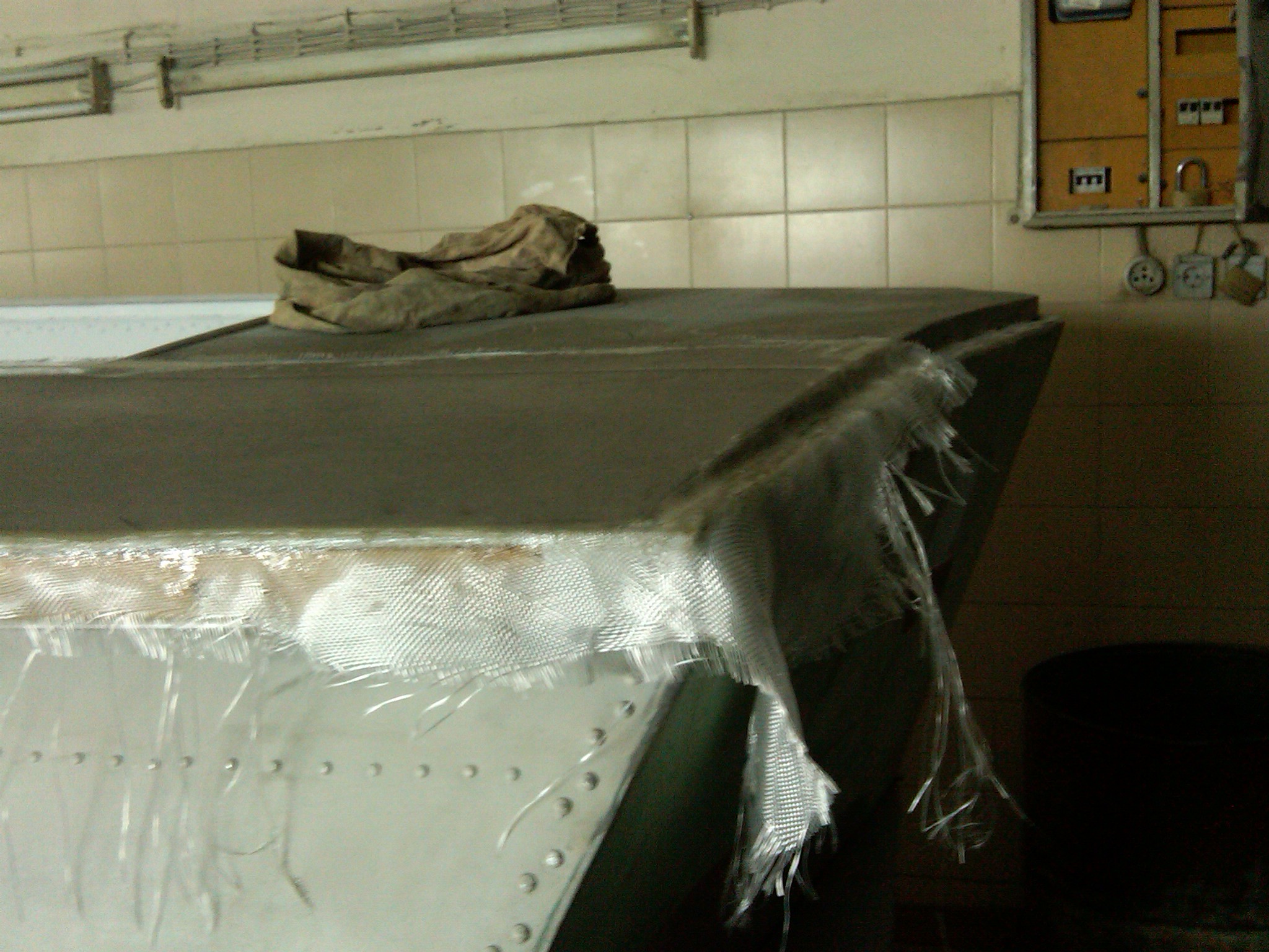

. Later on we applied on the top one more layer with fabric,
White wedding
White wedding
fibreglass
Fiberglass cover
Fiberglass cover
and epoxy resin. This was then also sanded. The deck was now completely even, 22 - 25 mm higher than original and with a rounder shape.
Difference between sanded and unsanded

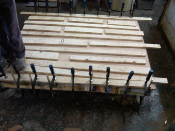

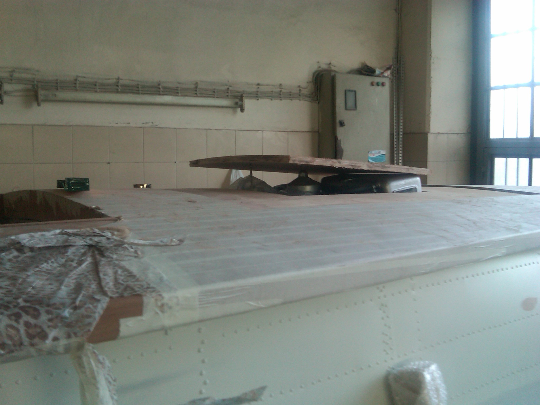

The sheets where so firm and robust that they did not show any deformation even when you were jumping on them.
Everything was ready for Sika bonding of the wood. With the wood layers of 5 mm the deck will get taller by about 30 mm, which was also intended.
(Frankly speeking this could also have been done with ultralight marine plywood and the result and sturdiness would have been probably better than of this material. The rounding effect for itself was not significant. I didn't want to exagurate it.)

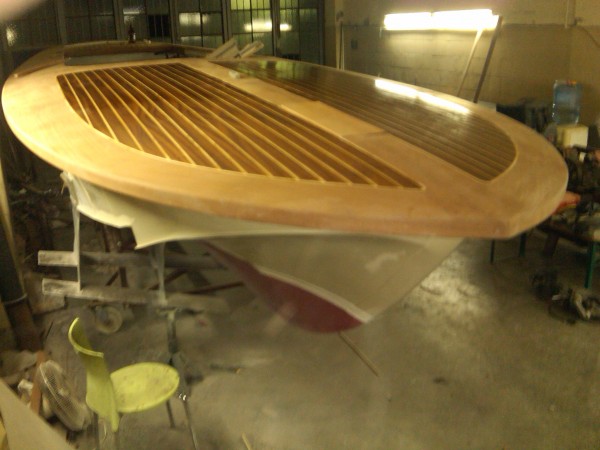

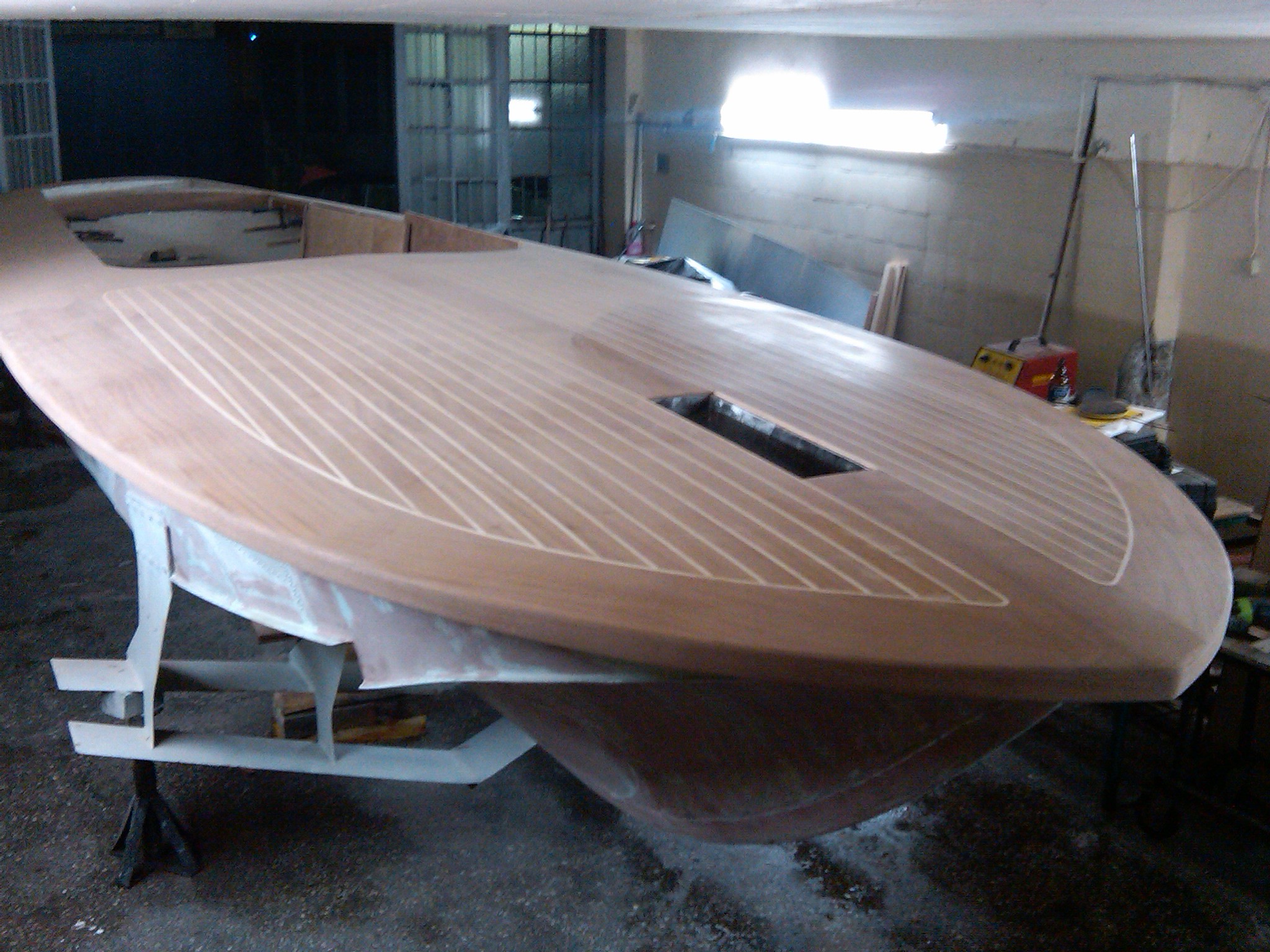

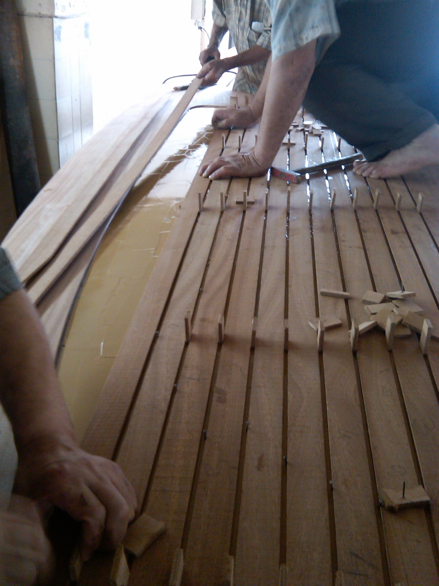

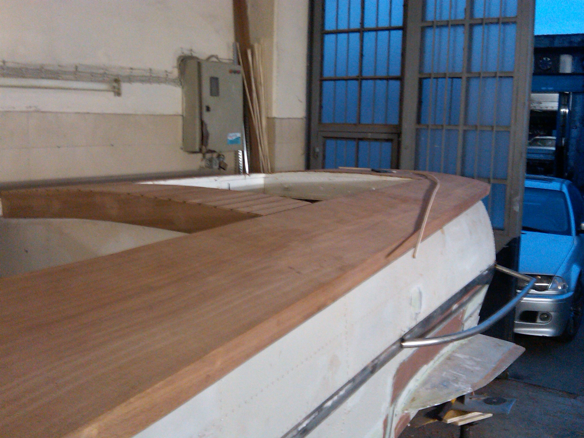

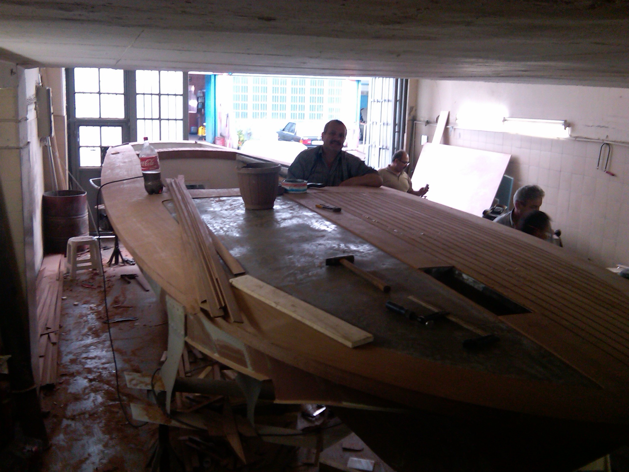

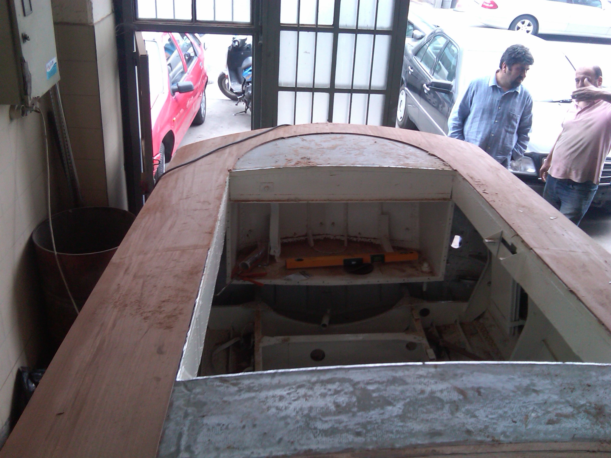

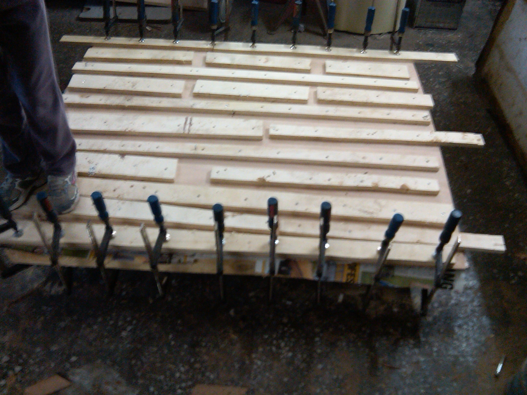

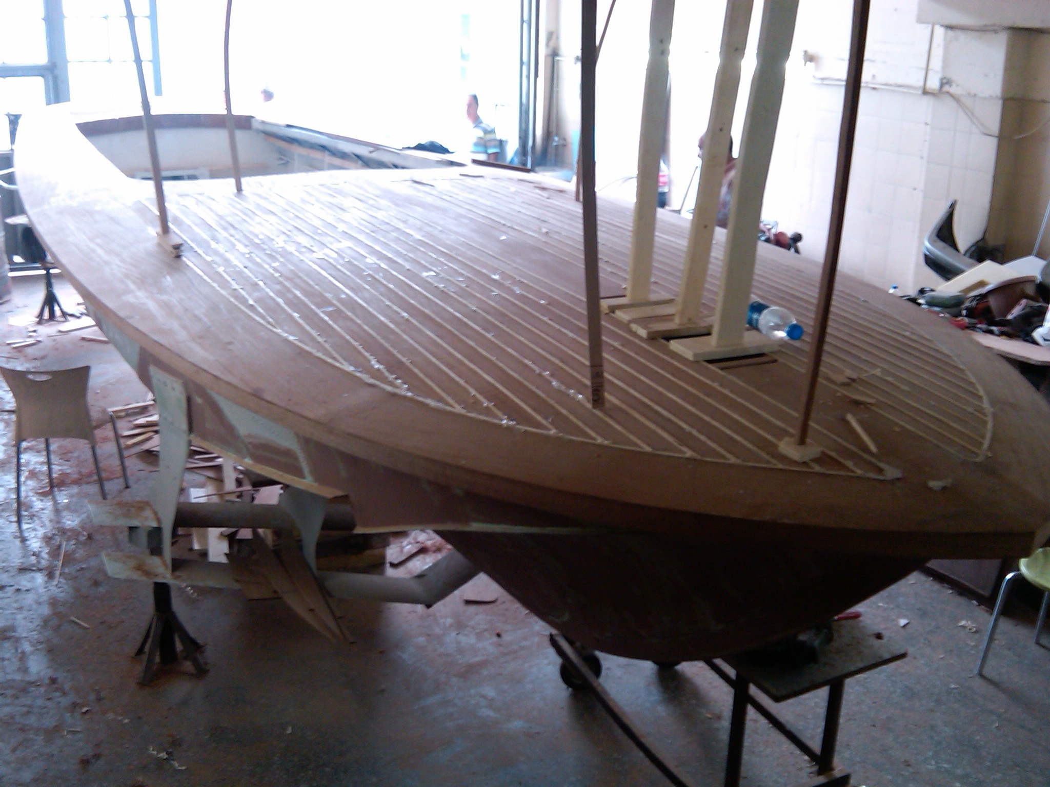

The wooden deck design was copied and/or refined from other Volgas or Rivas. We started with the edges where there used to be the rub rails.
Wooden rail
Wooden rail

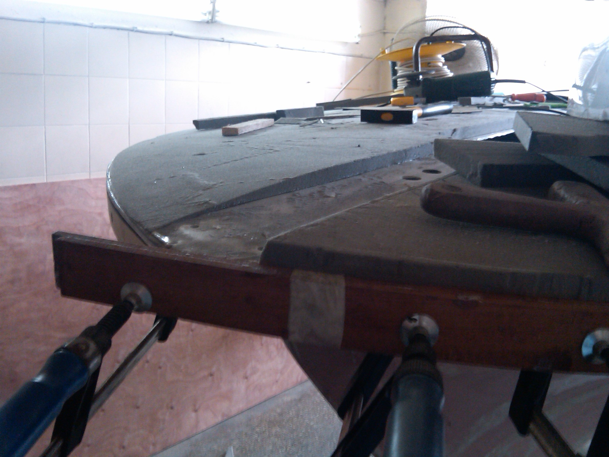

Later on we made the sides and the middle for the frame.
Wood applied on deck
Middle beam with anchor hadge

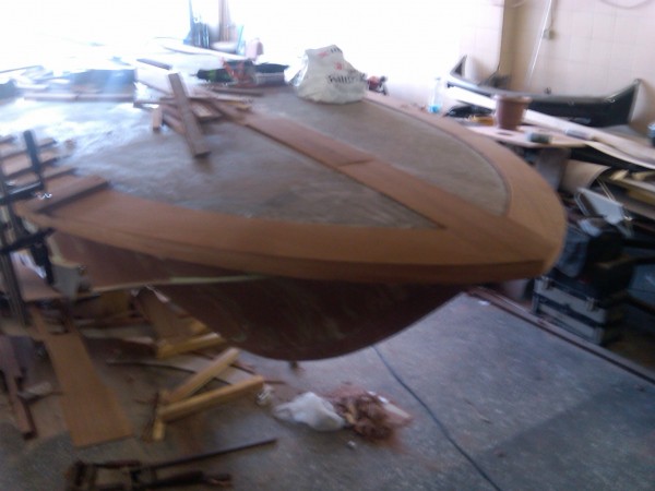

The wood was applied in such way, that all parts had the width.
Width control
Width control

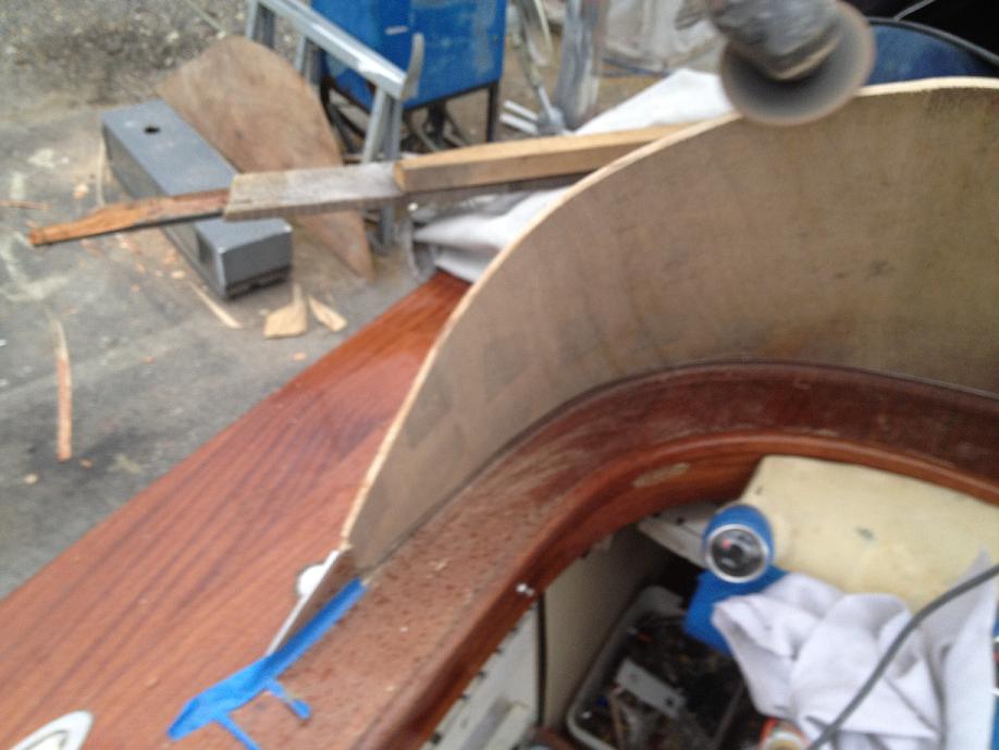

The sides of the cockpit were rounded, too.

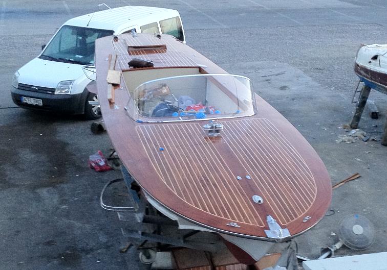

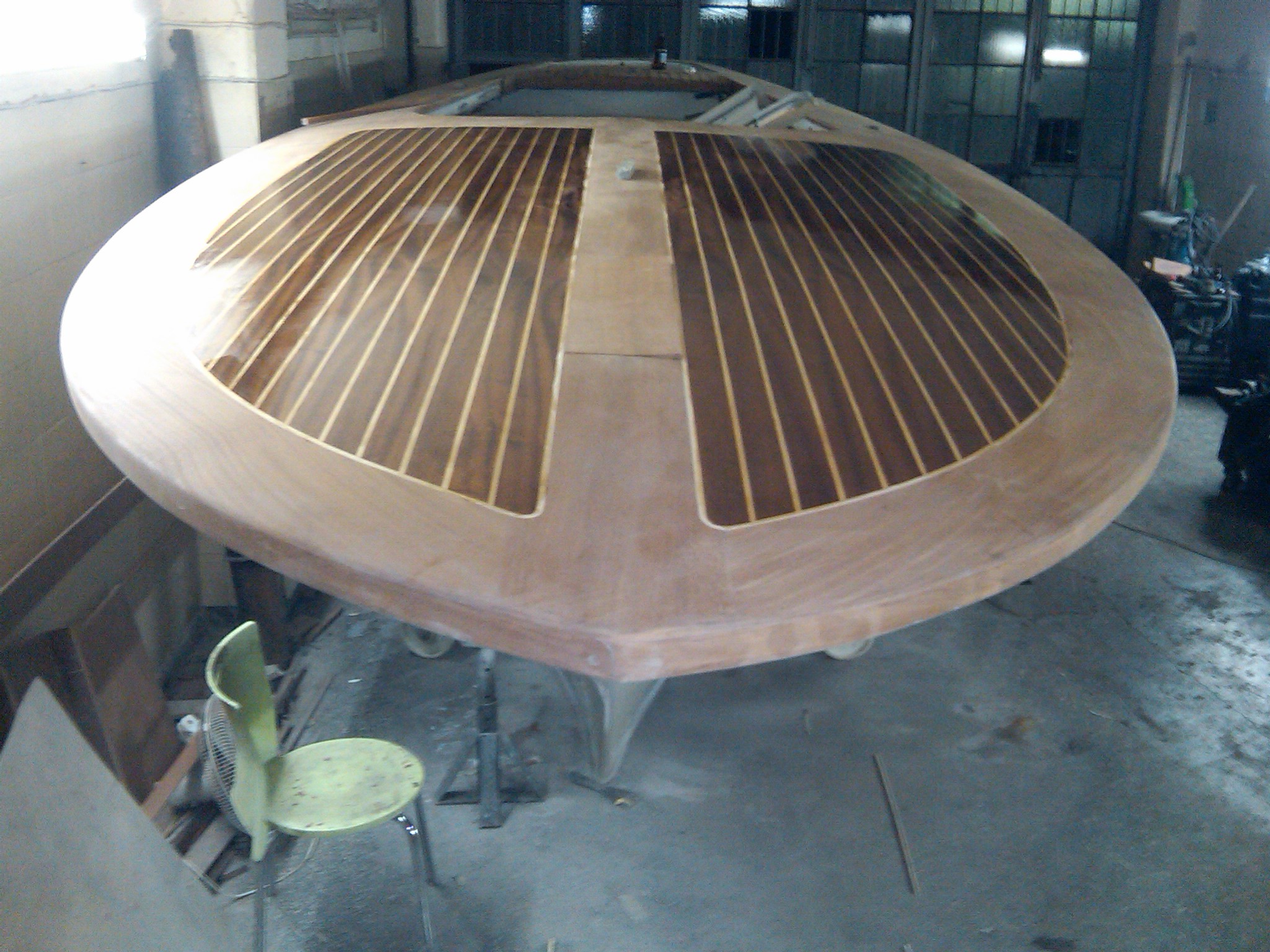

Front view ''wooded''
Back wooded
Back wooded

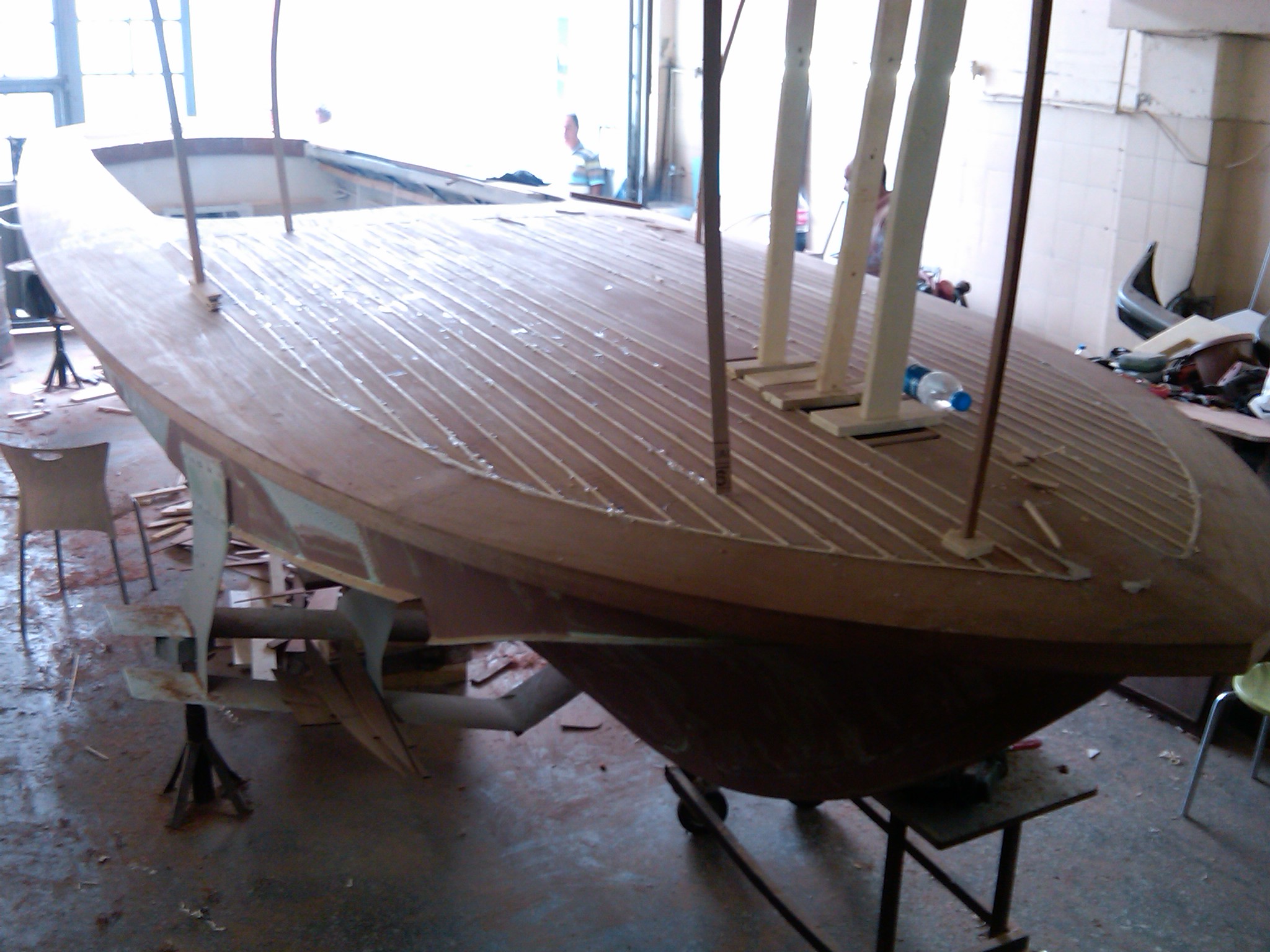

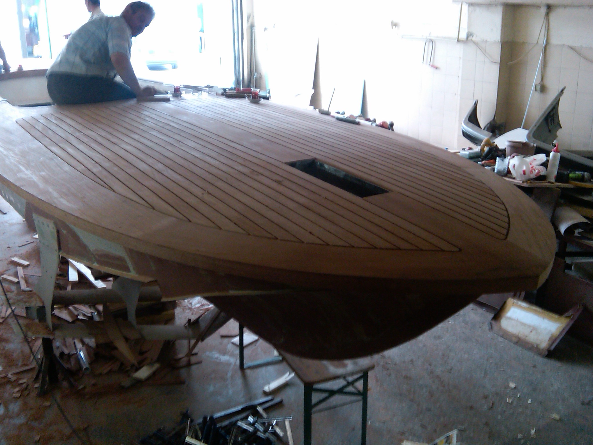

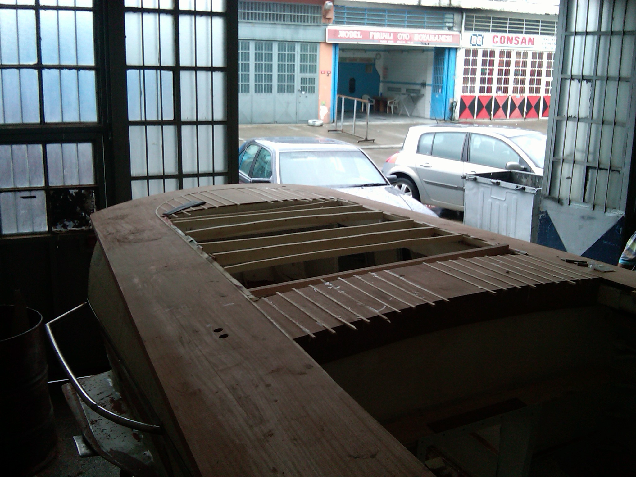

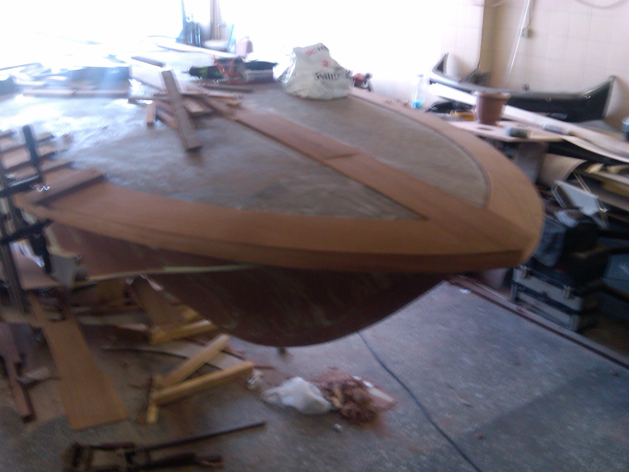

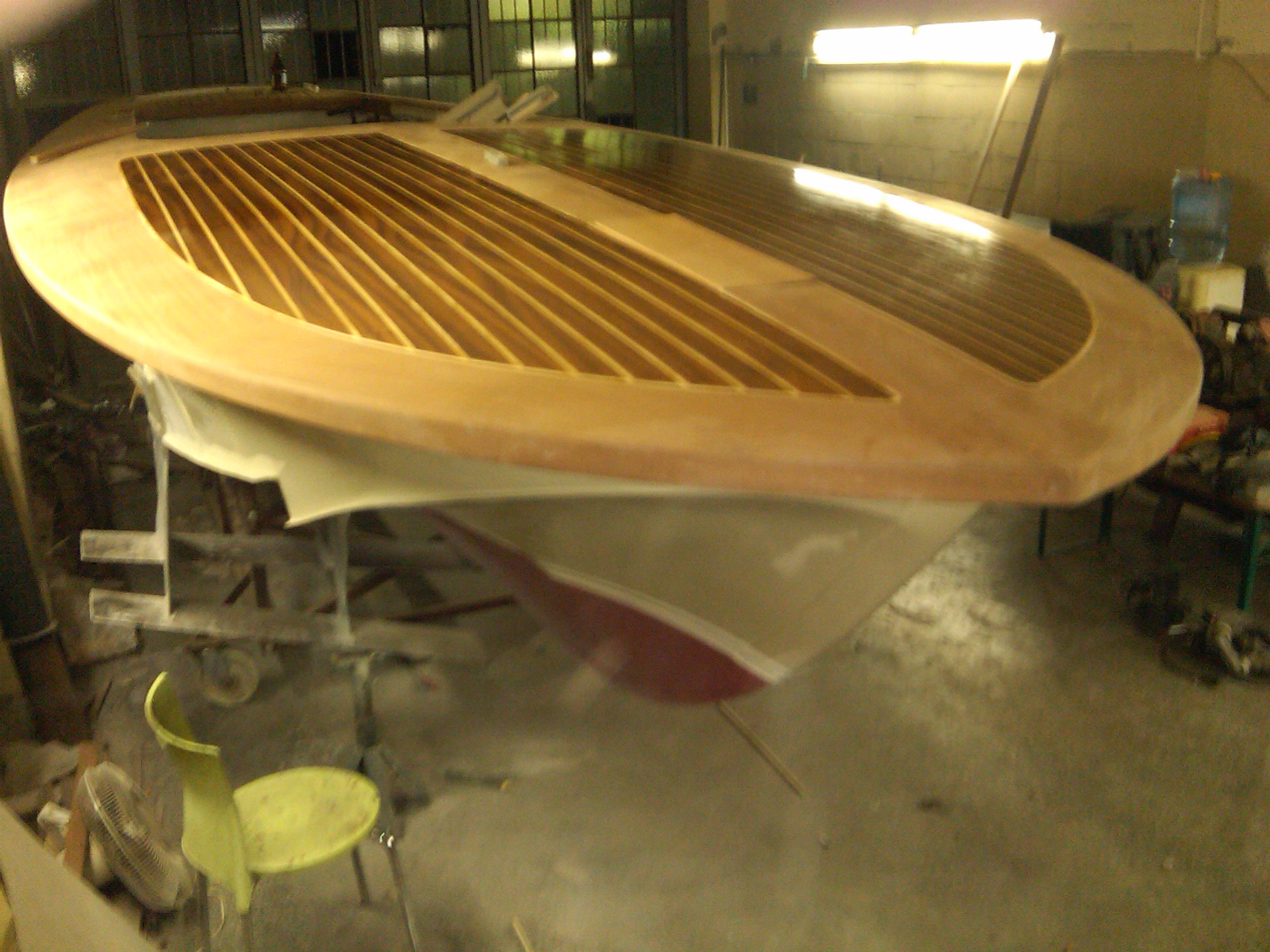

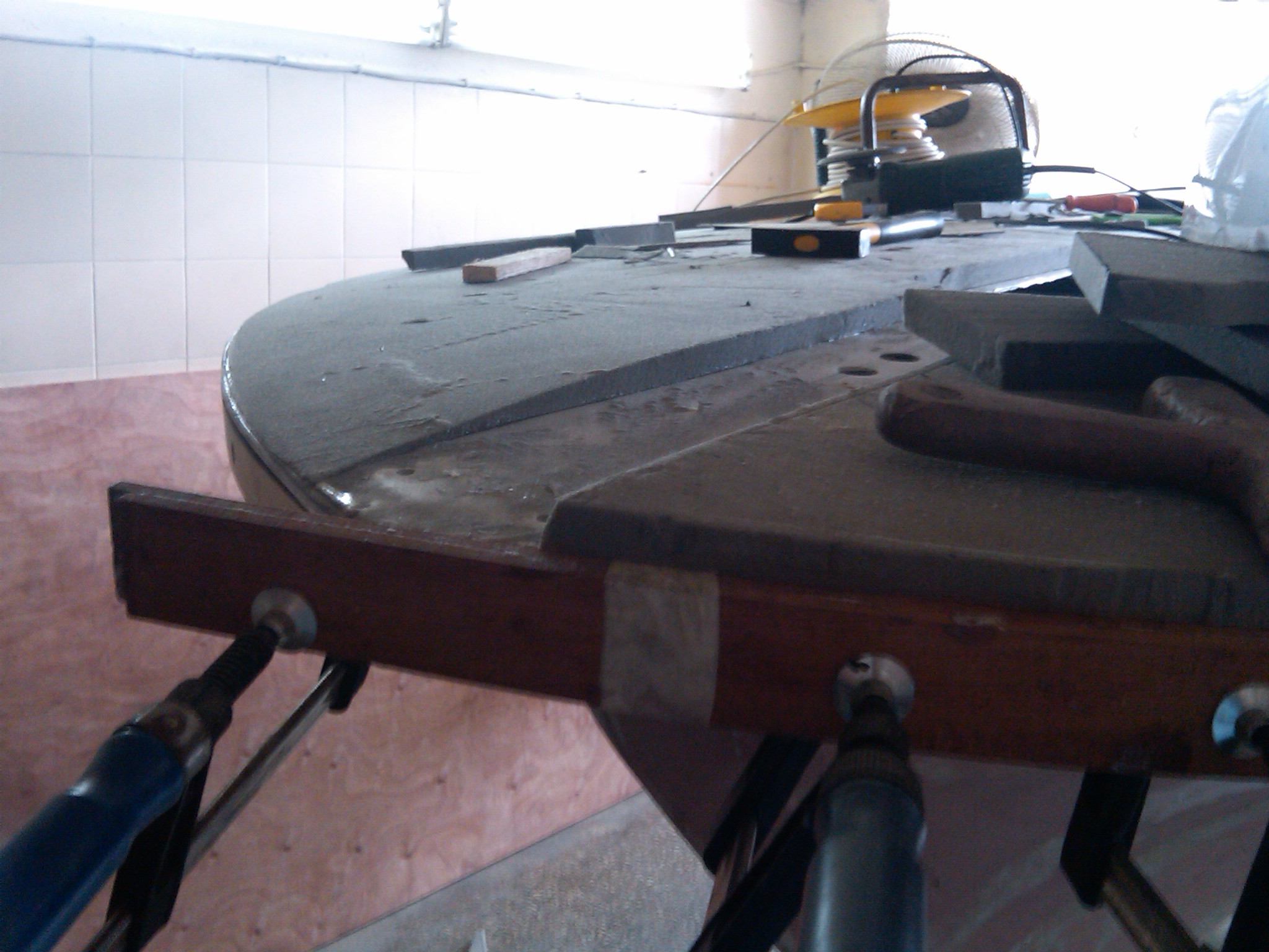

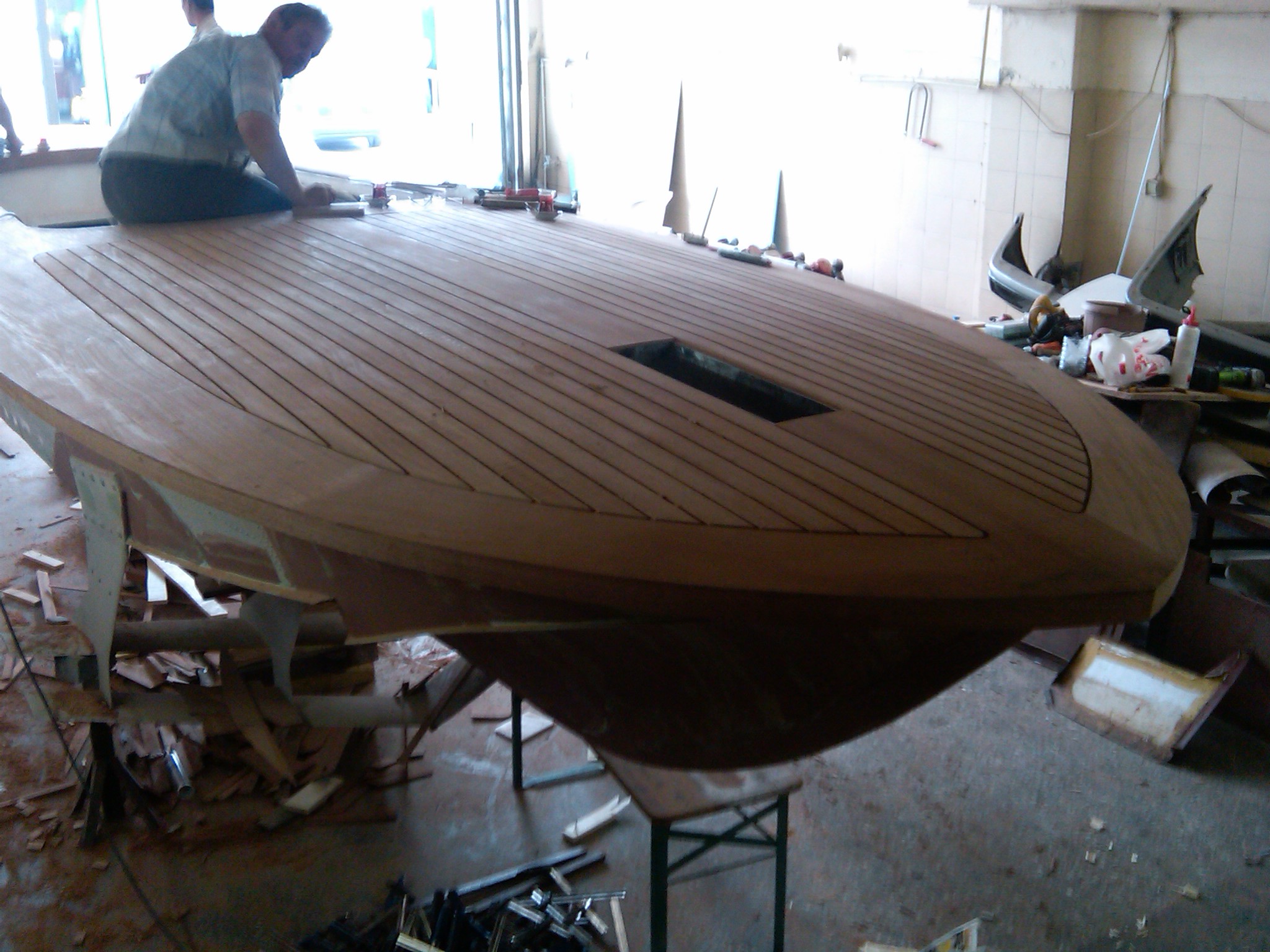

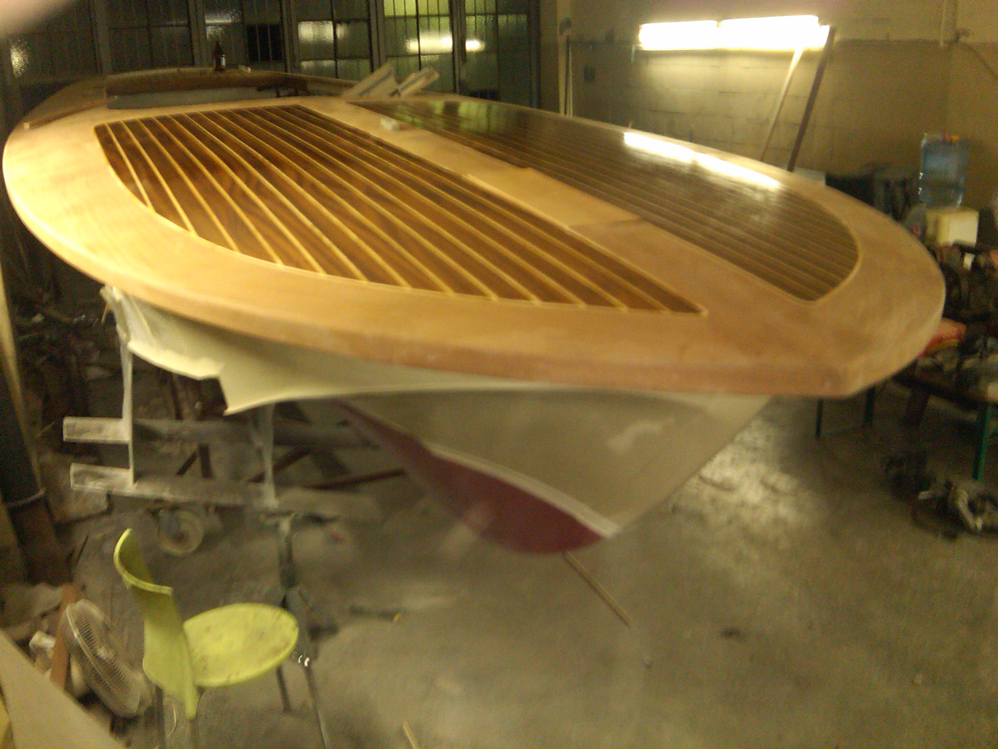

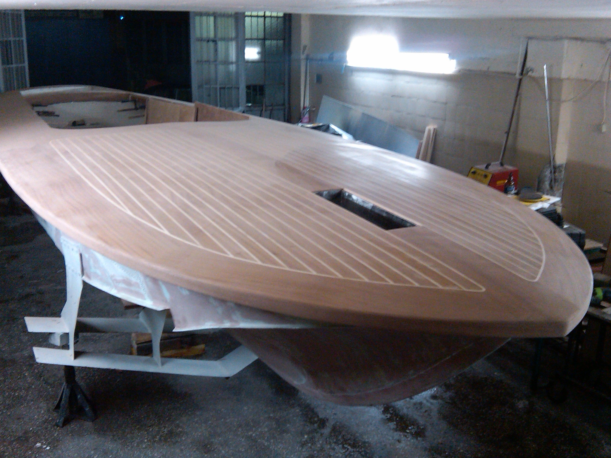

We then inserted white wood between the mahagony.
White wood between at the bow
White wood at stern glued-in

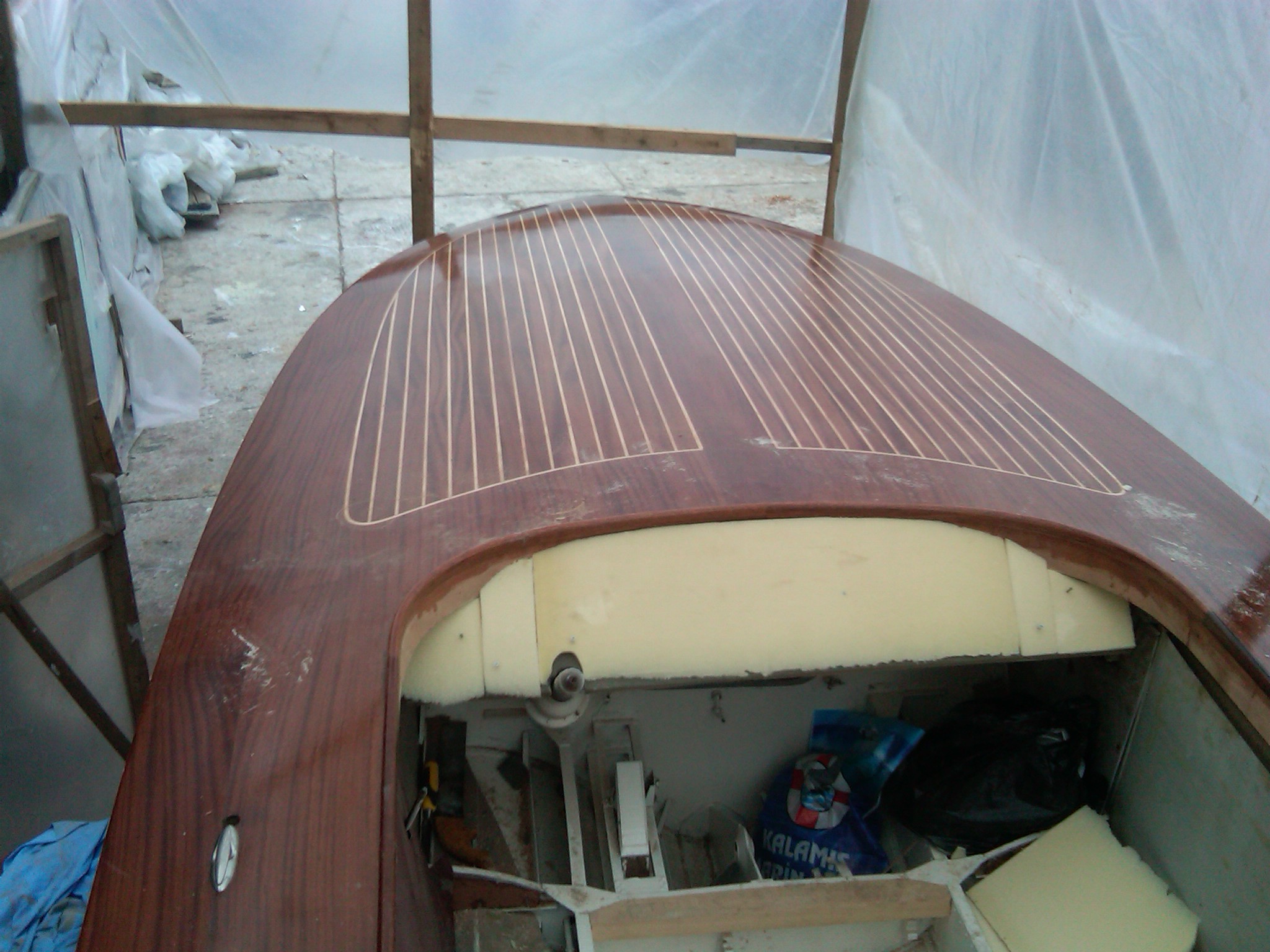

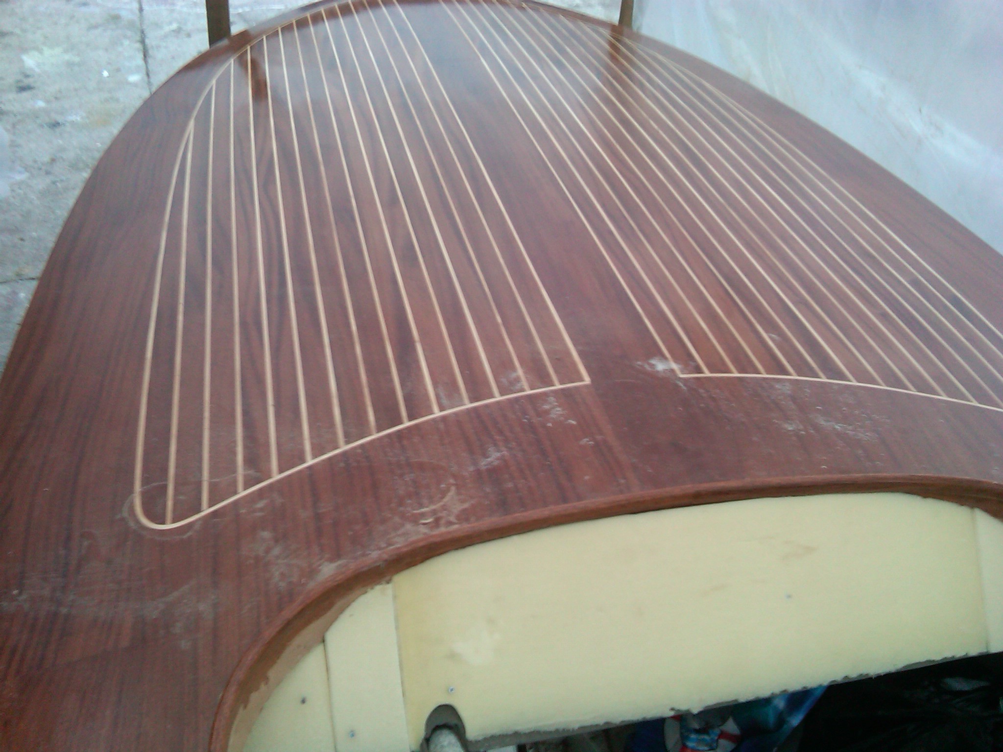

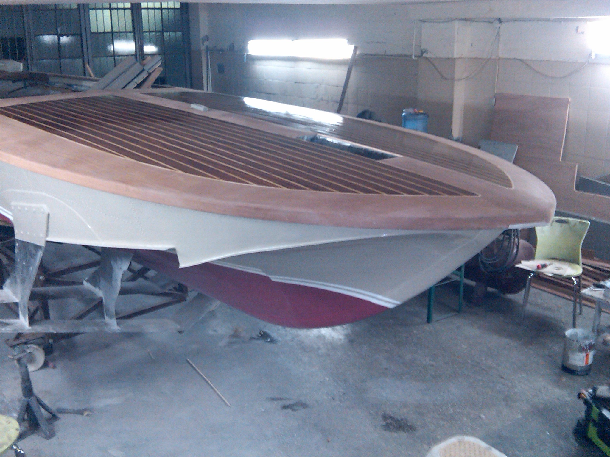

After sanding the front this is what revealed itself:
Bow wood sanded.
Bow wood sanded.
Stern sanded
Stern sanded

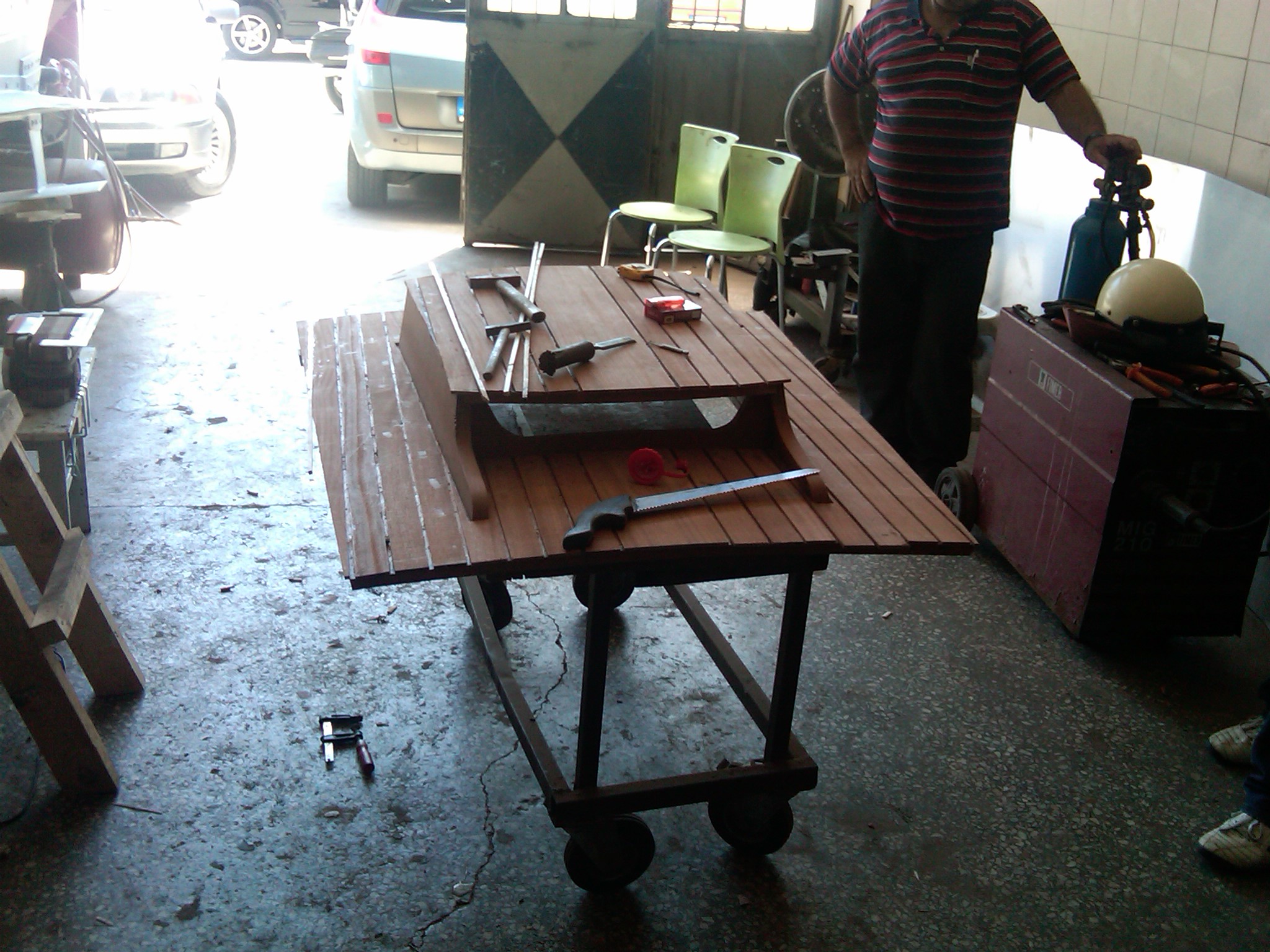

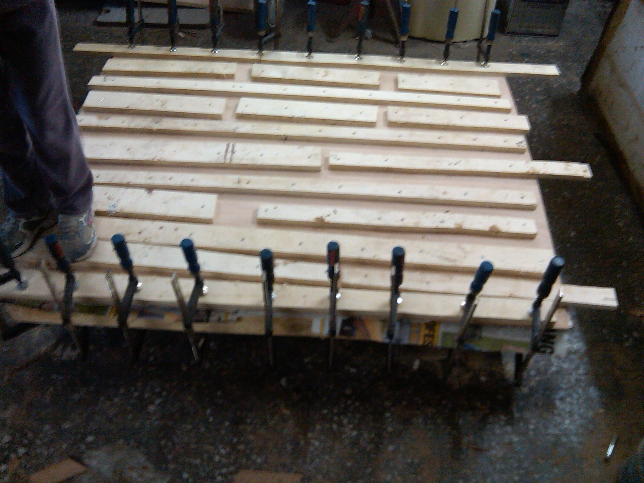

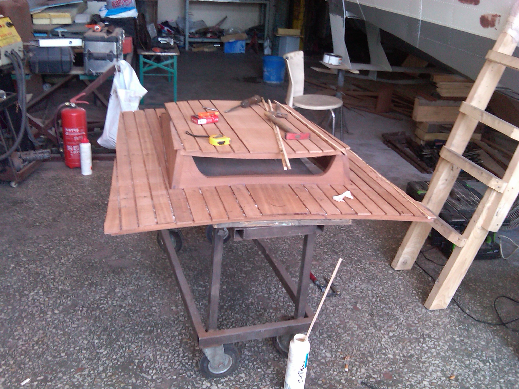

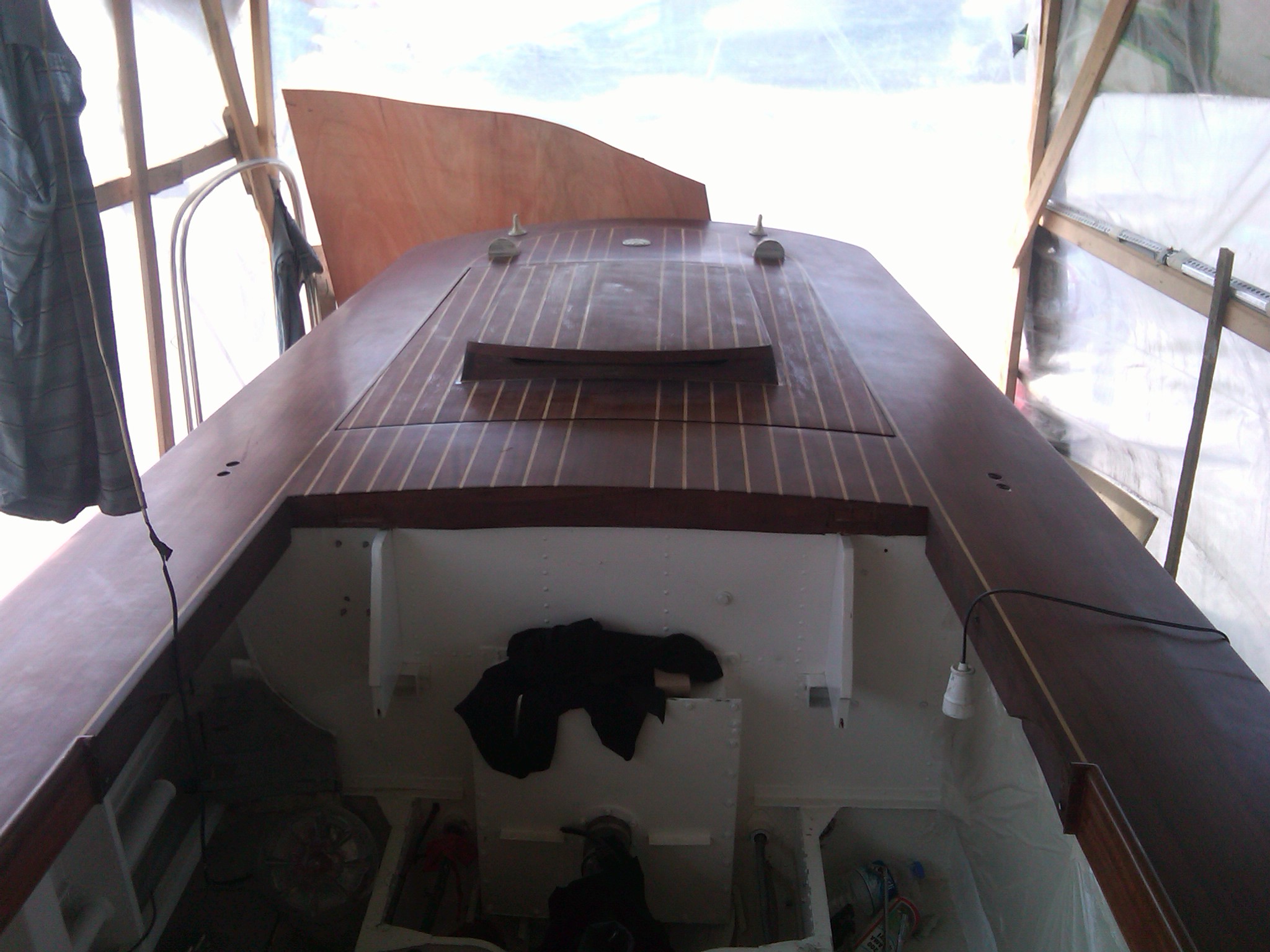

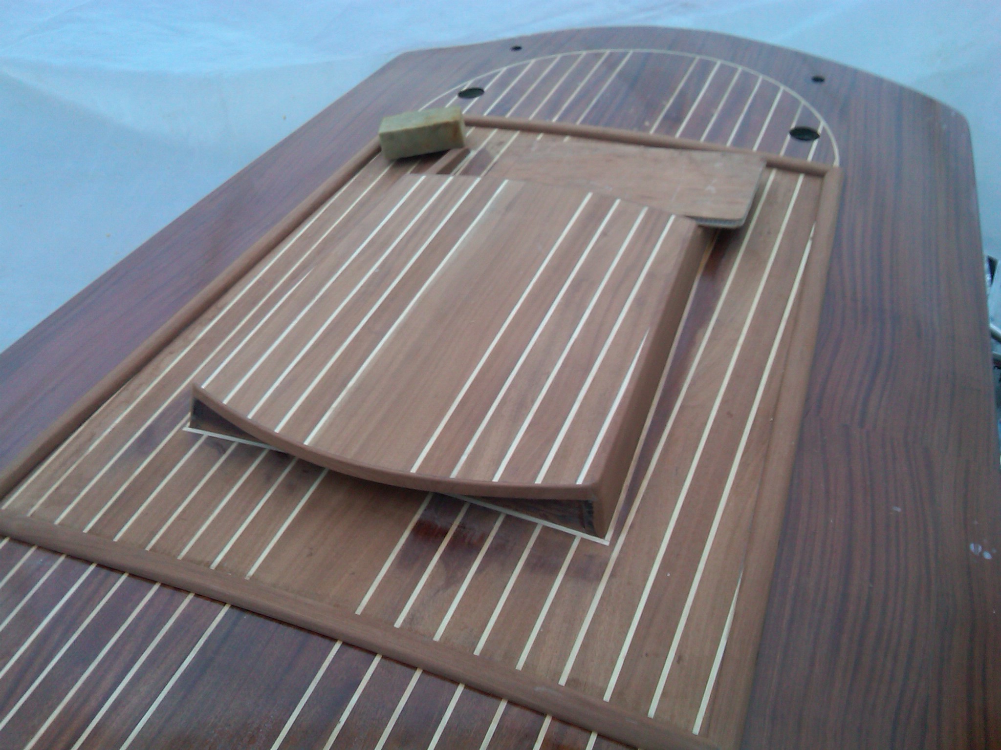

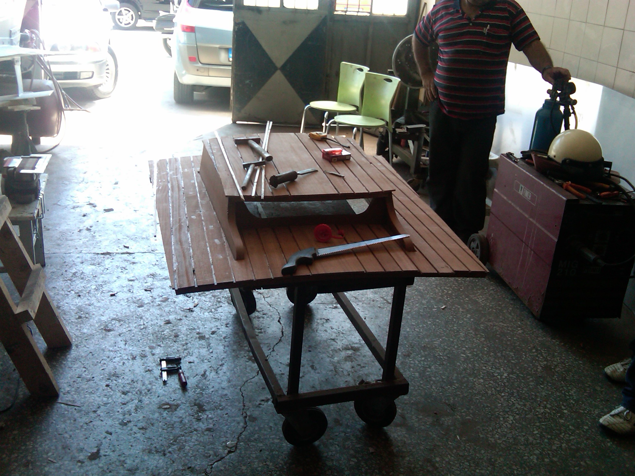

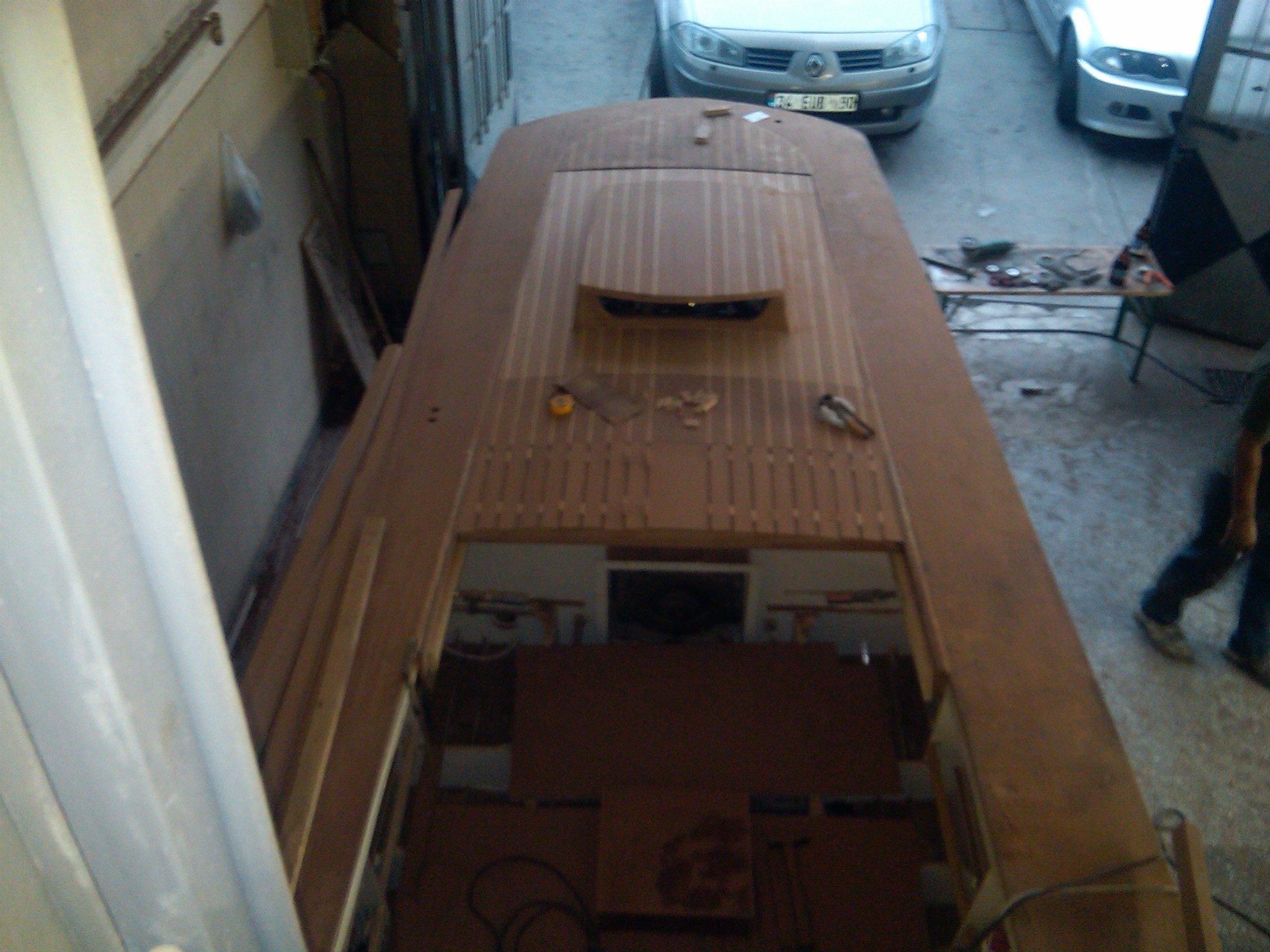

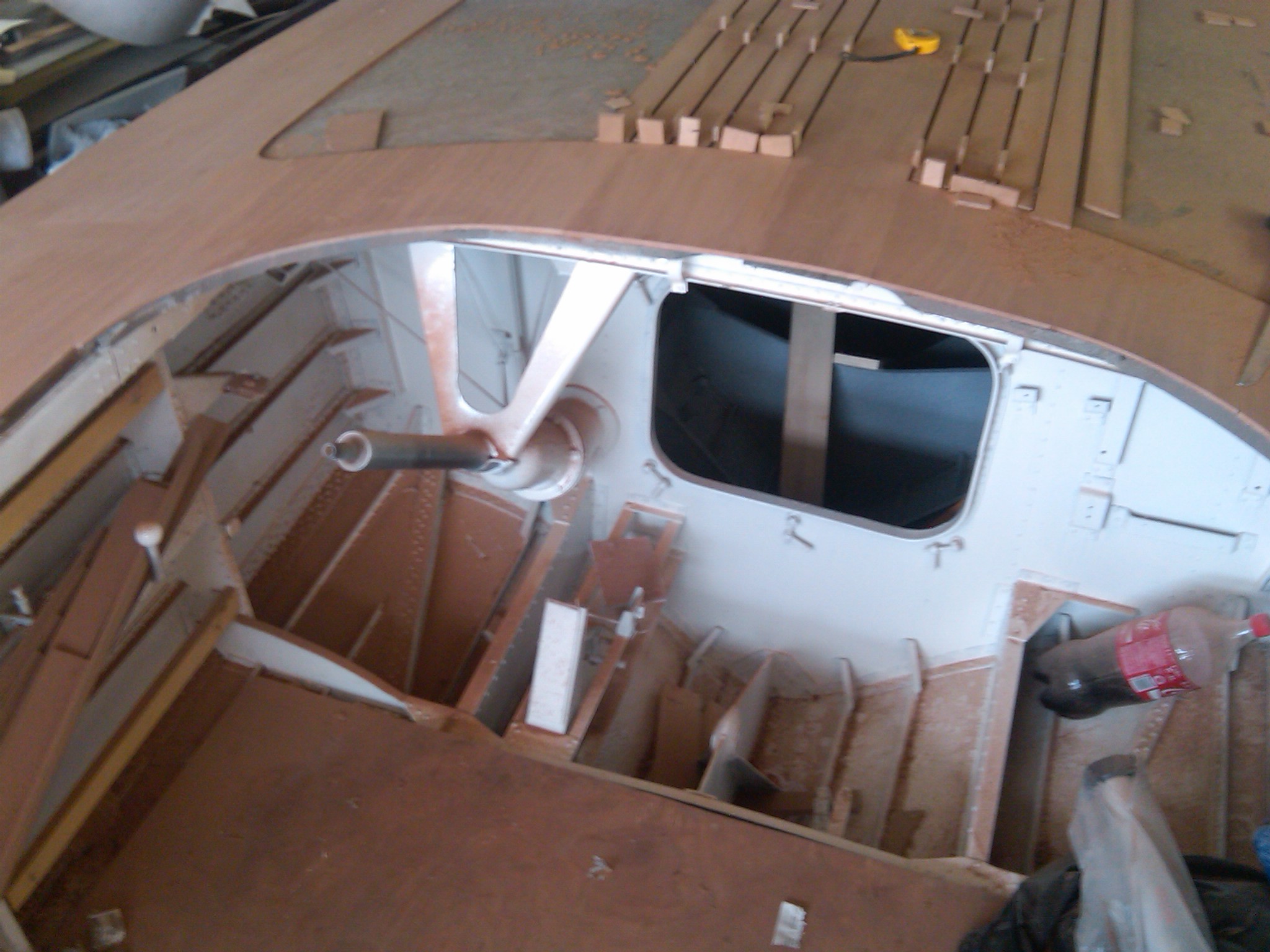

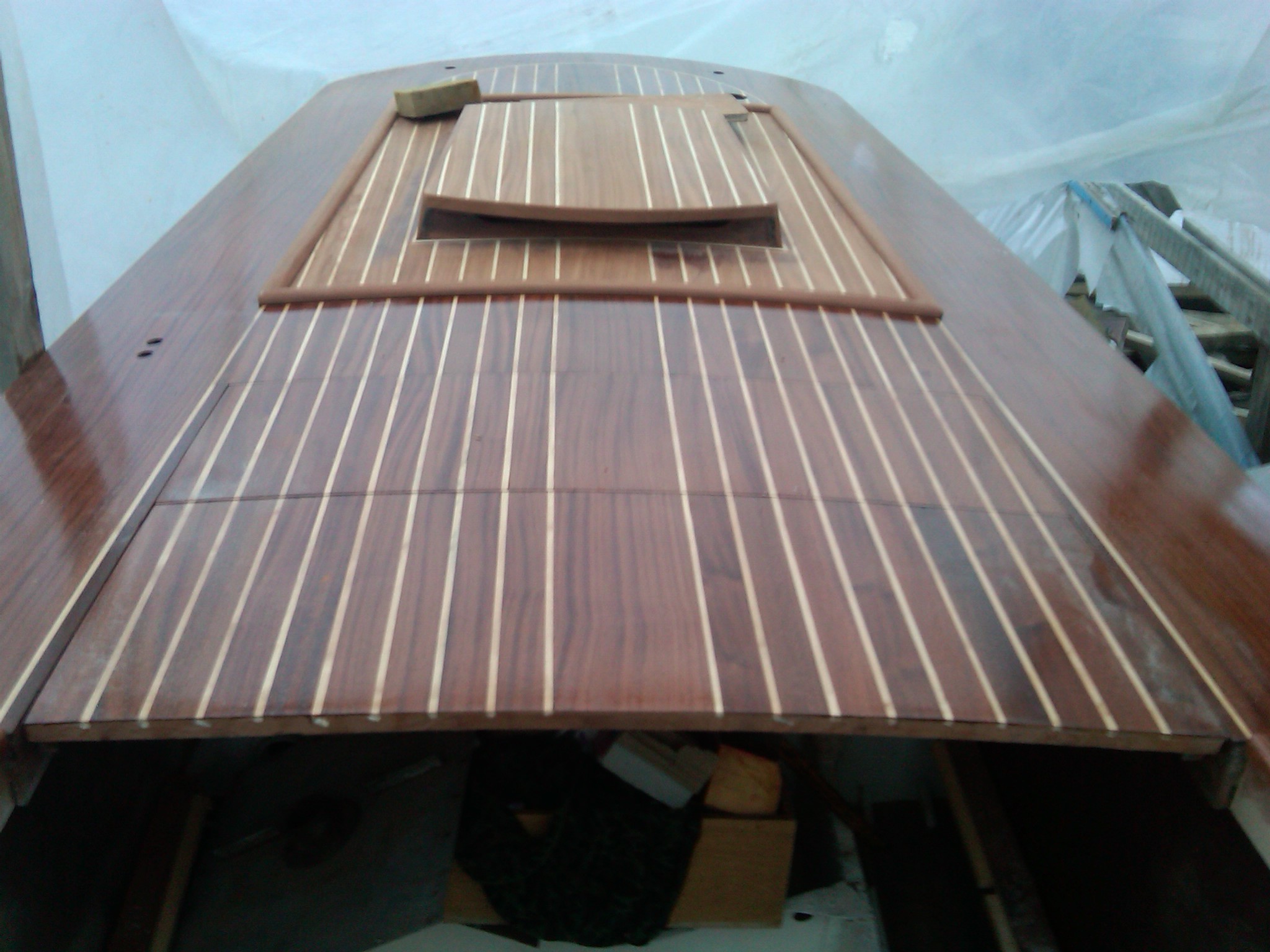

Lamination of the engine room hatch
Lamination of the engine room hood
Fitting of it
fitted without wood yet

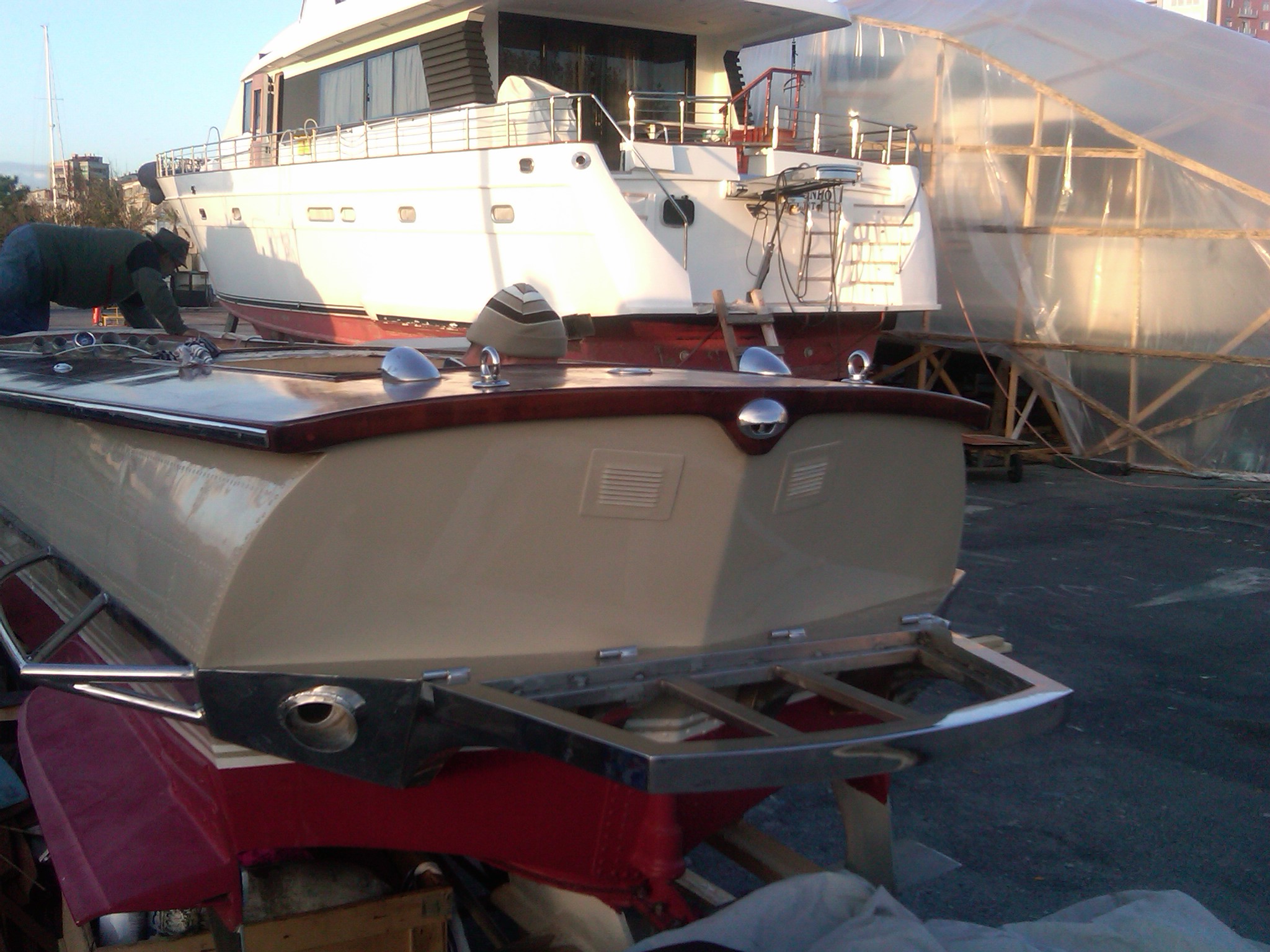

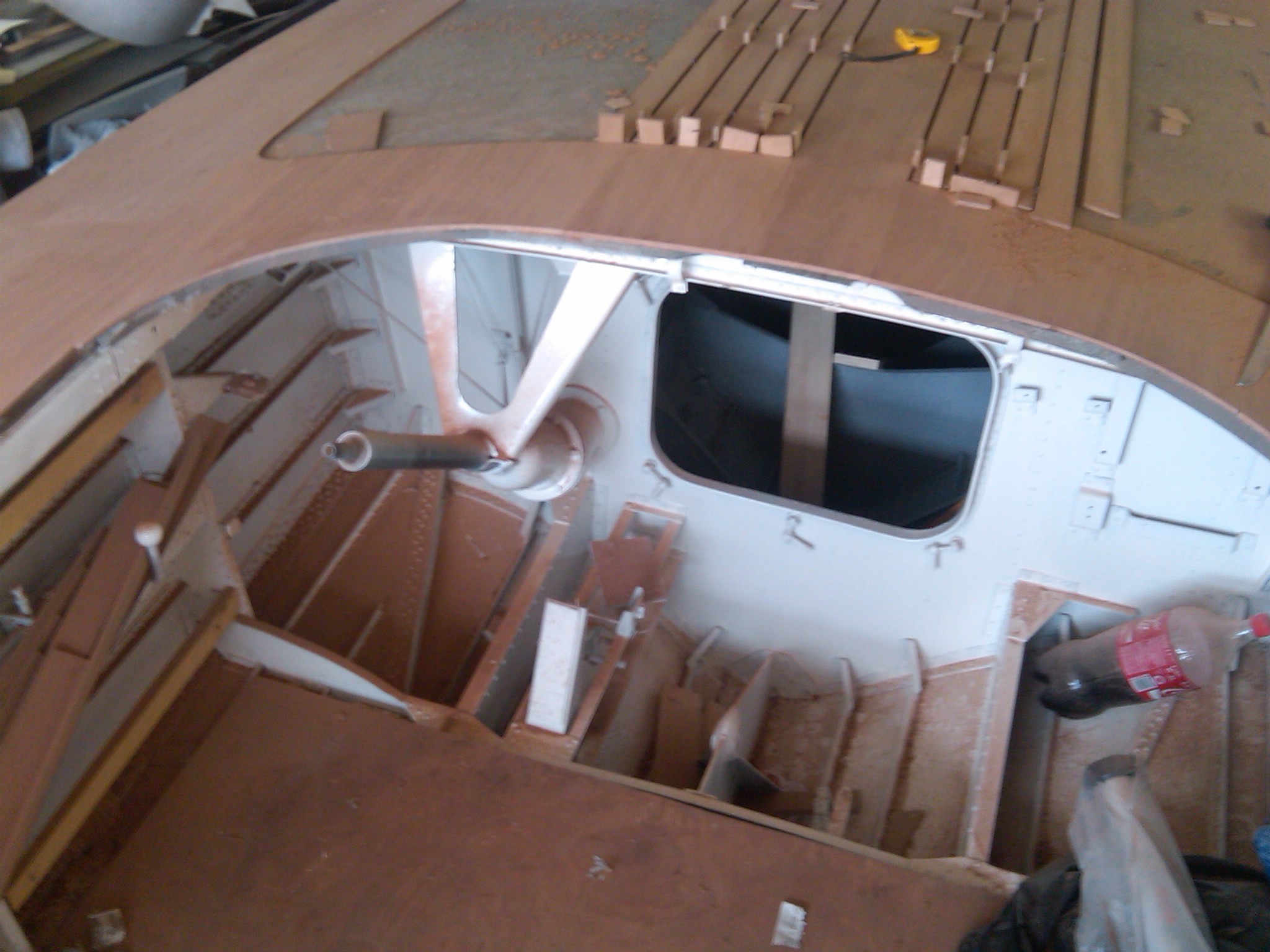

Although we have shortened some components on the engine like filter and decreased height of water tank, we had to make a cut-out for the engine.
Cut out for engine. For proper breathing of the engine room and engine we had to do it anyway.
To make a nicely shaped breathing hood will again be a challenge.

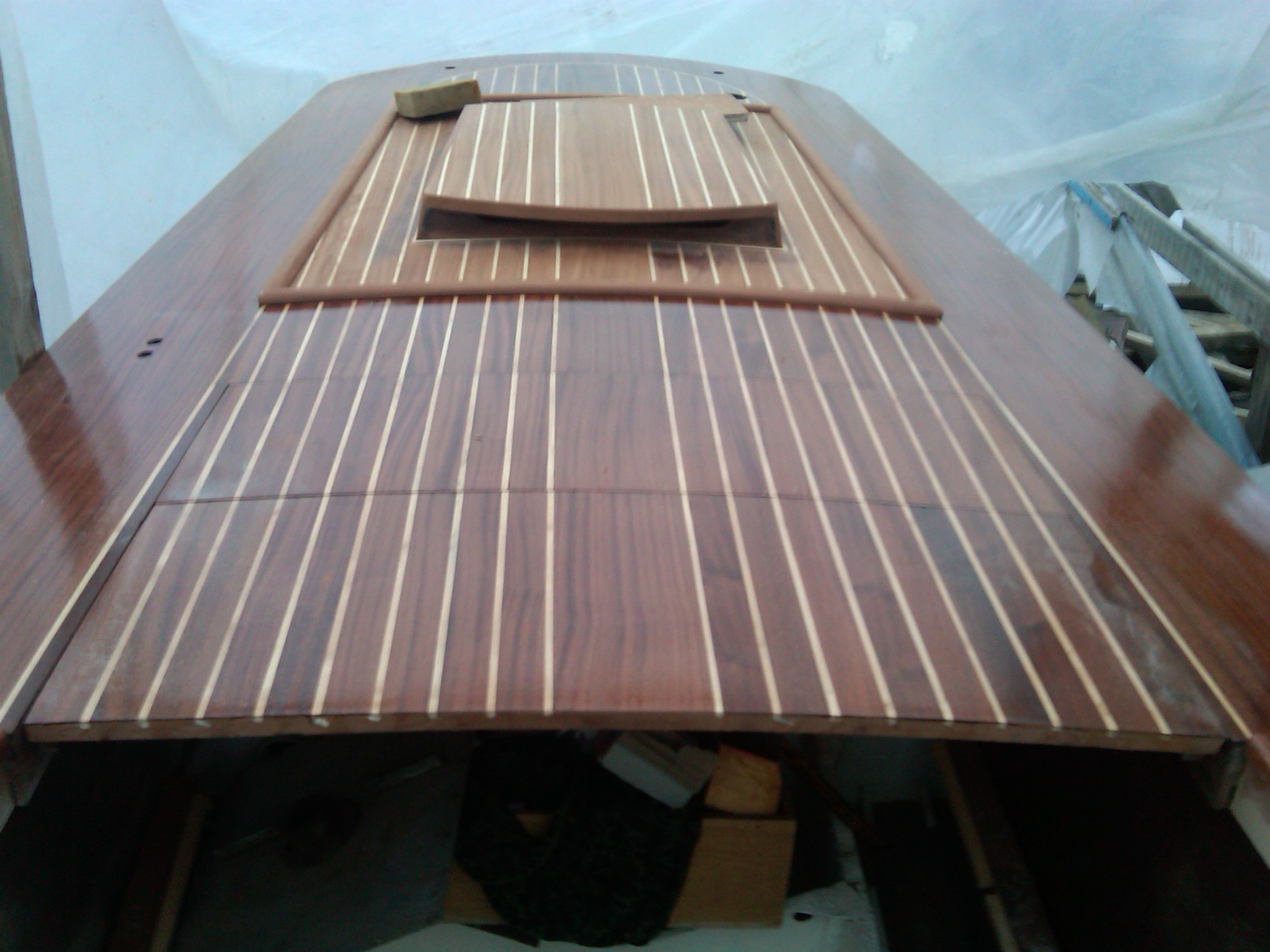

Re: Rounded top wooden deck

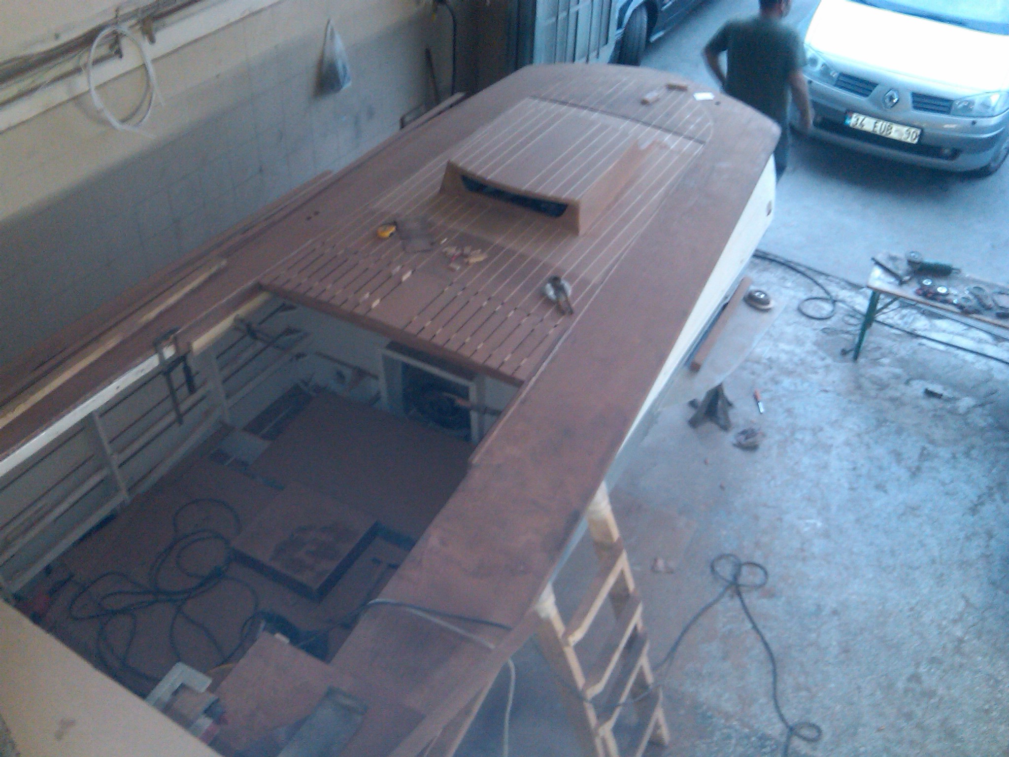

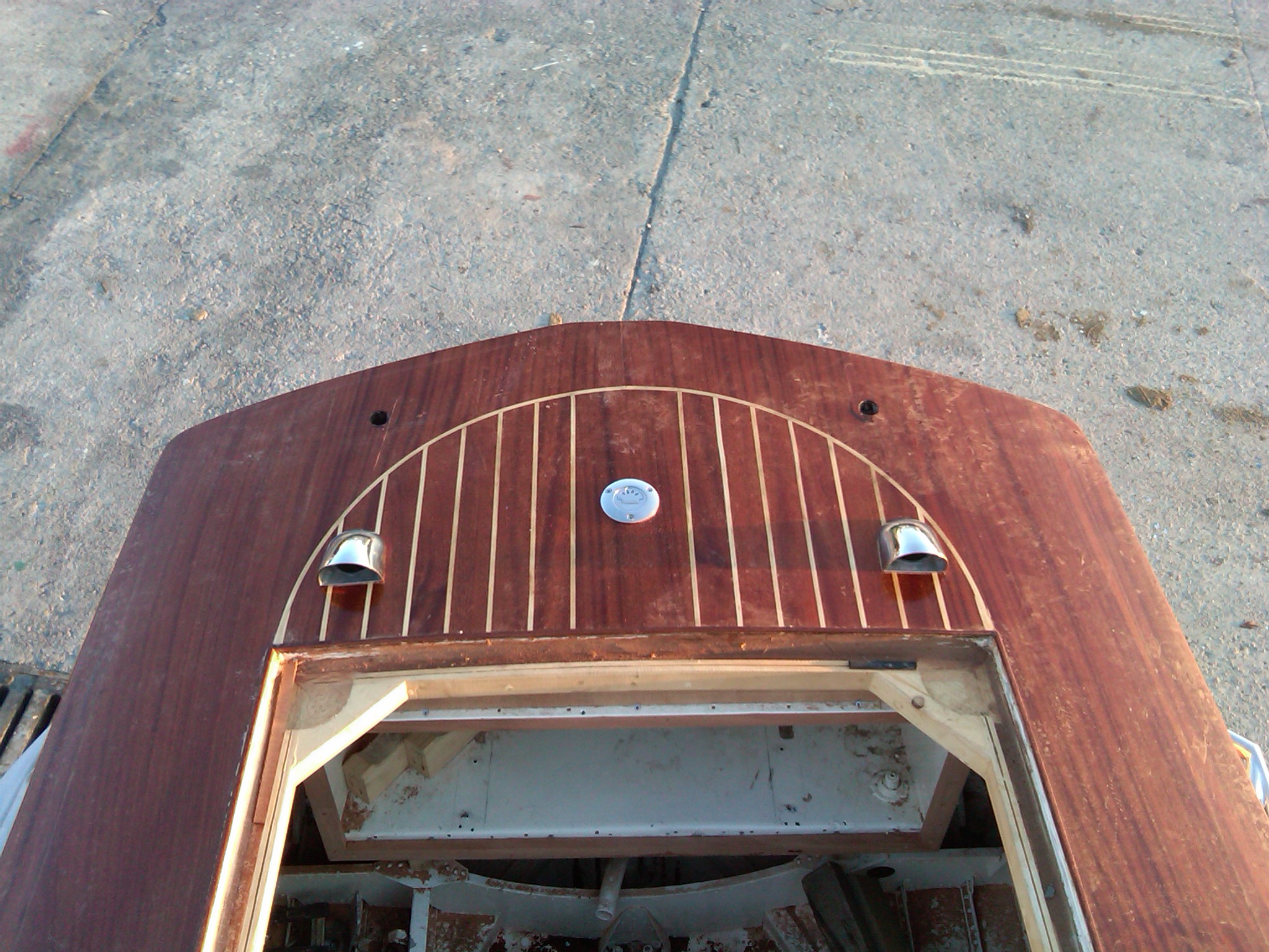

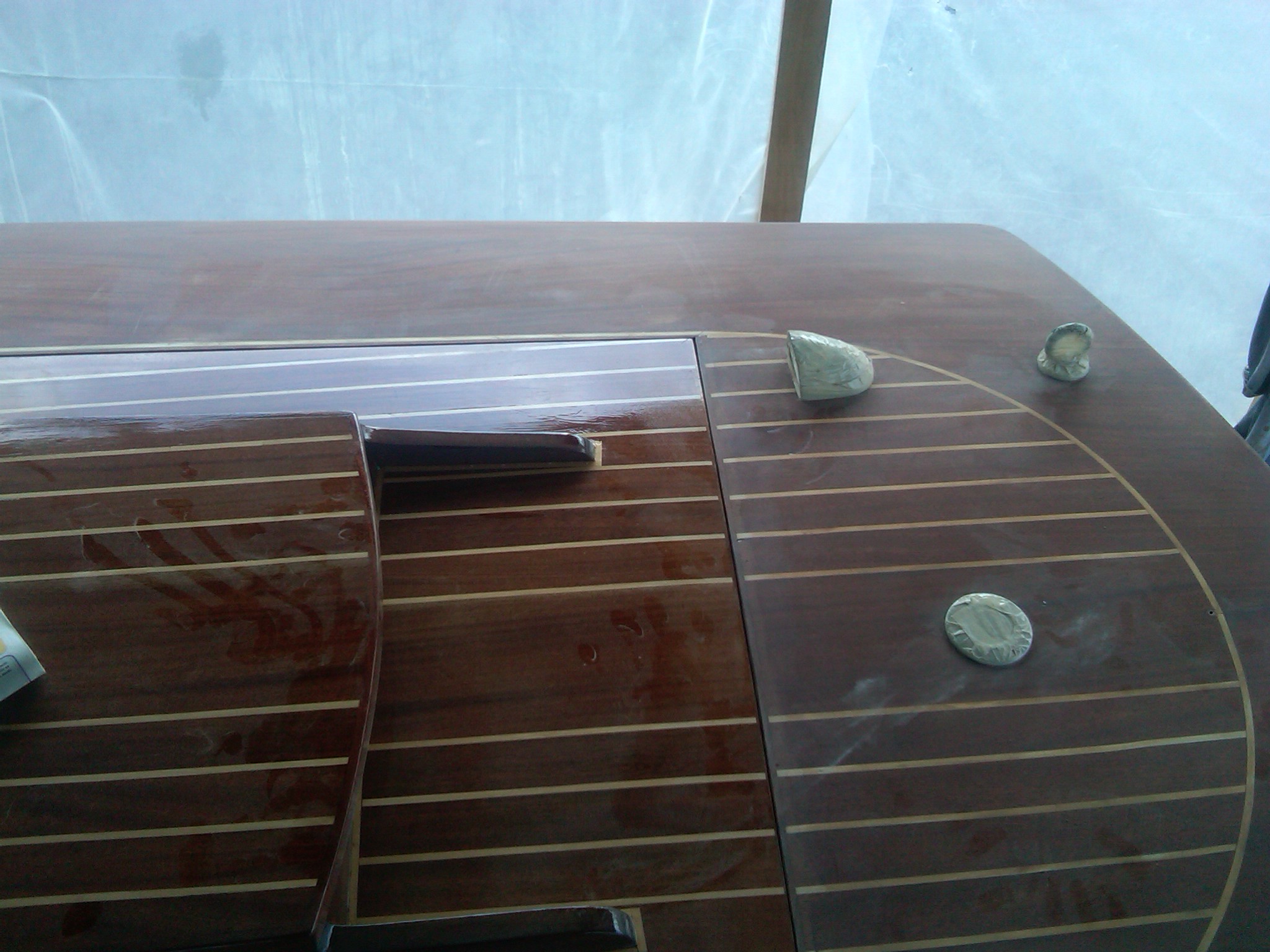

The piece cut out of the hood was then used as roof for the air inlet.
Hood was wooded with the same pattern like the deck.
At the rear we made some prolongations.

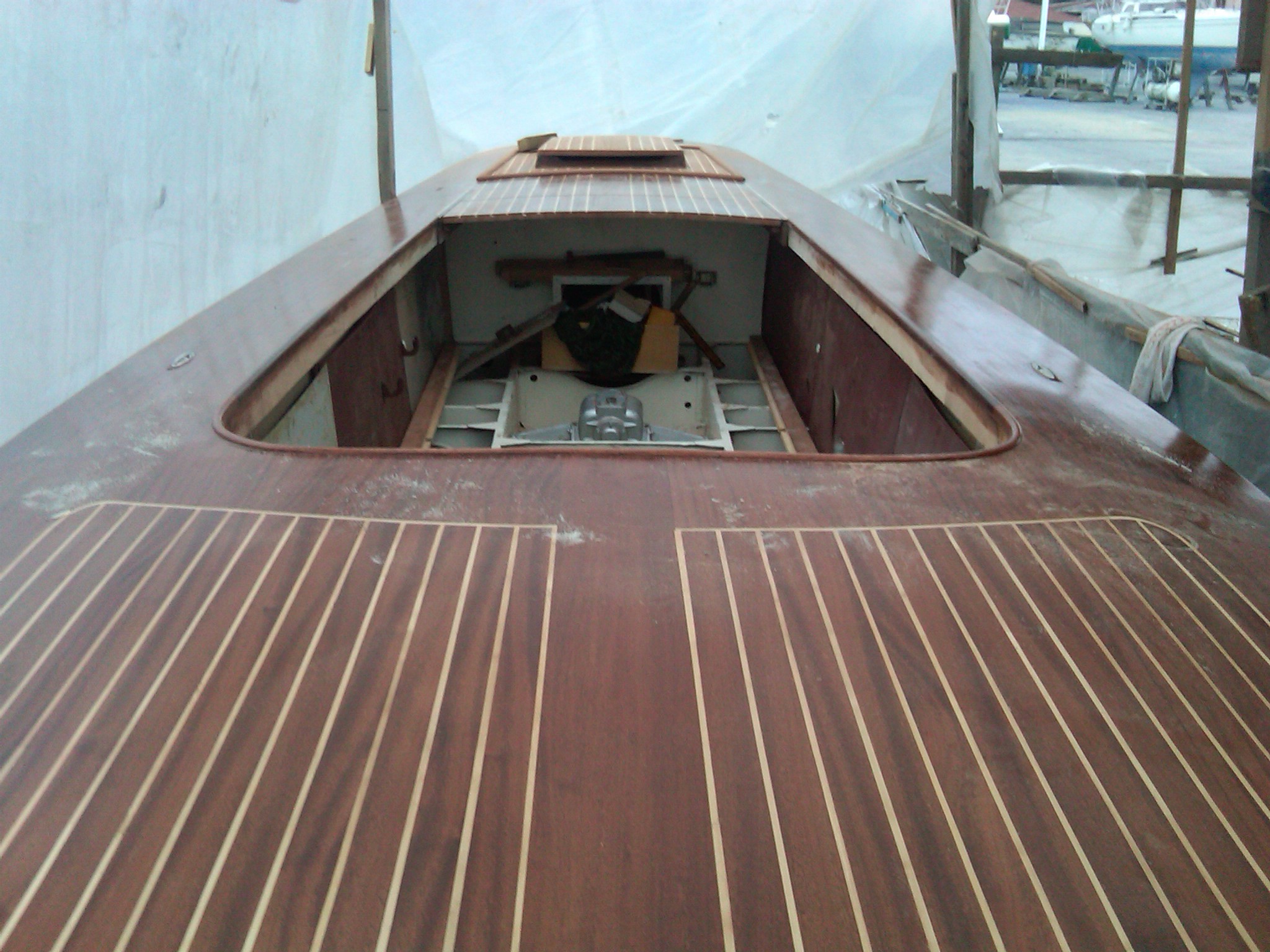

The hooded hood placed on the engine room.
Another view of the hooded hood.

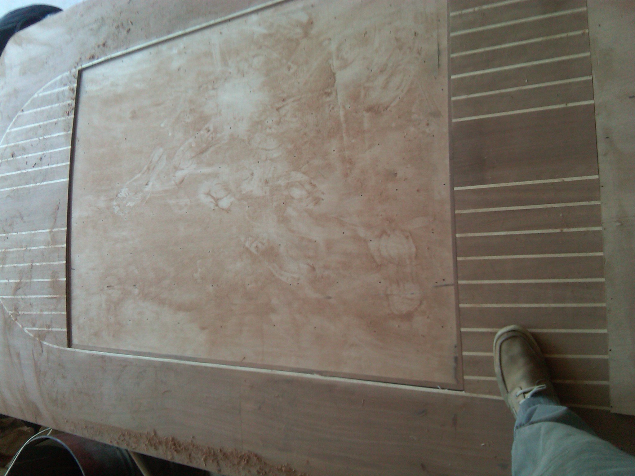

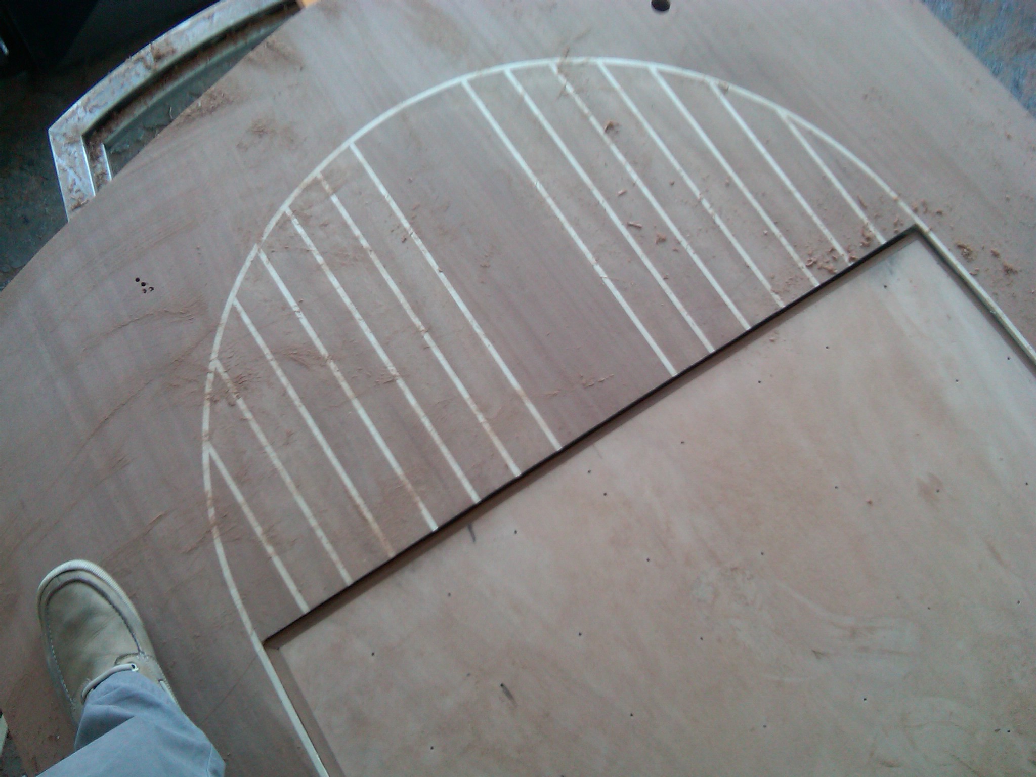

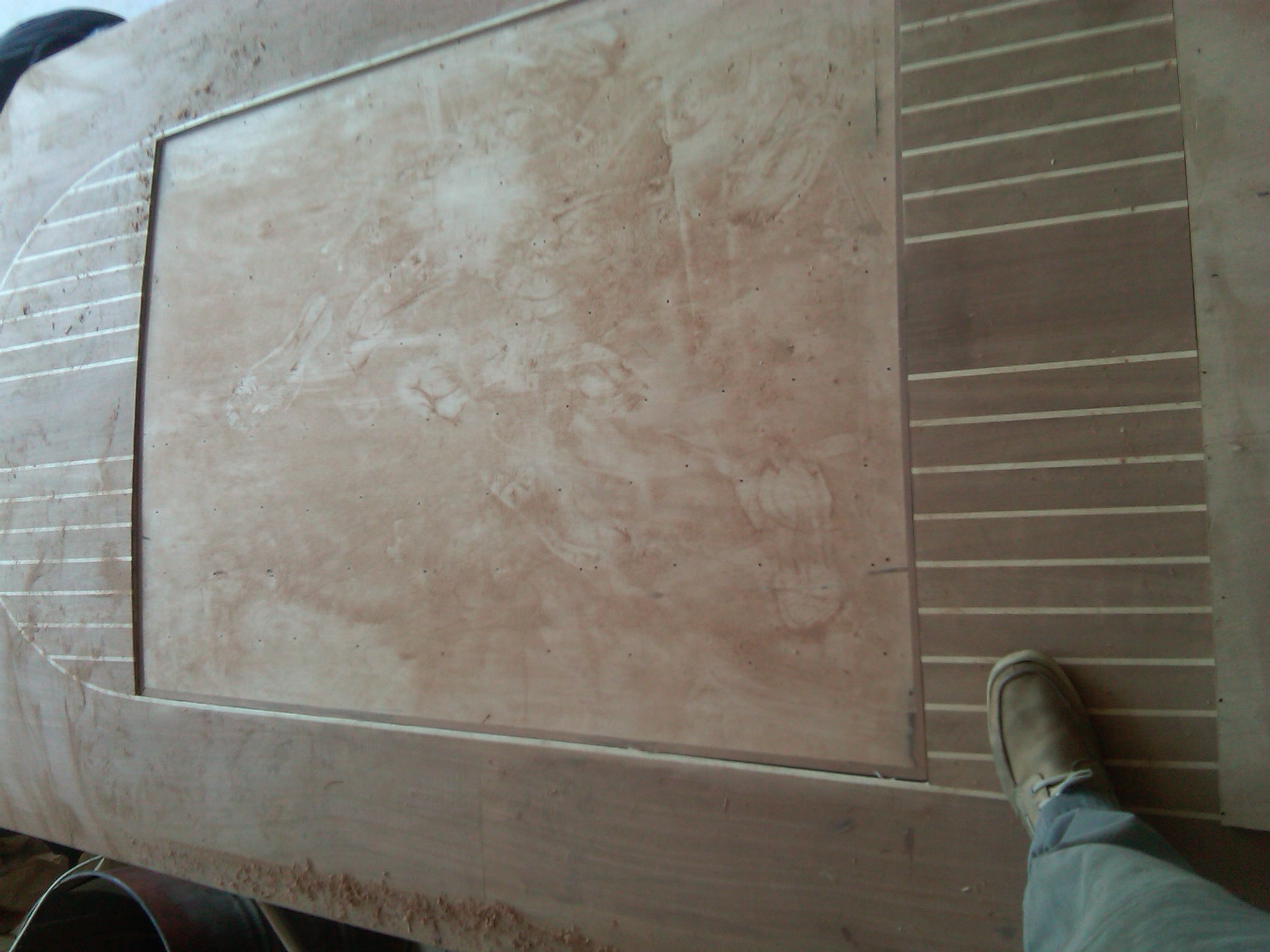

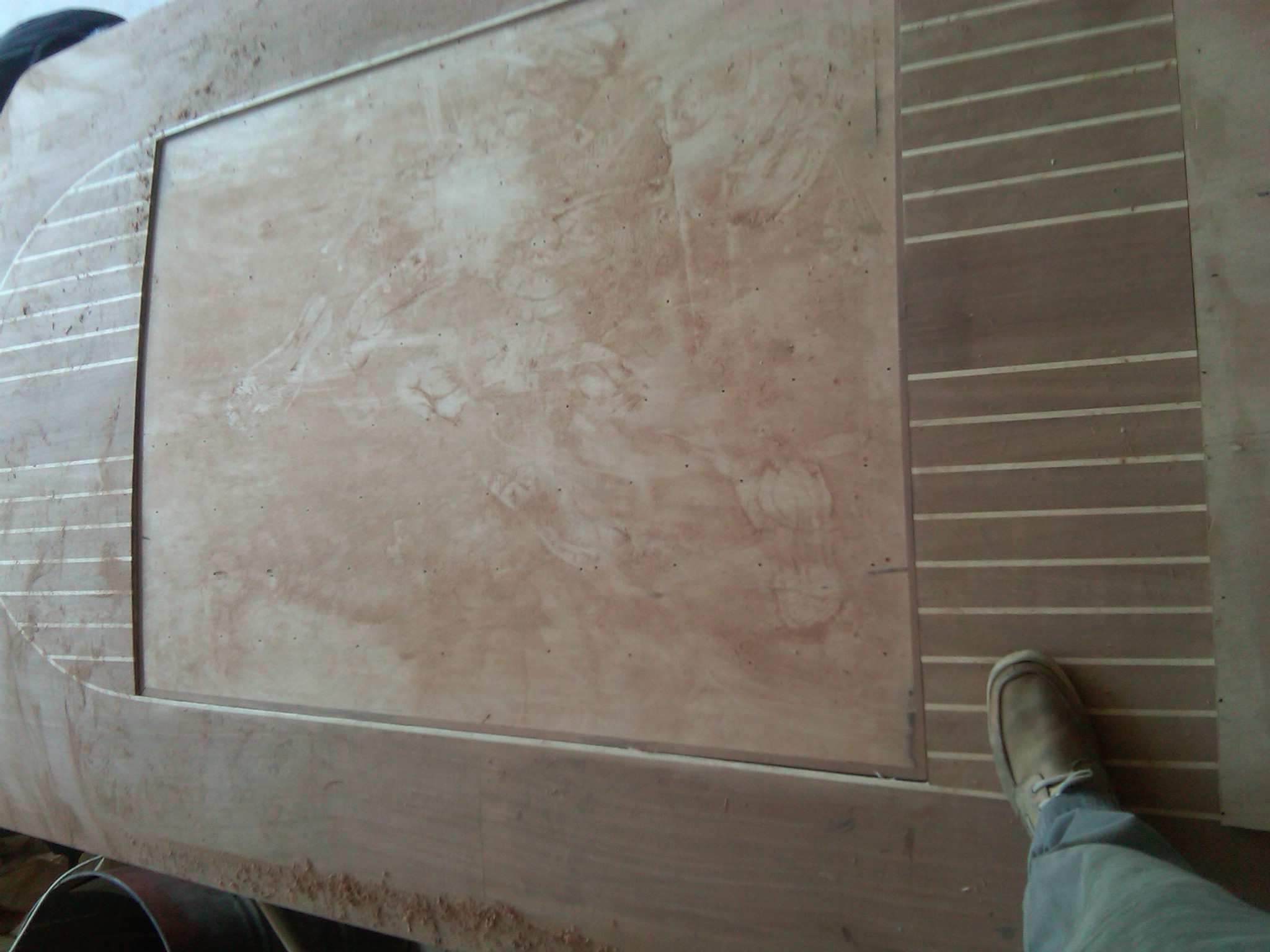

The floor plates of the pool are framed by 5 cm. ... Scrap! It will be redone... with 1,5 cm frames only.
I wonder how good a shish-kebab tastes when you use mahagony wood for it? Don't worry, we will use the wood elsewhere!
The design has a line and the floor plates were designed with a single line. The carpenter said, that the frame gives a longer life to the wood. TheNo compromises with self-inventions of stubbern carpenters. It will be changed!

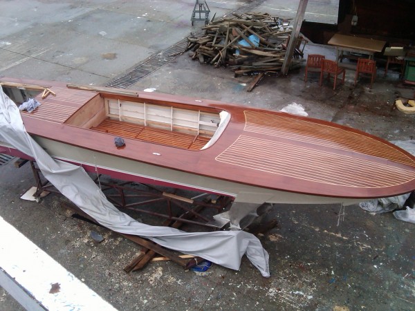

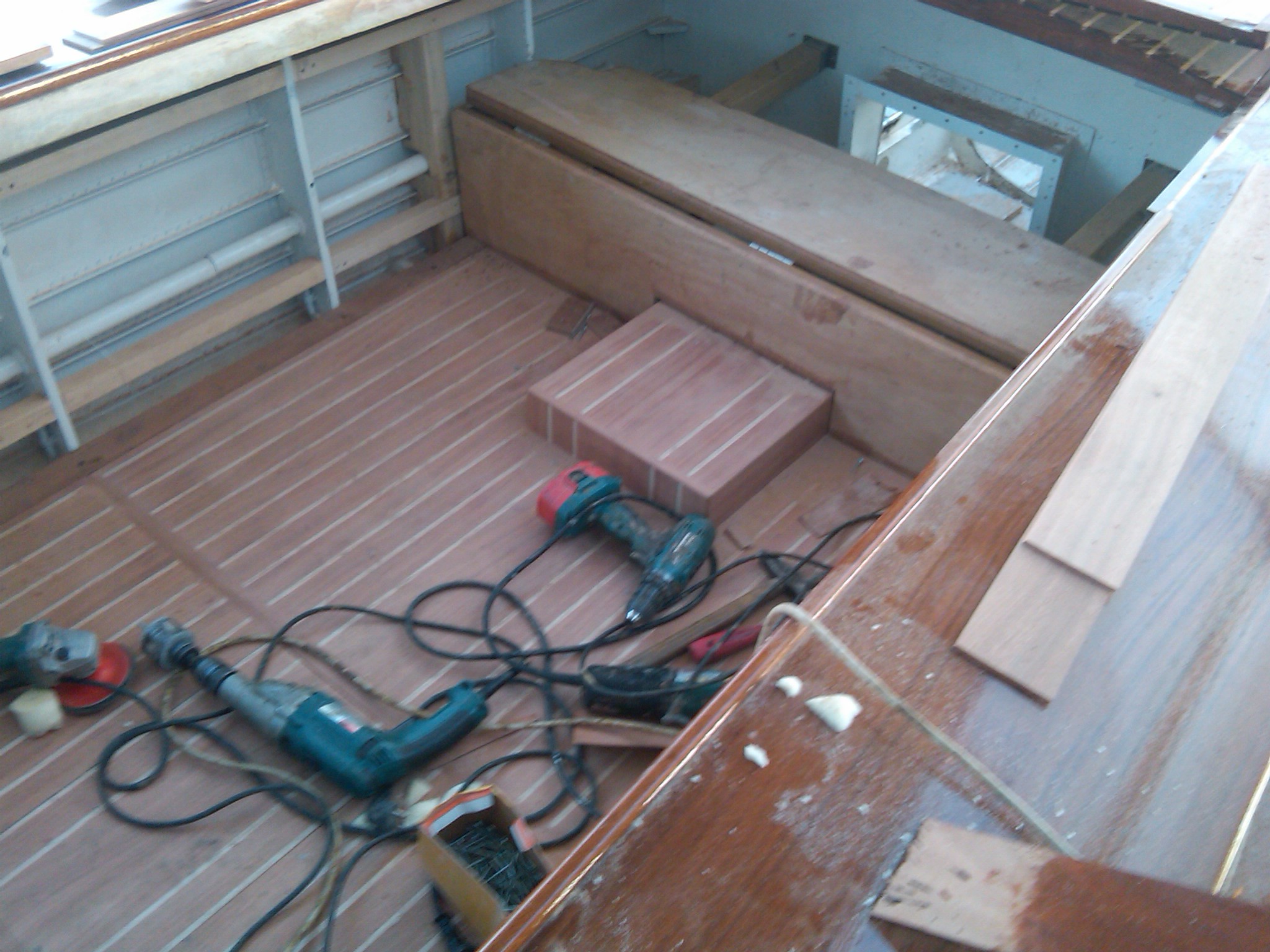

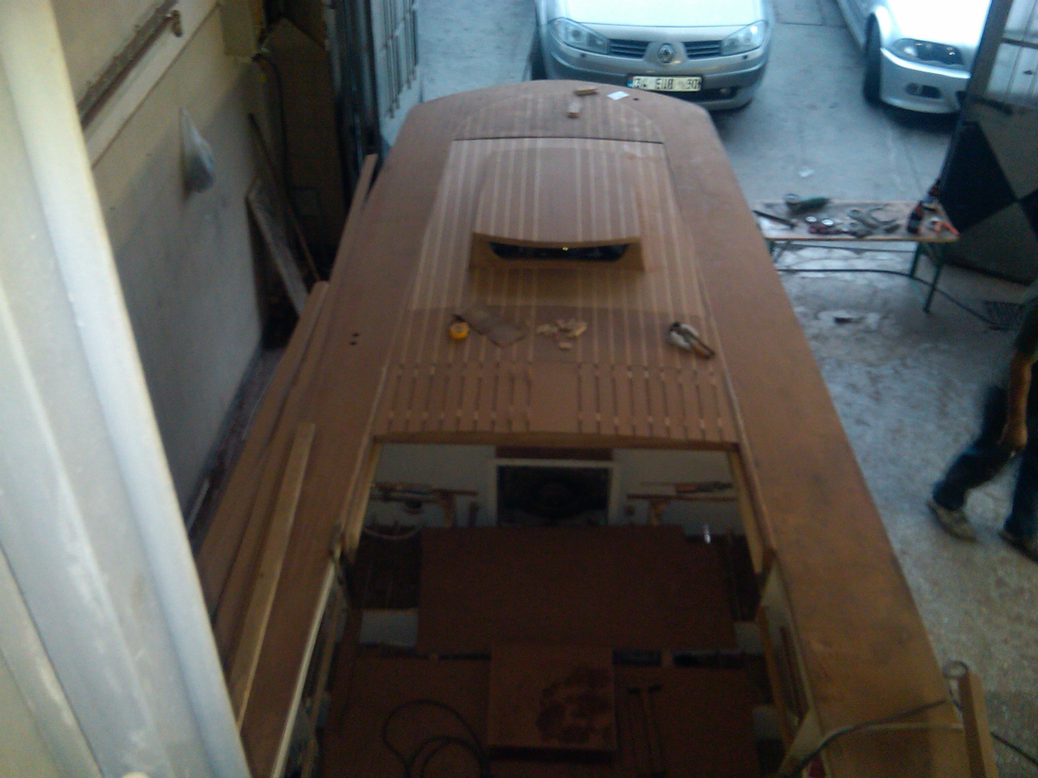

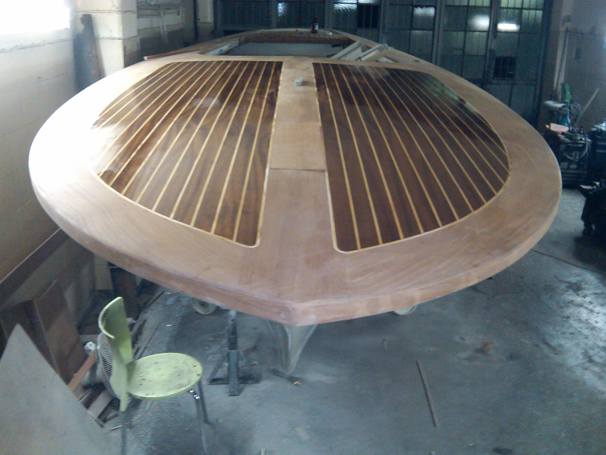

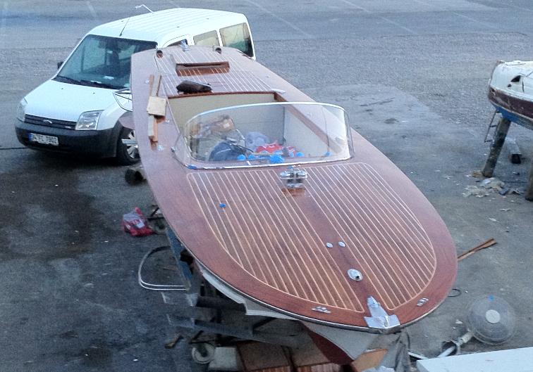

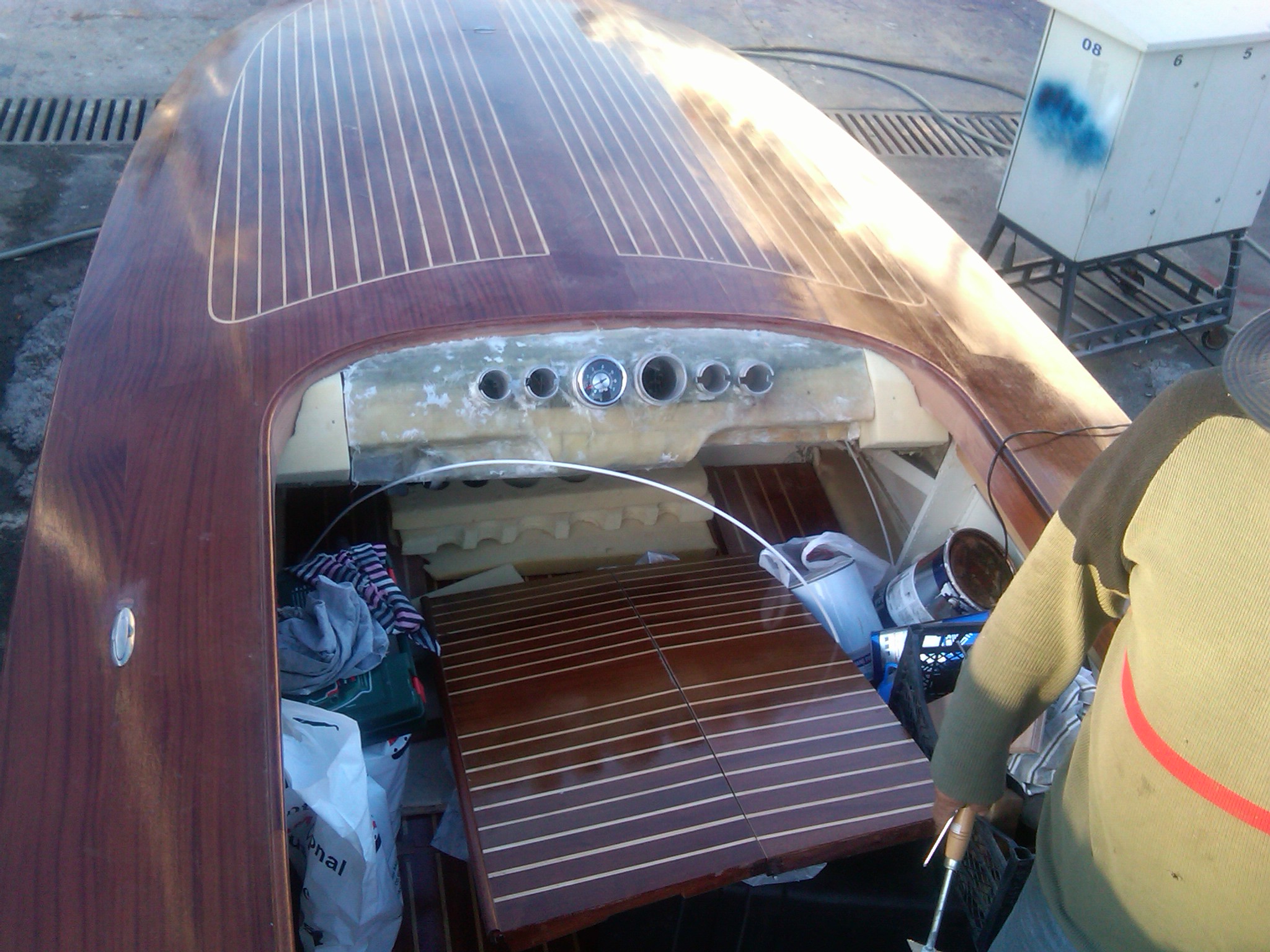

That is the current situation:
View from above with the box/bench and the plywood done.

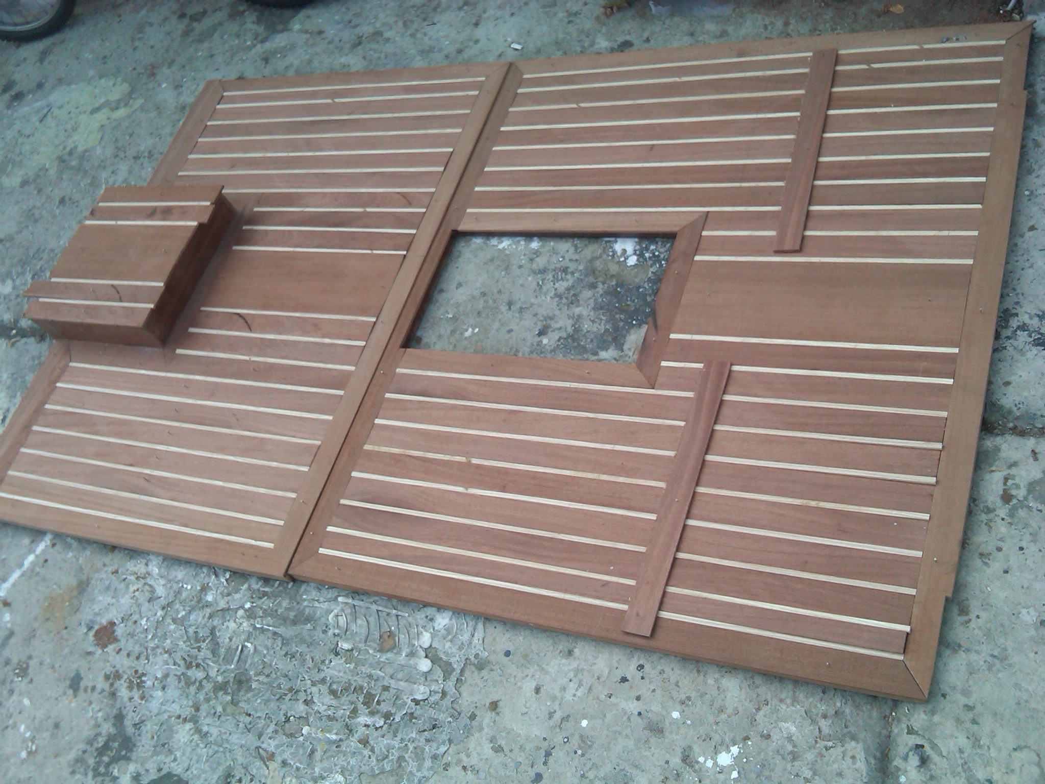

The woodwork of the floorplates of the pool was redone, with smaller frames.
Small frame version
Small frame version

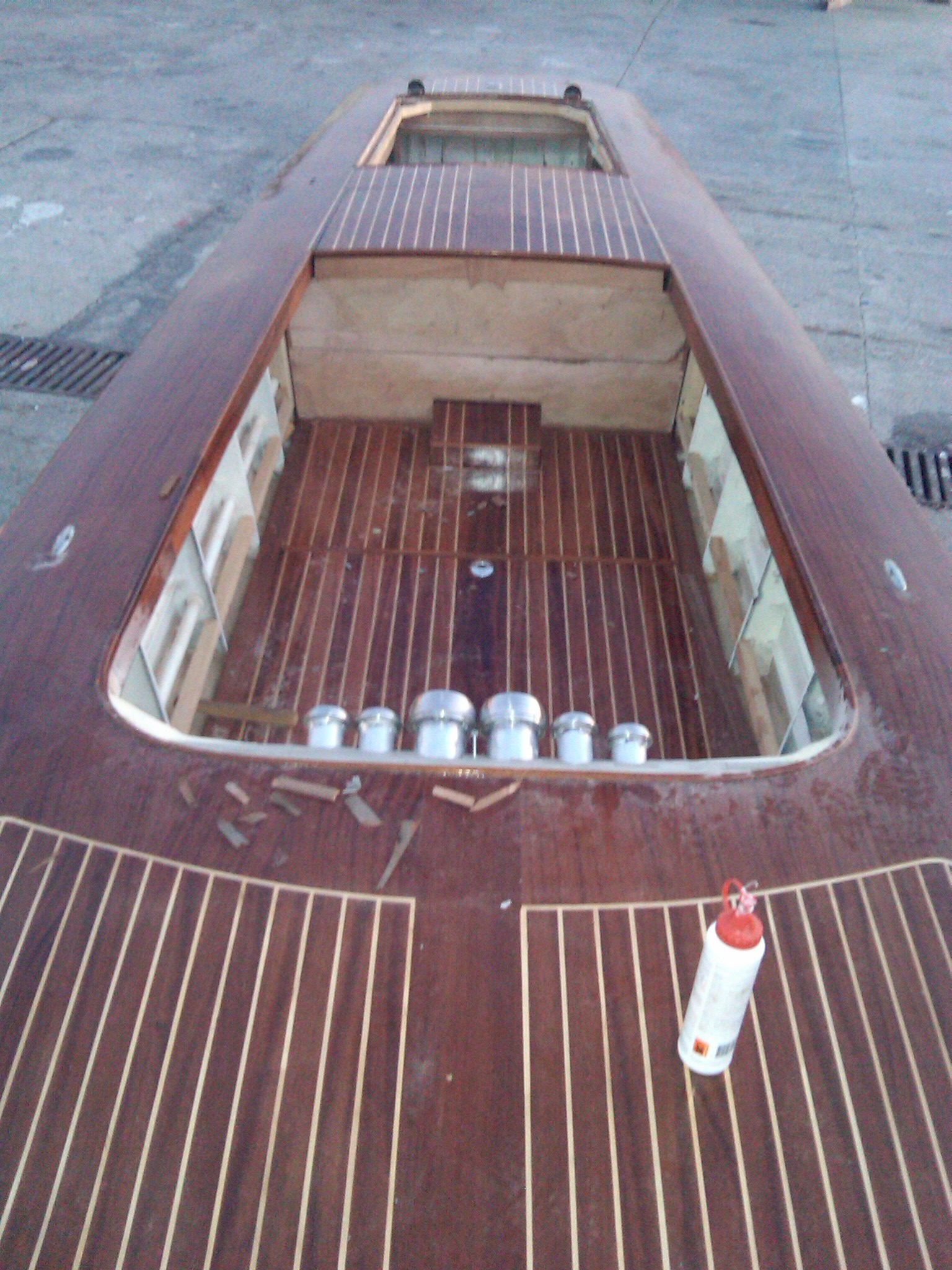

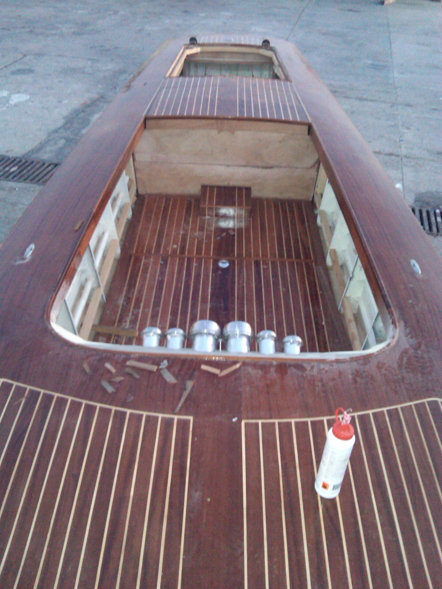

What you can see on the back is the box/bench partially retracted.

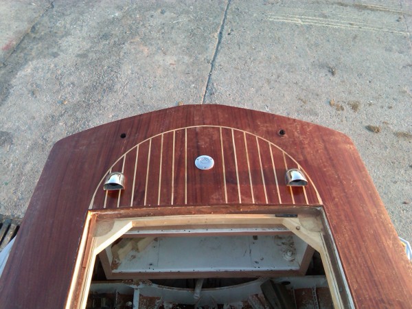

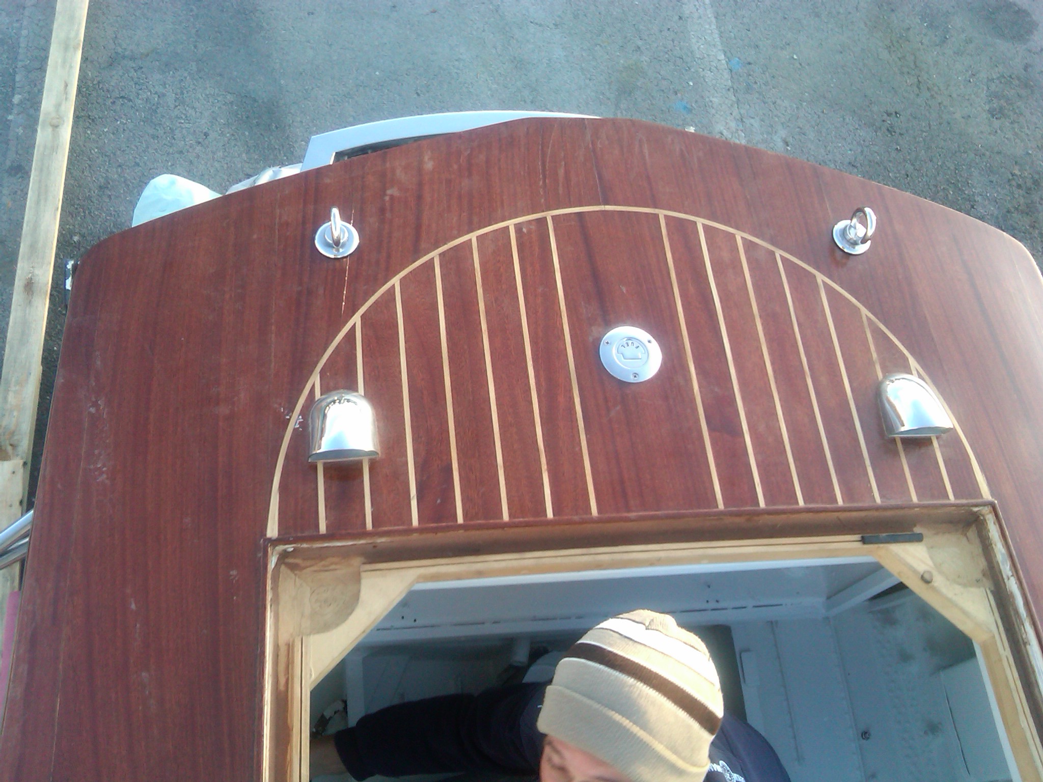

The fuel cap and the air inlets were installed as well.
Fuel cap and air-take-ins installed

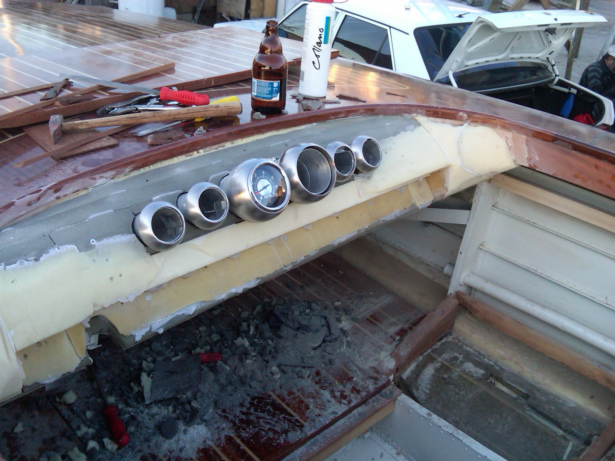

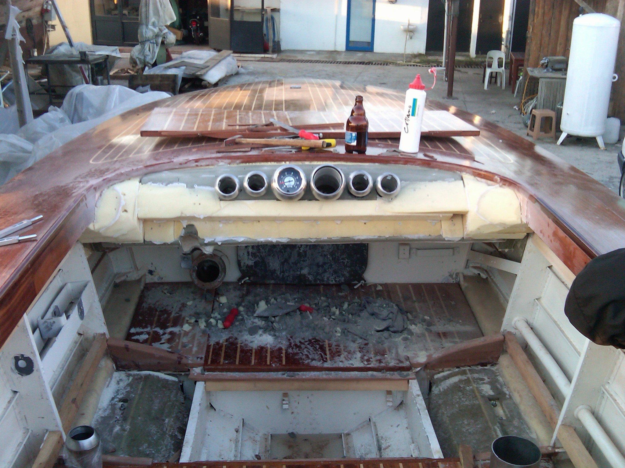

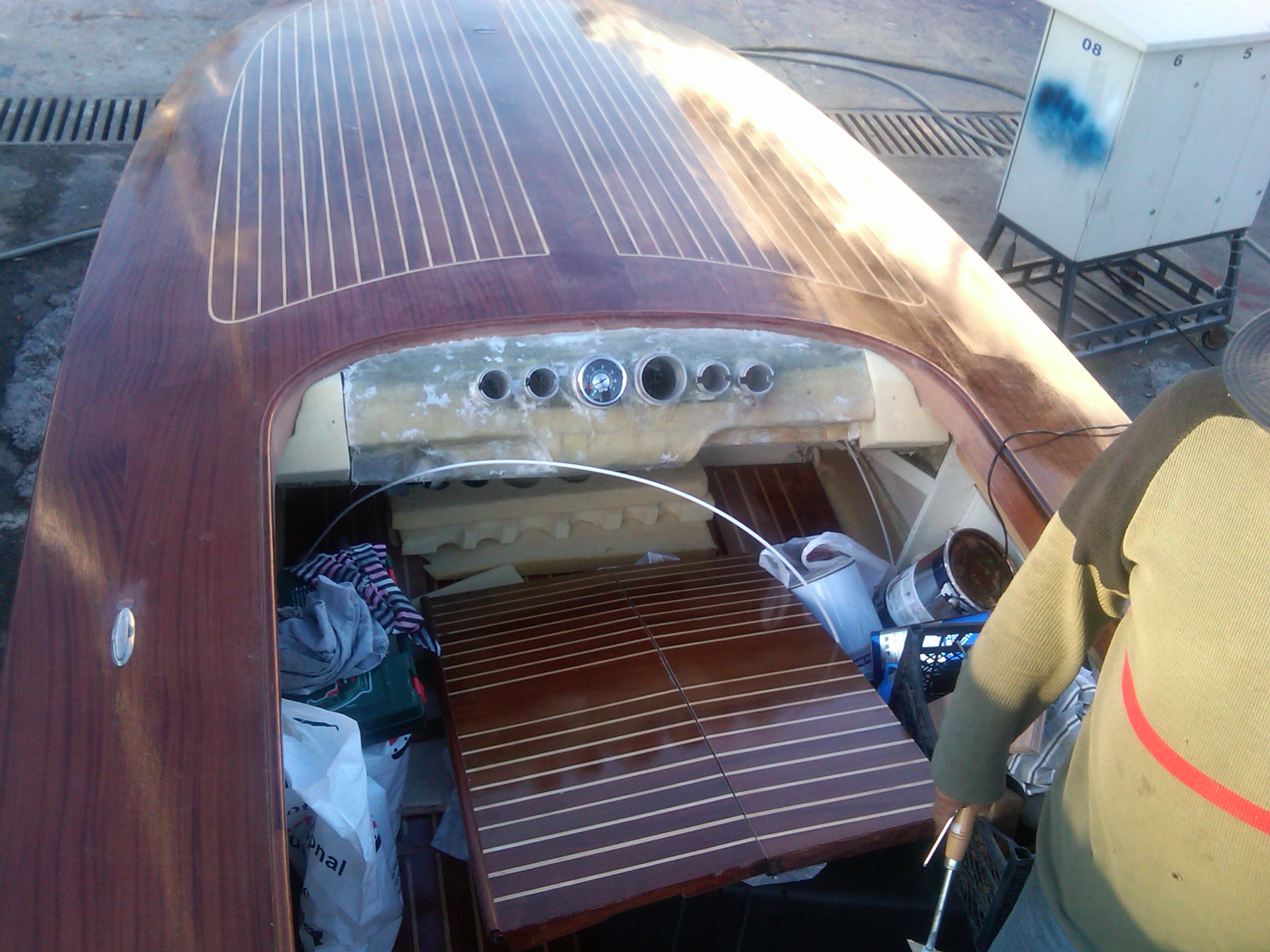

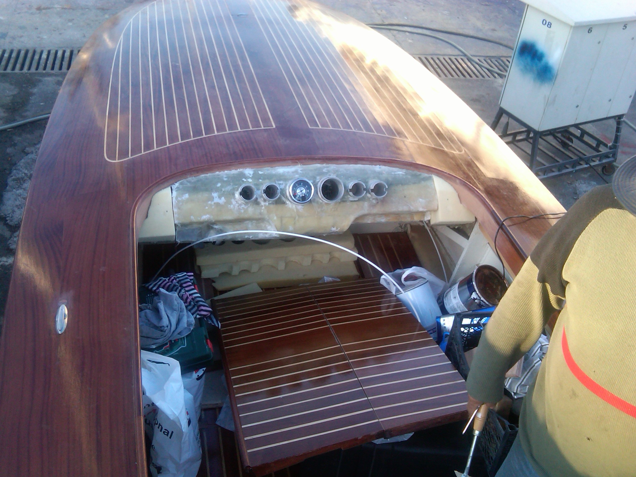

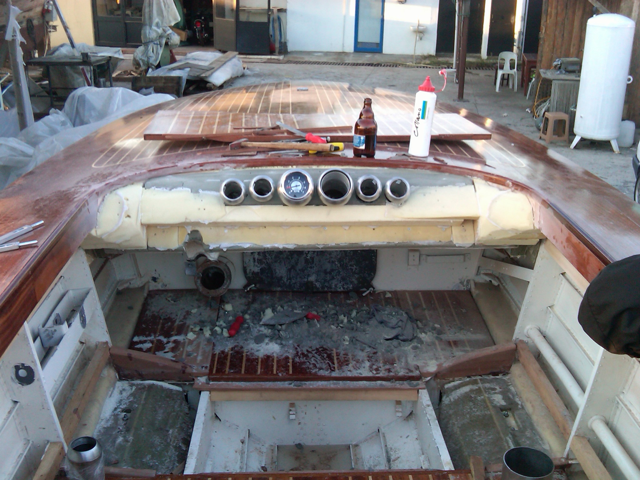

We started to add preinstall the cockpit gauges or their housings.
Nothing makes more dirt than shaping and sanding the foam.
The housings do not fit well, due to last minute decision changes with their distances. They still need to be symetrically fitted properly.
This is a view from front to back. You can see the closed box.

What kind of material are you using for the deck inside the 'cockpit'?

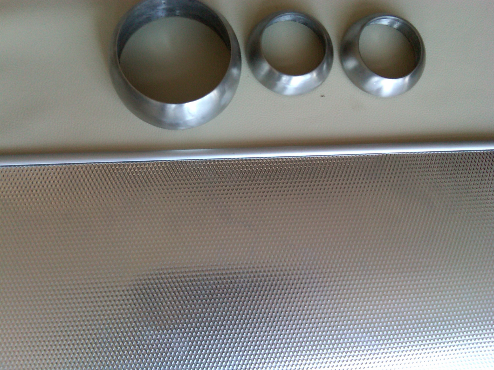

The material is pvc hardfoam sheets, we are sanding. The pipes for the gauges are Aluminium and they will be fixed via epoxy. The bezels are of stainless steel and what you can not see on the photo there are stainless steel guide/cover pipes, that will be shaped to the dashboard. The dashboard will after proper sanding be covered with epoxy and glass fiber, later a UV resistant beige artificial leather will be glued on. Below there will be an aluminium cover with all other switches, radio etc ...
The leather and the aluminium is divided by a thin aluminium strip profile.

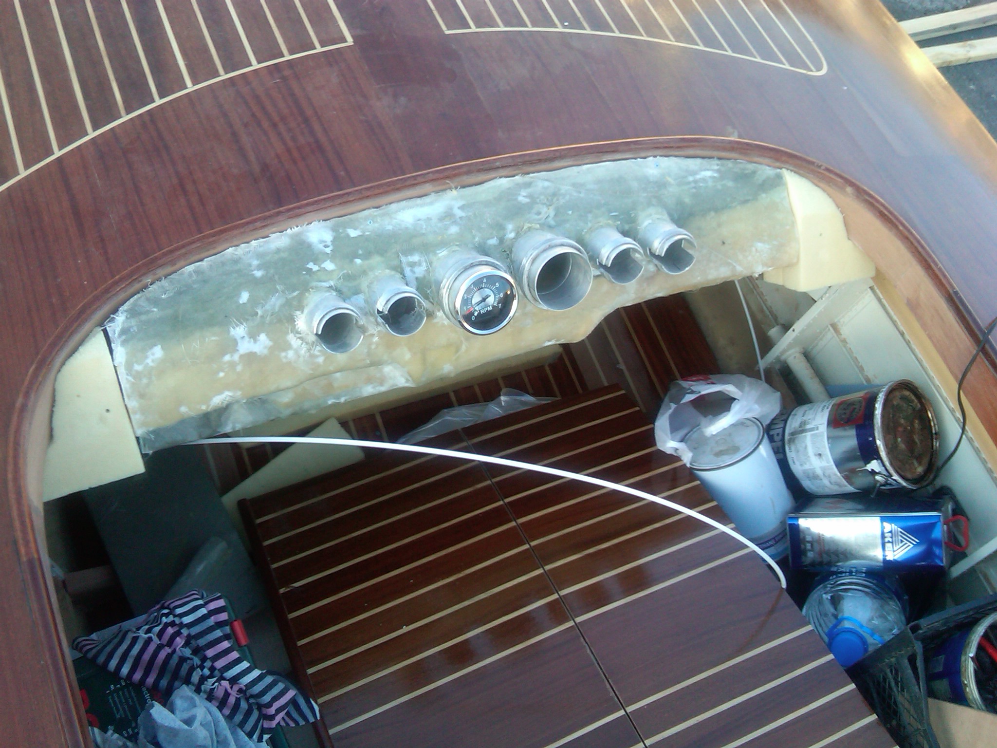

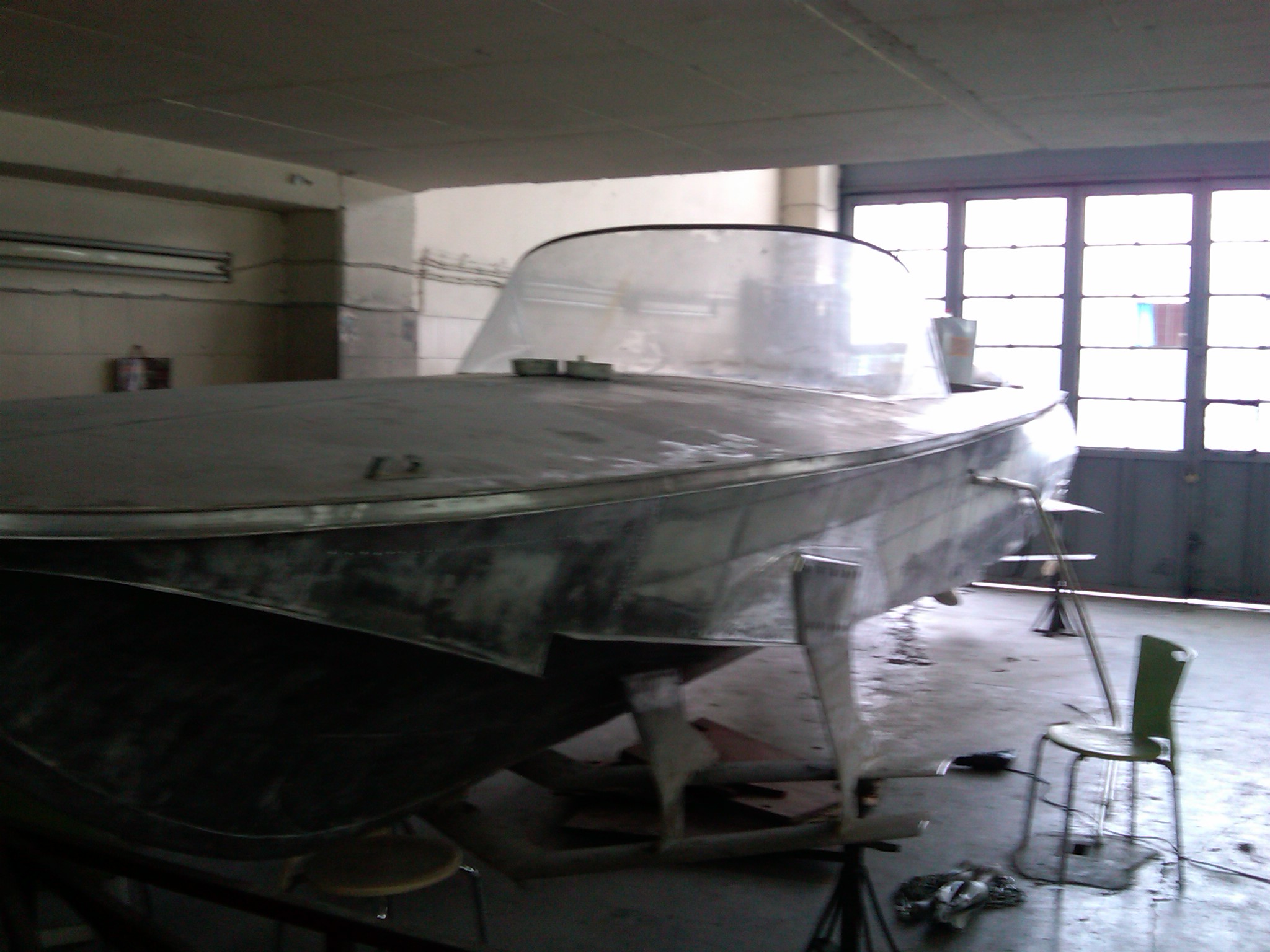

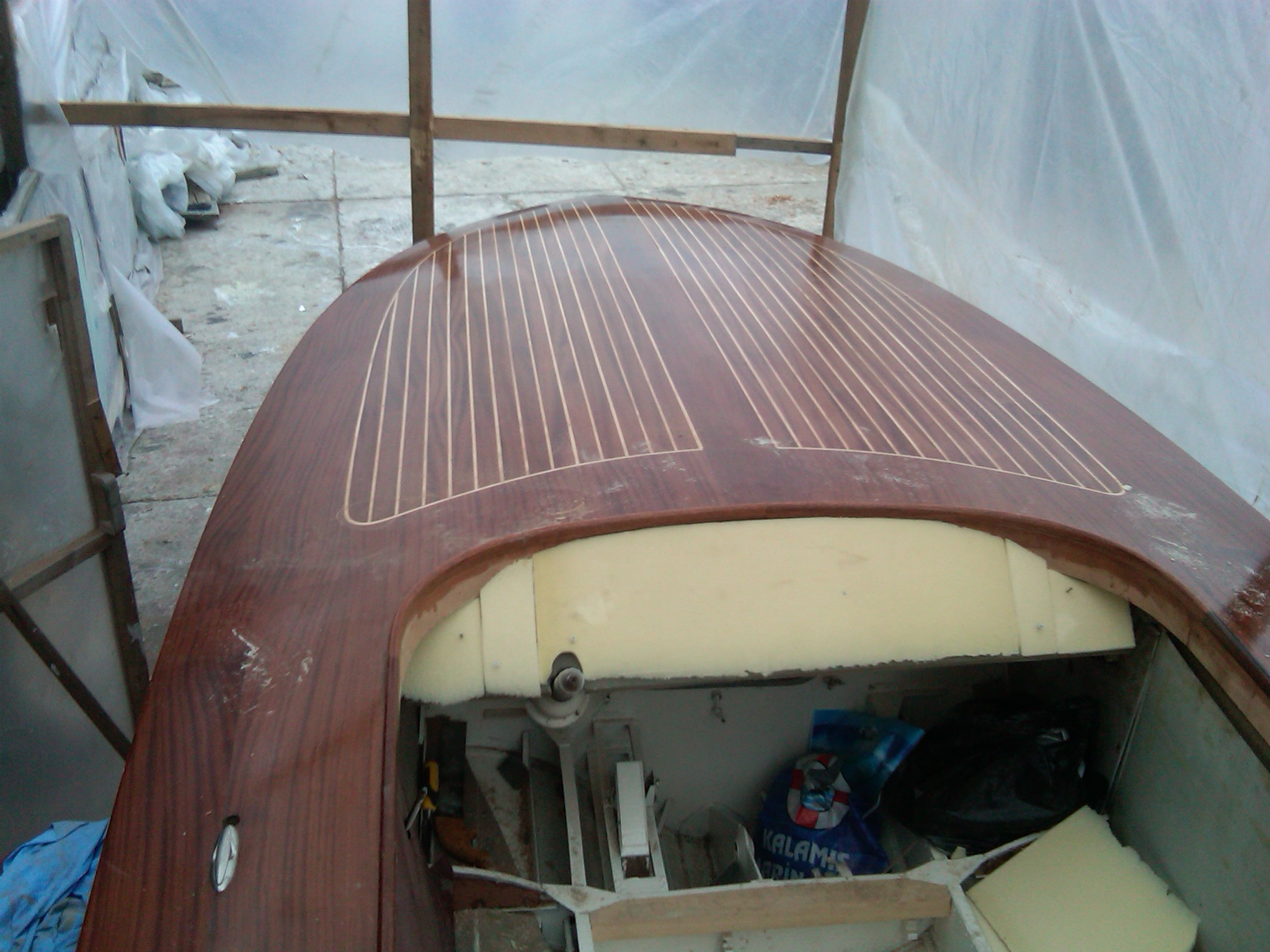

Cockpit has been covered with glass fiber and was epoxied.
The rough body needs reshaping with some plastering. coming soon.
Another view of the cockpit.
It is still incredible ugly naked and has to be reshaped with mastic.

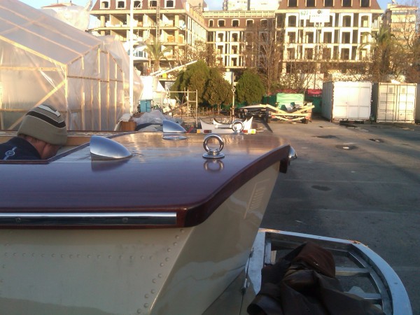

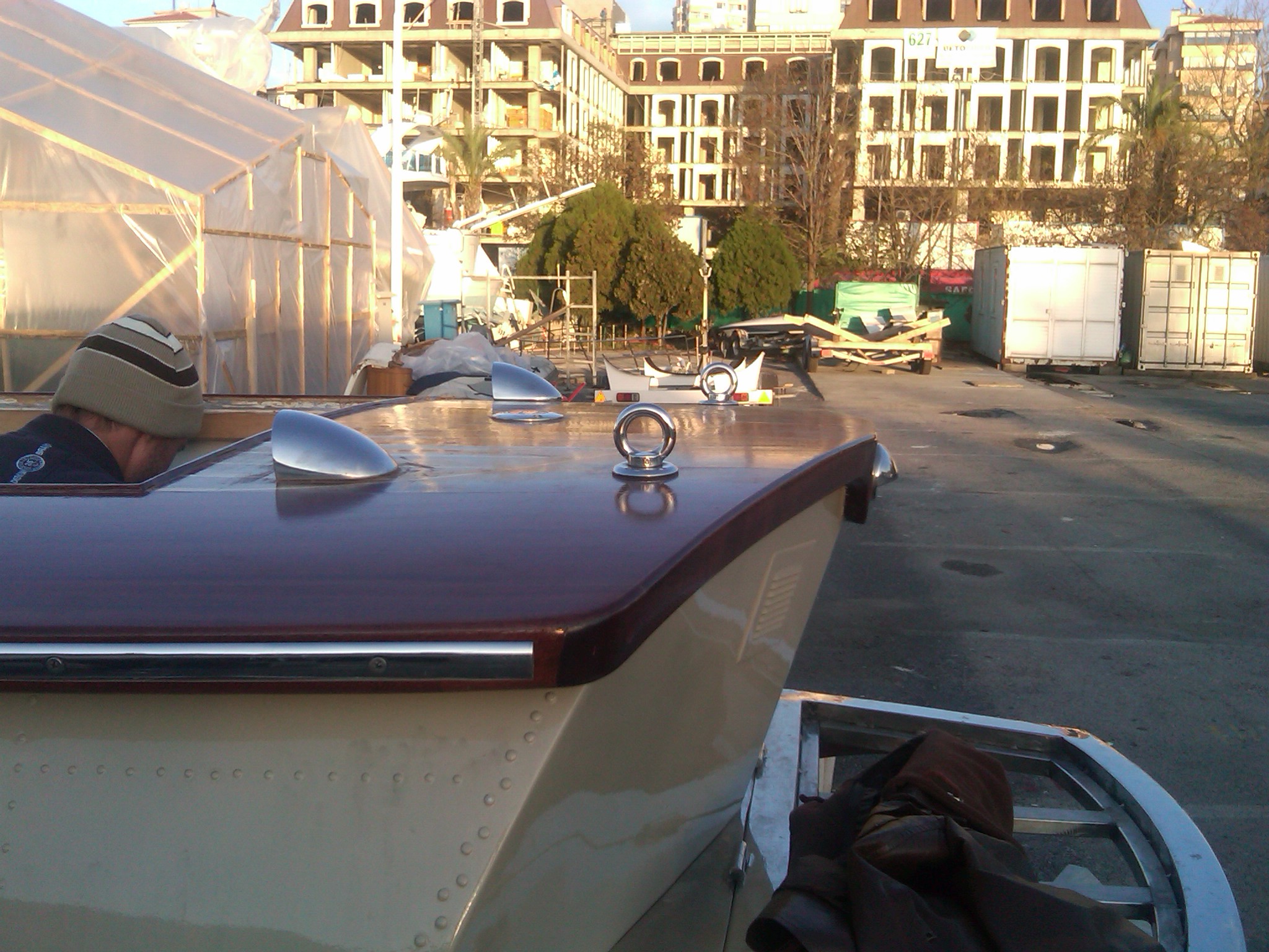

Renewed and installed lifting jugs. Stainless steel. We had welded the on the old construction.
Also the lifting jugs have been renewed.
Looks more civilised than the old rusty russian ones... I think they must have been cast iron and meant to tow a T-34.

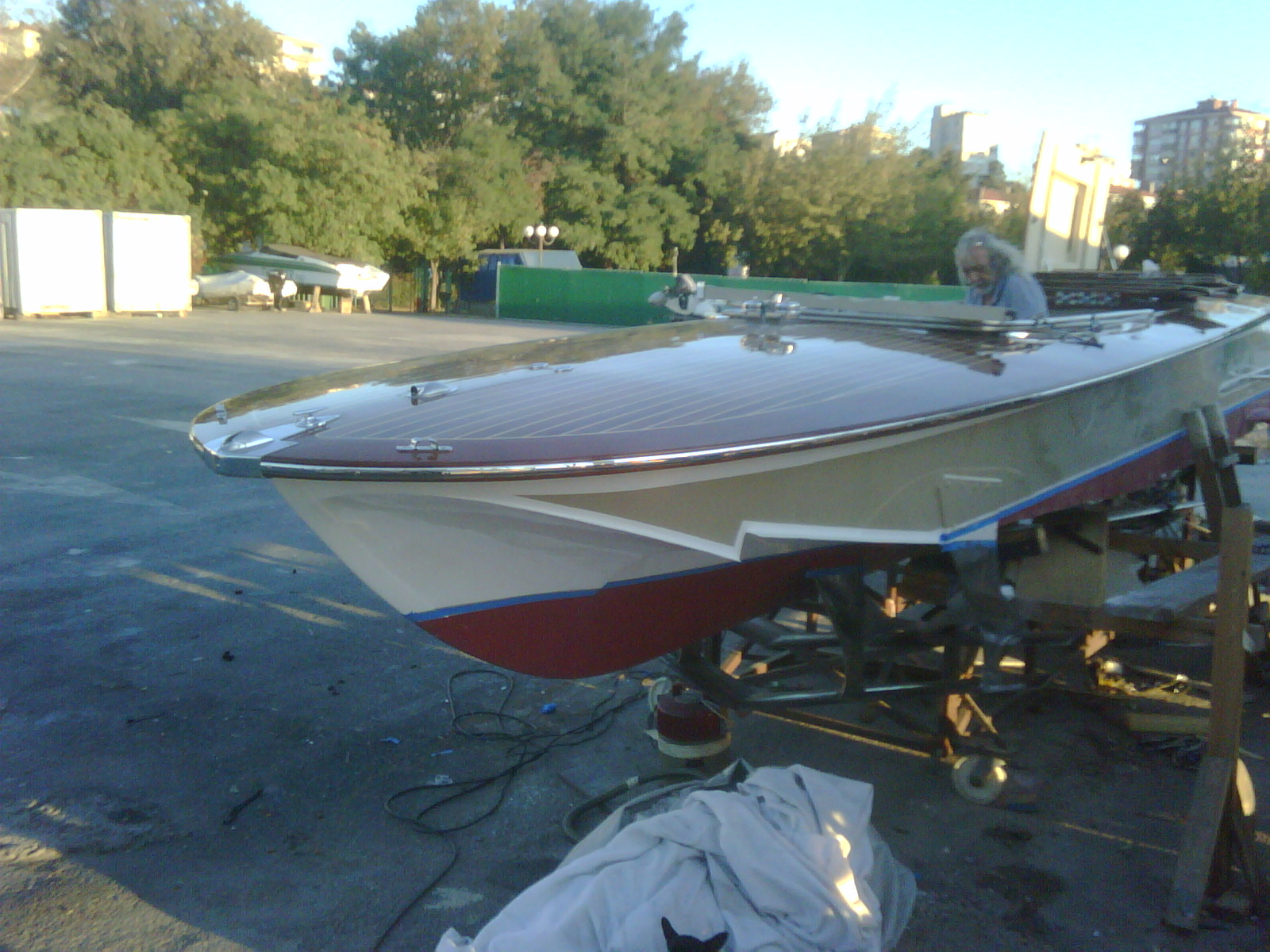

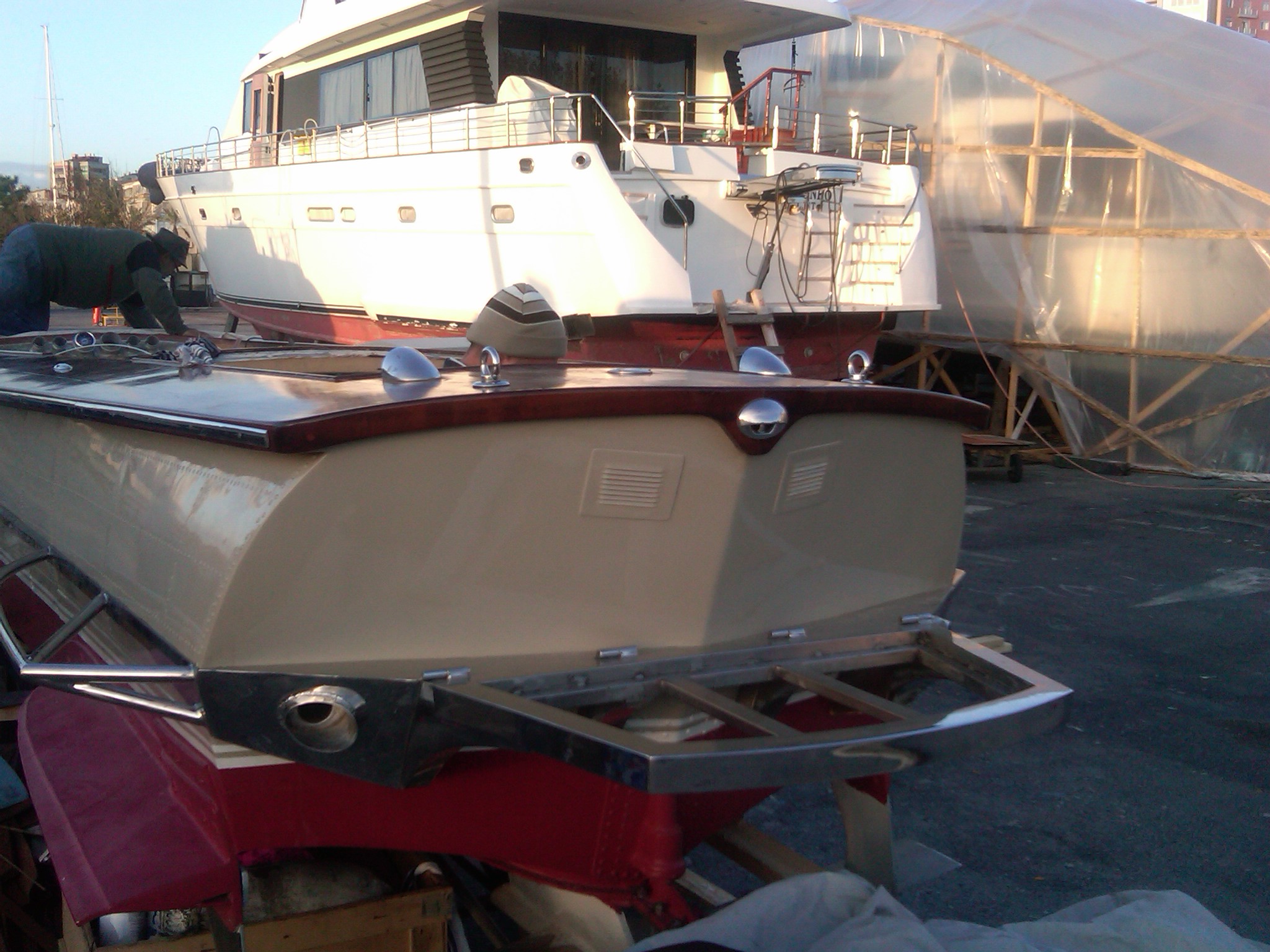

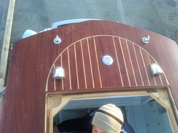

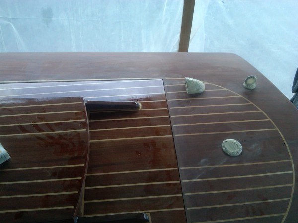

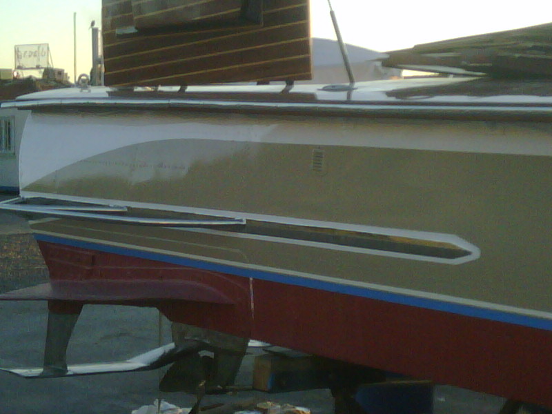

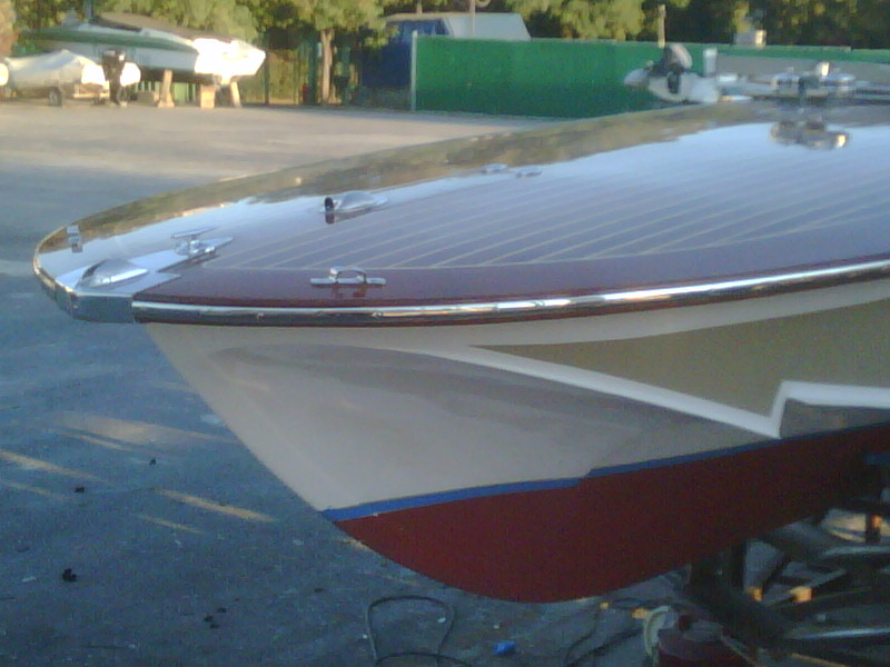

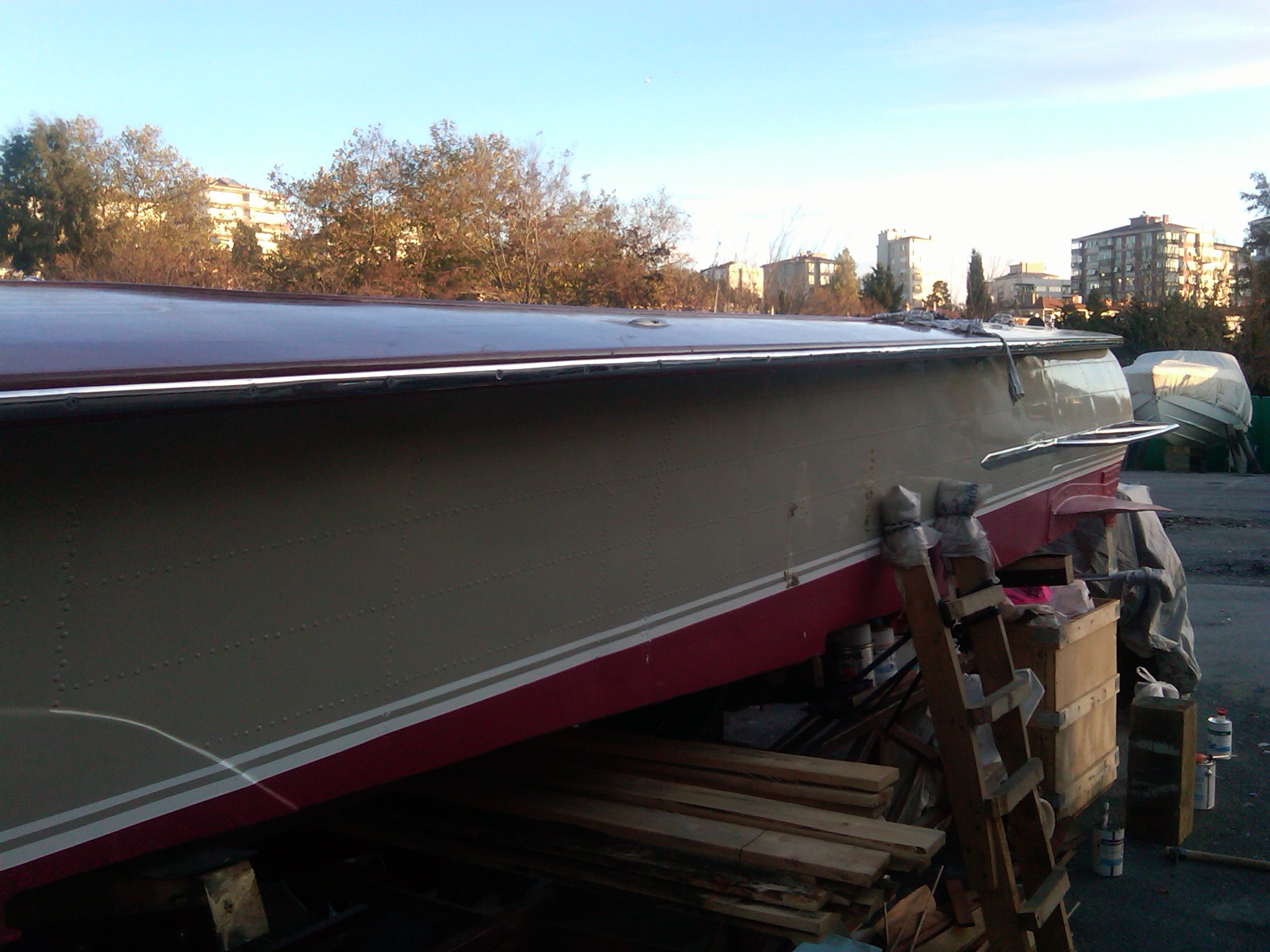

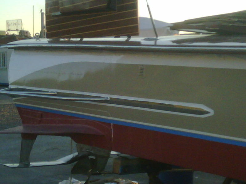

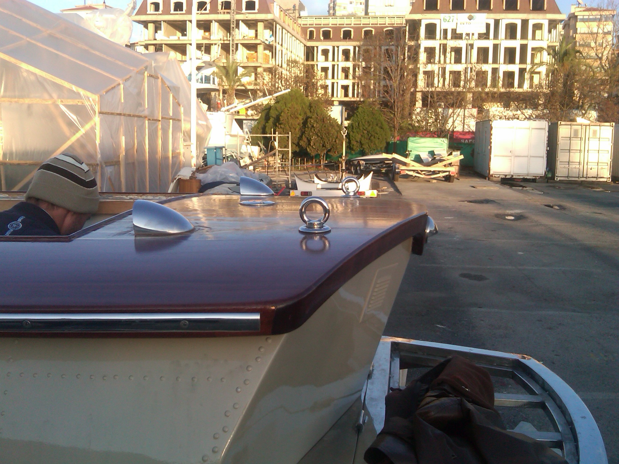

The new paint pattern with the chrome stuff
Even when standing still the arrow on the bow makes the volga faster
bow close-up
bow close-up
white lining around the chrome side bumper

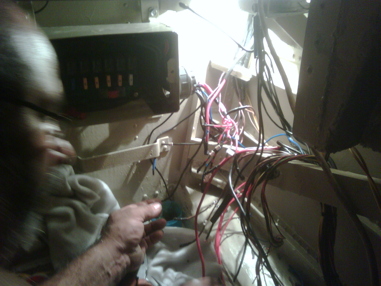

Never-ending trouble with the electric wiring hempers us to finish the inside of the boat.

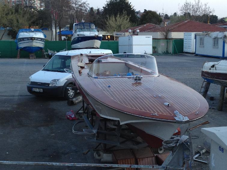

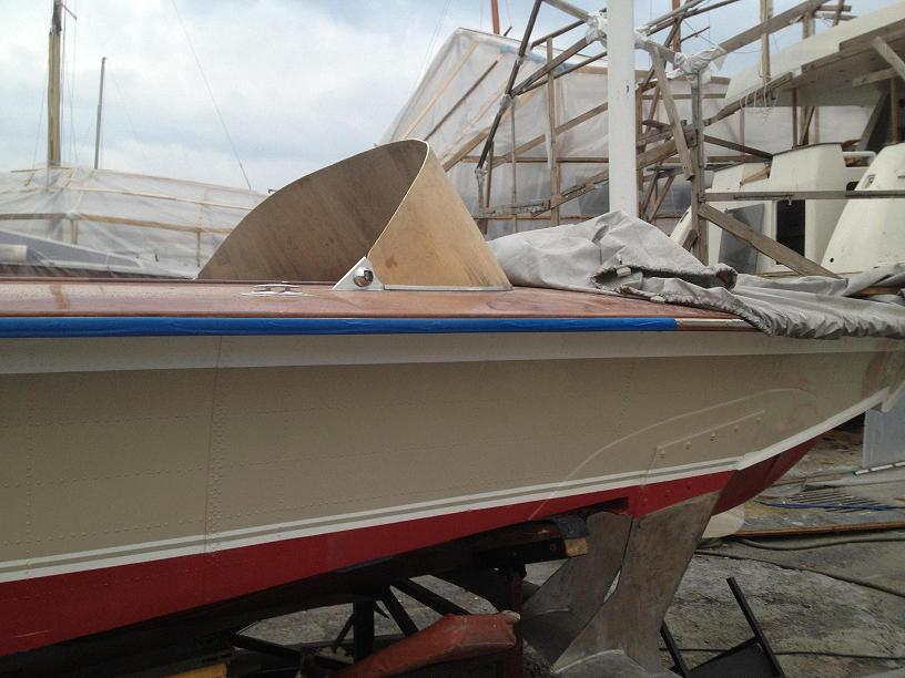

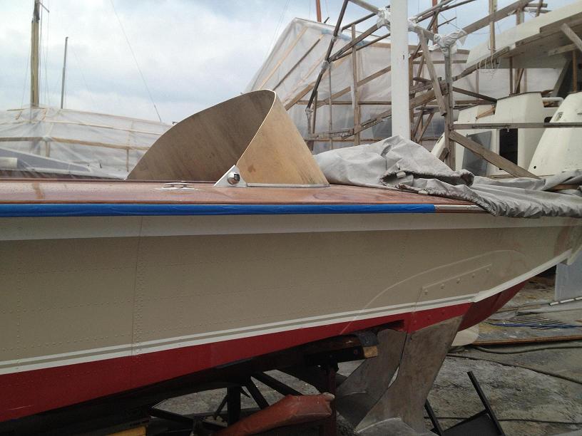

Before starting with the screen, we had to make a welded stainless steel rim (holder) and had to bolt it on the hull. The rim had to fit the shape of the wooden inlays and had to go in paralell to them. Our mistake was that we used a rim with only 1 cm. We experienced that 15 - 20 mm would have been much more sturdy. Last not least for fitting the screen better.
A welded steel model was made first, which could not be used by the screen maker. The effort for it was in vain.
So we were advised to make a plywood form instead and for this we were asked to buy a special plywood on the market called ''prostitute-plywood''. This name was given, due to it's fame of being able to turn in any direction.
Shaping wooden model with prostitute-plywood
Prostitute-plywood form ready!
Even if donated with promising name, the prostitute plywood revealed itself as tricky and difficult to handle. Some rainy weather made it wavy and worn-out. To apply a sample in plexiglass revealed itself more usefull than fighting around with the hooker-plywood. (Several failed tries led me to this way. The applying of the plexiglass took only 2 hours.

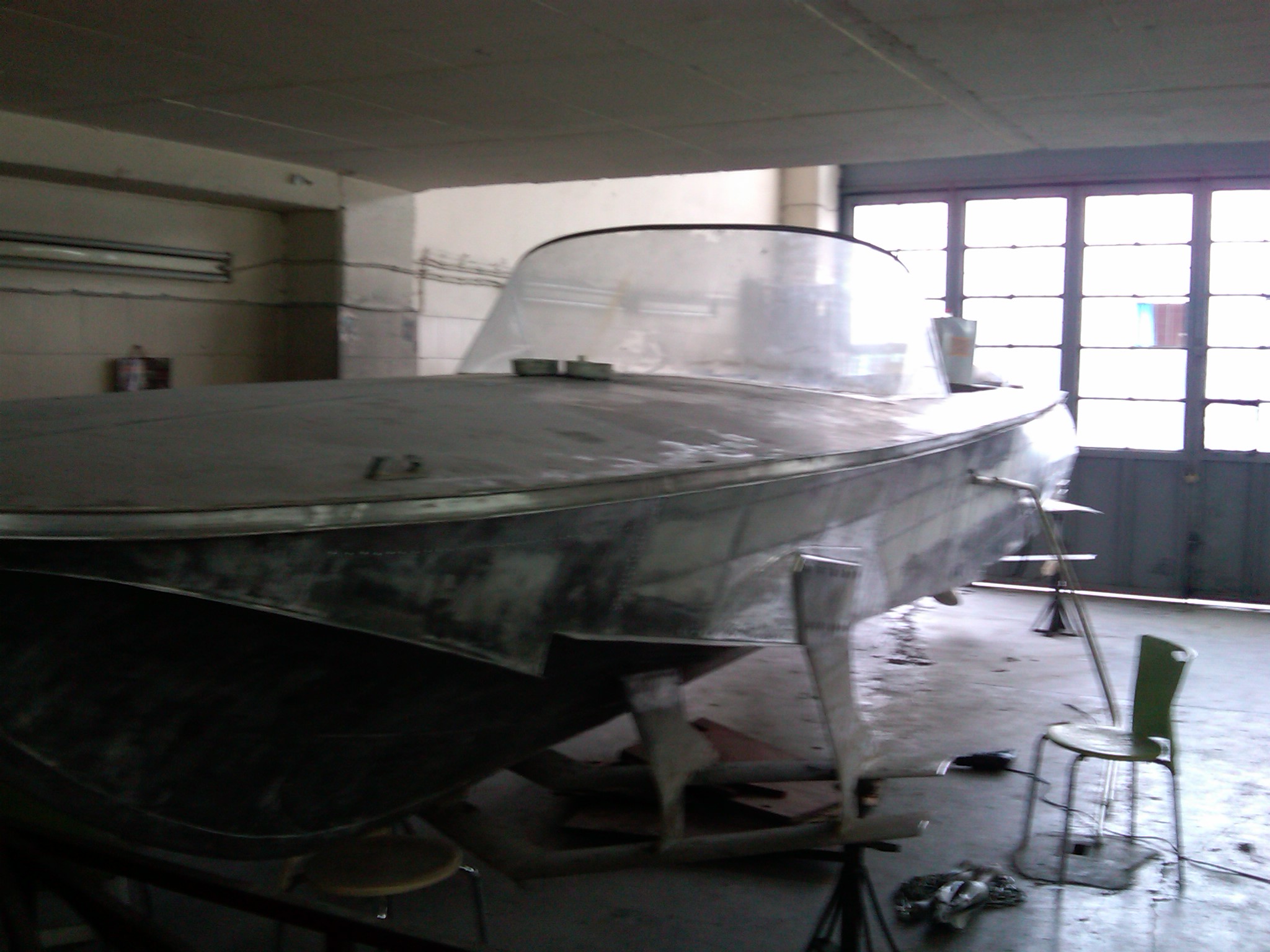

Plexiglass prototype model

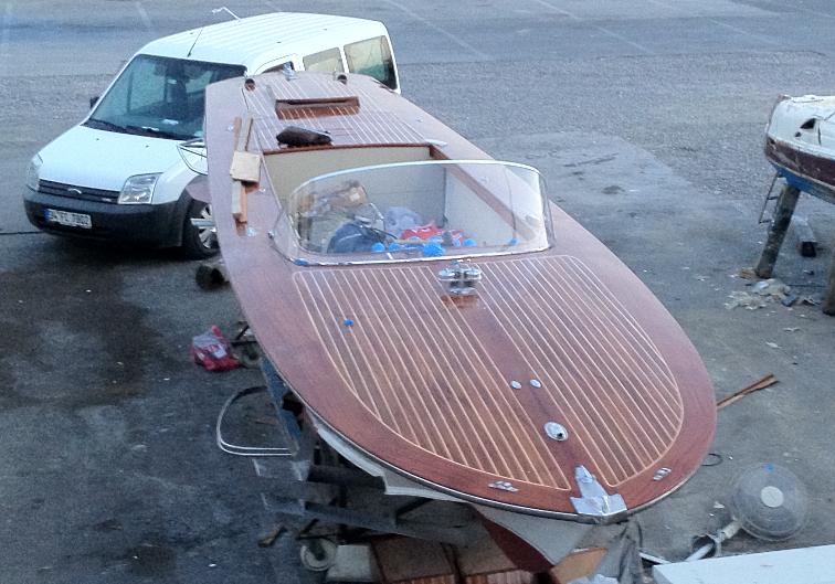

View from a higher place
What you might not be able to see, is that the new screen is already 10 cm lower than the original one. The original (later version) was oversized for protecting the passengers of wind and spray, but the estethic of it suffered under it, making it look like ''Barbie Runabout''!
Of corse another 10 cm lower would definitely have been more sexy on this boat, but I did not want to sacrifice the comfort f5urther. The windscreen is having 55 height instead of 65 cm.
With the ready form, I intend to make an Akrylic version instead of plexiglass.
