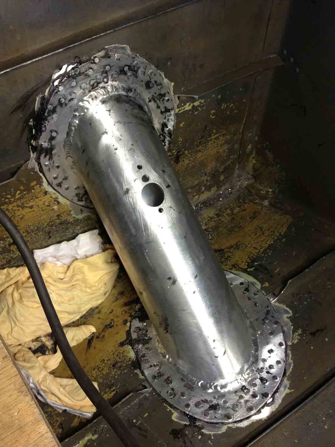

I am installing a Sidepower SE-40, the smallest diameter bow thruster of 125mm.
For the tunnel i am using 57s aluminium, with inboard welded flange and supports, and riveted like original.
I have cut the tunnel for exact inside fit and drawn a 30mm flange i need to laser cut tomorrow and weld on. more pics to come.

Today i made the flanges and welded them on to the tunnel. Since it is only 2mm thich i have made a reinforcement around the motor mount.
Pics tomorrow...

A few update pics... the tunnel is now ready to be installed in the hull.

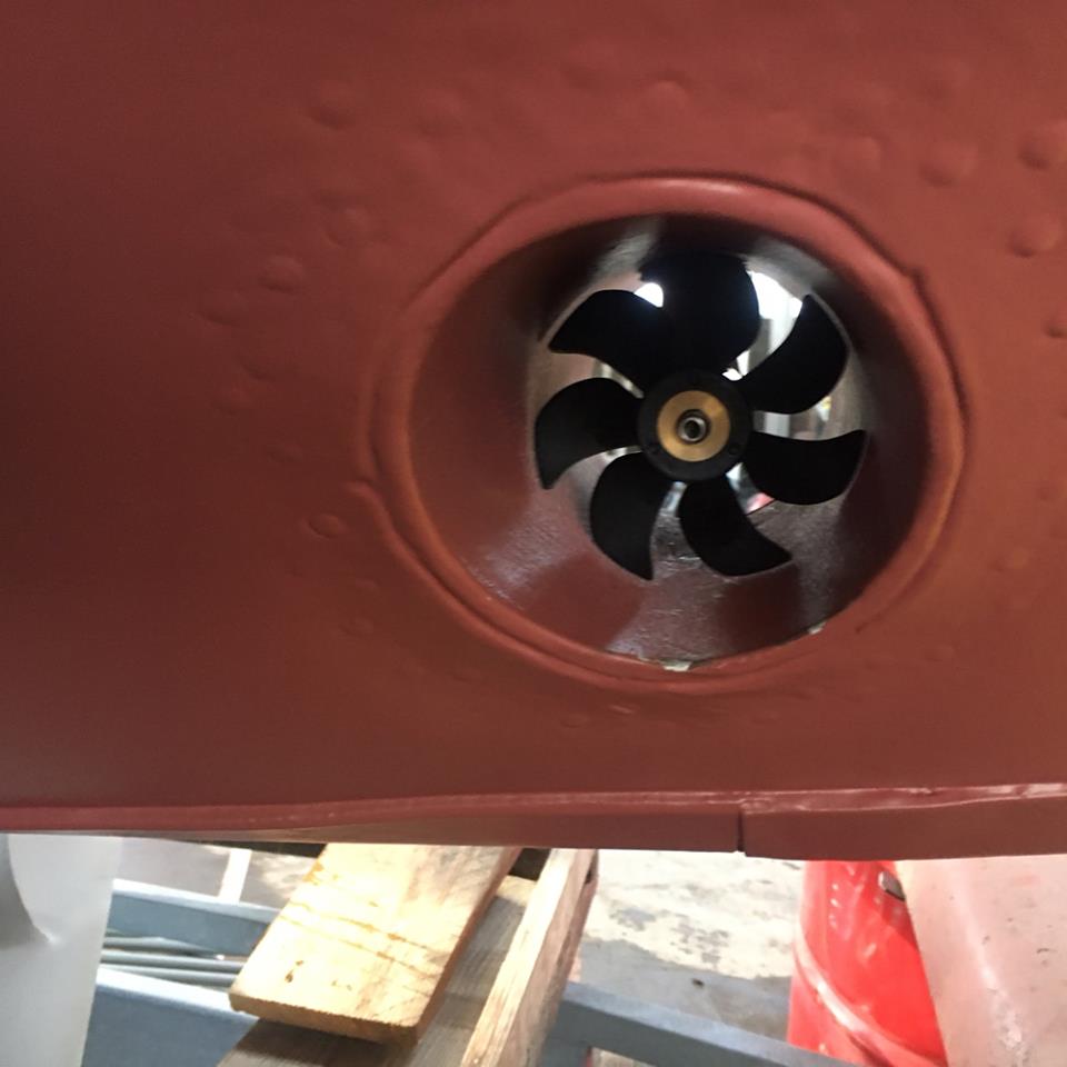

The thruster tunnel is now installed and riveted to the hull. I have painted it three times with 2-component epoxy, before the bottom paint.

Its like a dream come true, my Volga can steer in tight places now:-)
The thruster is absolutely fantastic, i Can do a 360 turn in less than 30 seconds with the stern staying in the exact same place! Continous operation limit is 3", so the 40kg thruster is more than you will need.
I have mounted the joystick behind the dash, so only 2 cm is visible behind the steering wheel.

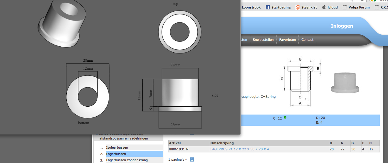

Today i also placed a order for some nylon spacers.
More than 50% of my rubber insulators of the foil bolts is gone

end result..
