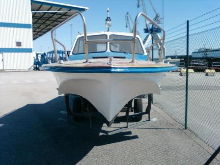

I am working hard on restouring my volga -75 with doghouse orignal? new prop 15x21 vp mercedes engine 115 hp.
New electricity wiring, overheated engine and some new interior.
lots of work but what a fantastic boat
History: four boats were special made for finish coastguard 1975. Two was smashed and crashed and two was sold probably 1990. I bought my boat in finland it was in the same shape as used by the coastguard 280 and 15x17 prop but the engine was changed by the owner before me to a mercedes diesel 5 cyl 3,0 l 115 hp now conected to the 280. I changed the prop to 15x21 it makes 40 knots at 4200 rpm. But a lot to do. The boat was not in so good condition as i thought when i bought it.
Does anyone know where the serialnumber or shipyard name are marked in the boat?
Bild 002.jpg (27.42 KiB) Viewed 879790 times

Here are some pictures of my Volga just before going into the water. It has been a long winter. Hopefully i have found out what was wrong with the cooling of the engine, it was the thermostat that was not for boat engine but truck. The thermostat looked ok and opend at the right temp but it could not close the by pass line in the engine. It was only taking warm water from the engine when it should take cool water from the cooler. Hopefully it will work now. I will also test a lot of different propps 15x17, 15x21 and 14x19
