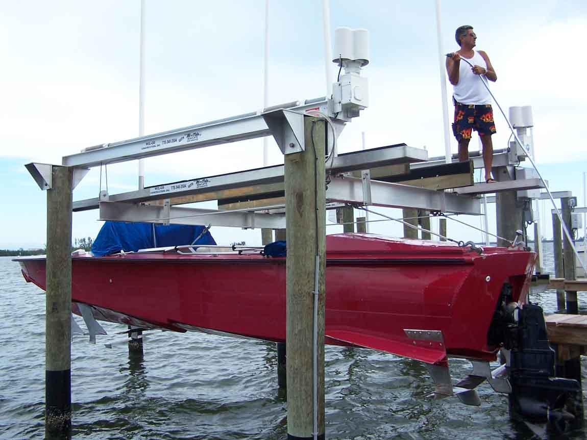

Posted: Sun Nov 22, 2009 4:29 pm
by Jim Pedra
This is my boat before I changed the lower unit to a duo prop
