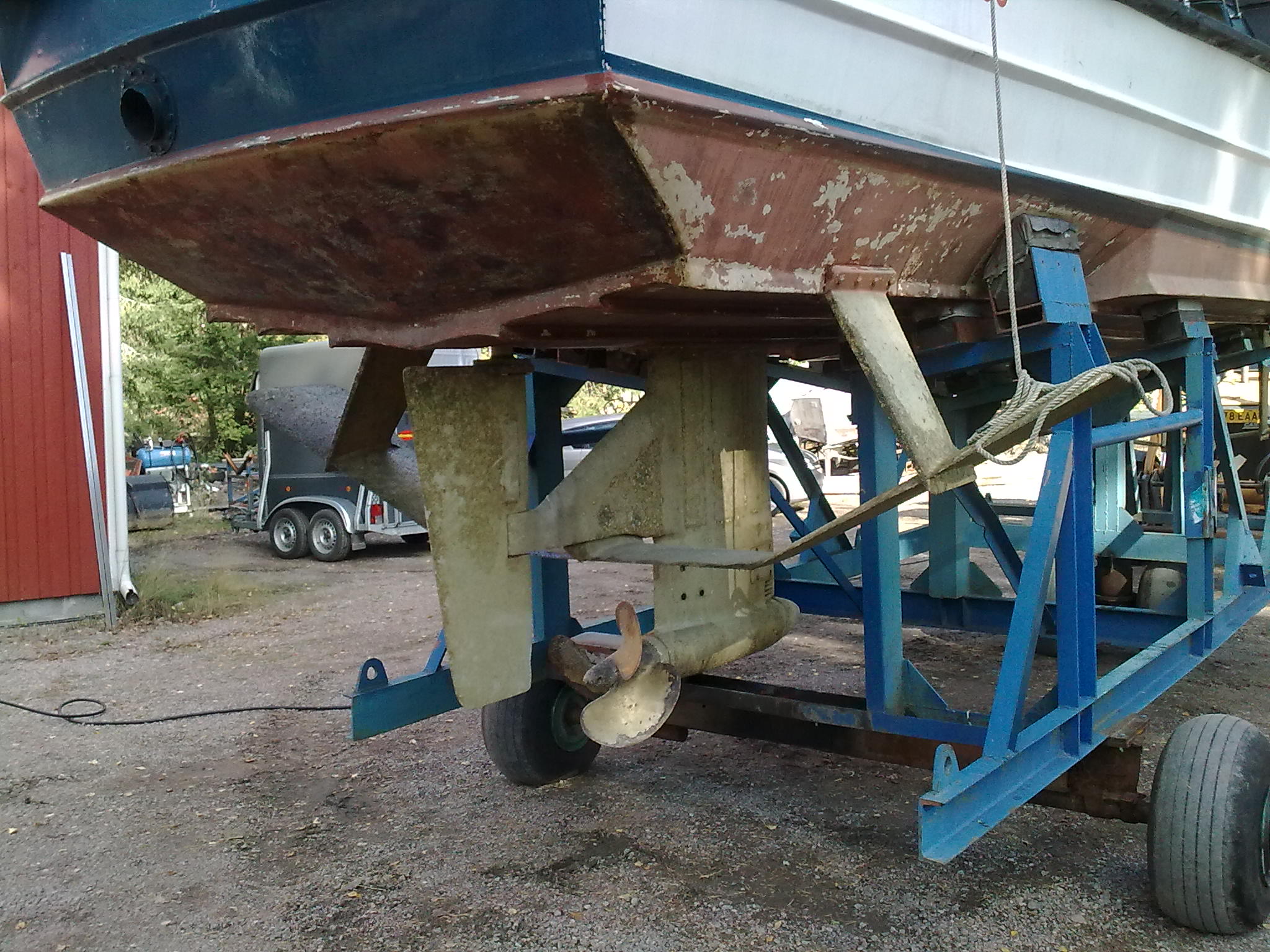

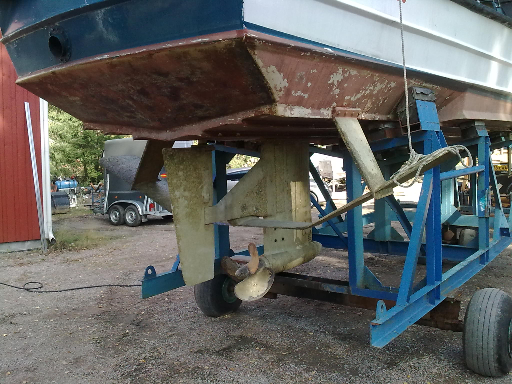

Summer has gone fast an been very busy, but something has happened on my Volga restauration.
At the first I have 2 Volga 70, of 6, on water and one NEVKA which I sailed from Petersburg one mounth ago.
So now the hydrofoil fleet has grown to 7 vessels.
Nevka is bigger, 11m long with epoxy composite hull and aluminum vings. Engine is a diesel 17 litre !! V- 120 degree 6 cyl 235 hp.
The oldest Volga with 6 cyl engine is allmost ready for final assembly. Engine is put together and painted, hull is straited out and welded a little here and there.
Now painting the hull. New floors have been made, teak on light weight plywood. New red leather sides and panels.
Seats are modernized on original frame. New original instruments, gearbox, V-gear with shaft and propeller.
All cromed part have been cleaned and recromed. New glass window and much more...
During summer I had only two technical problems with Volgas, on total driving time of about 50 hours.
First problem came after 30 min driving, engine lost power. One cylinder had low compression.. might be a valve problem. I have not yet opened the engine because I changed it into an other new 8 cyl which I had on stock. I will see in winter time if I will repair it or not, engine is generally in bad condition... It is easier to by a complete new engine in russia.
The other problem was the steering wire.... it broke off in a critical situation.... but without any bigger hazards.
Just now making plans for a total renovation of the Nevka during next winter.... save original engine and drive line, but new control and instruments,interior and roof. There will also be a toilet and a small pentry.
Within 4 weeks I think all boats will be out of water... to wait for next season in even better condition.

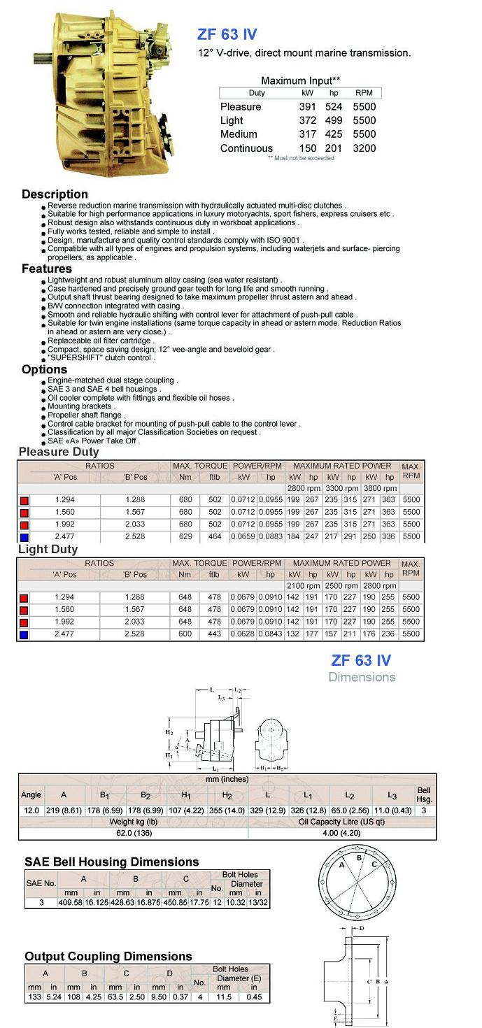

Thanks for your hints regarding the engine and their spares. It was really useful. Due to turkish customs complications, I however will purchase the spares rather than a new engine. It is also cheaper and my heart does not allow me to through away an engine just because it is needing some spares only.
Regarding your Nevka transmission and spare parts if needed. Should you really have problems reassembling it and are in need even to replace it, let me know! I may try to find you a brandnew ZF gearbox for replacement, if you let me know your reduction ratio. You may get it then via your local dealer.
The enclosed picture is for a V-drive suitable for Volga and you may use it with a gasoline or modern diesel in combination with a bell housing + bearing and a cardanshaft in remote location. This gearbox replaces the engine mounted gearbox and the V-drive gearbox (direction changer) and should make you half the weight of those components. The power factor (rating) is pleasure or light and it should be able to cover also the more powerful Nevka engine.
Please mind, that this gearbox has a hollow bored output gear, and the propeller shaft is being therefor led thru the gearbox and then mounted via a companion flange on the forward position. The companion flange is mounted the other way round. A very clever solution as you can place the gearbox deeper inside and access the bolts of the shaft flange from above, rather than fiddling like dentist under the gearbox in tight areas.
There is also a bigger V-drive gearbox available with other angle which might be more suitable. I'll enclose this one next time.

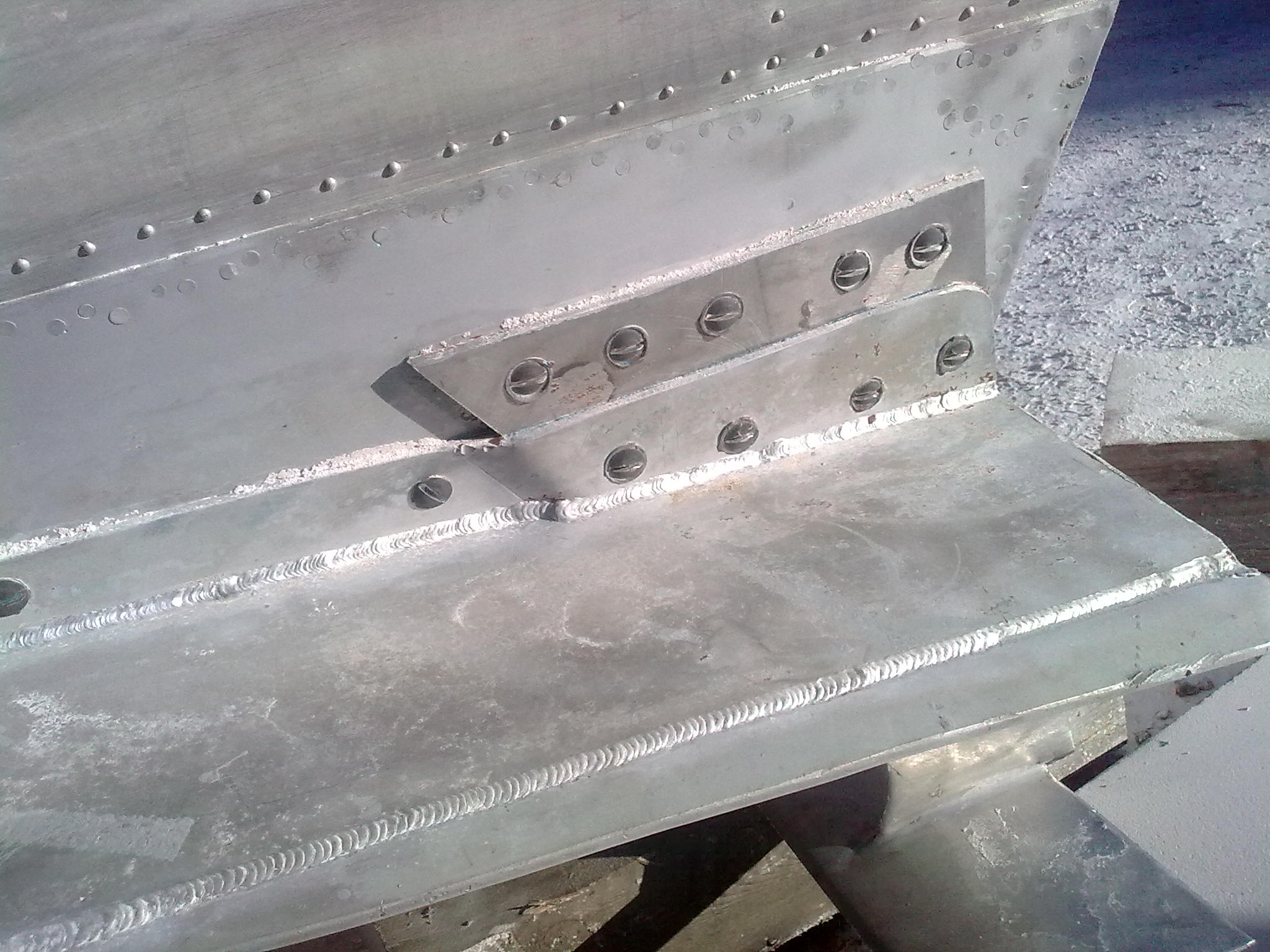

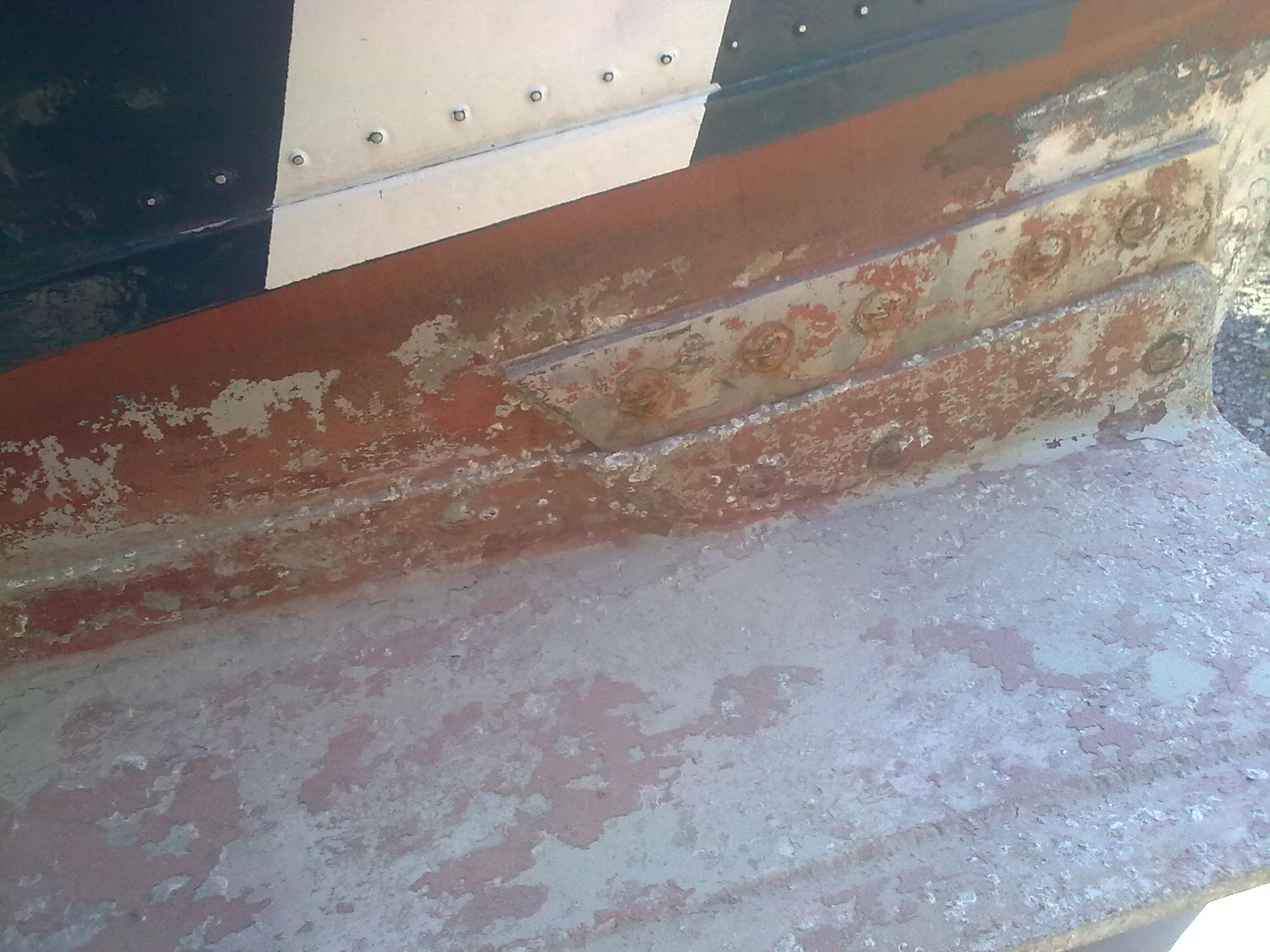

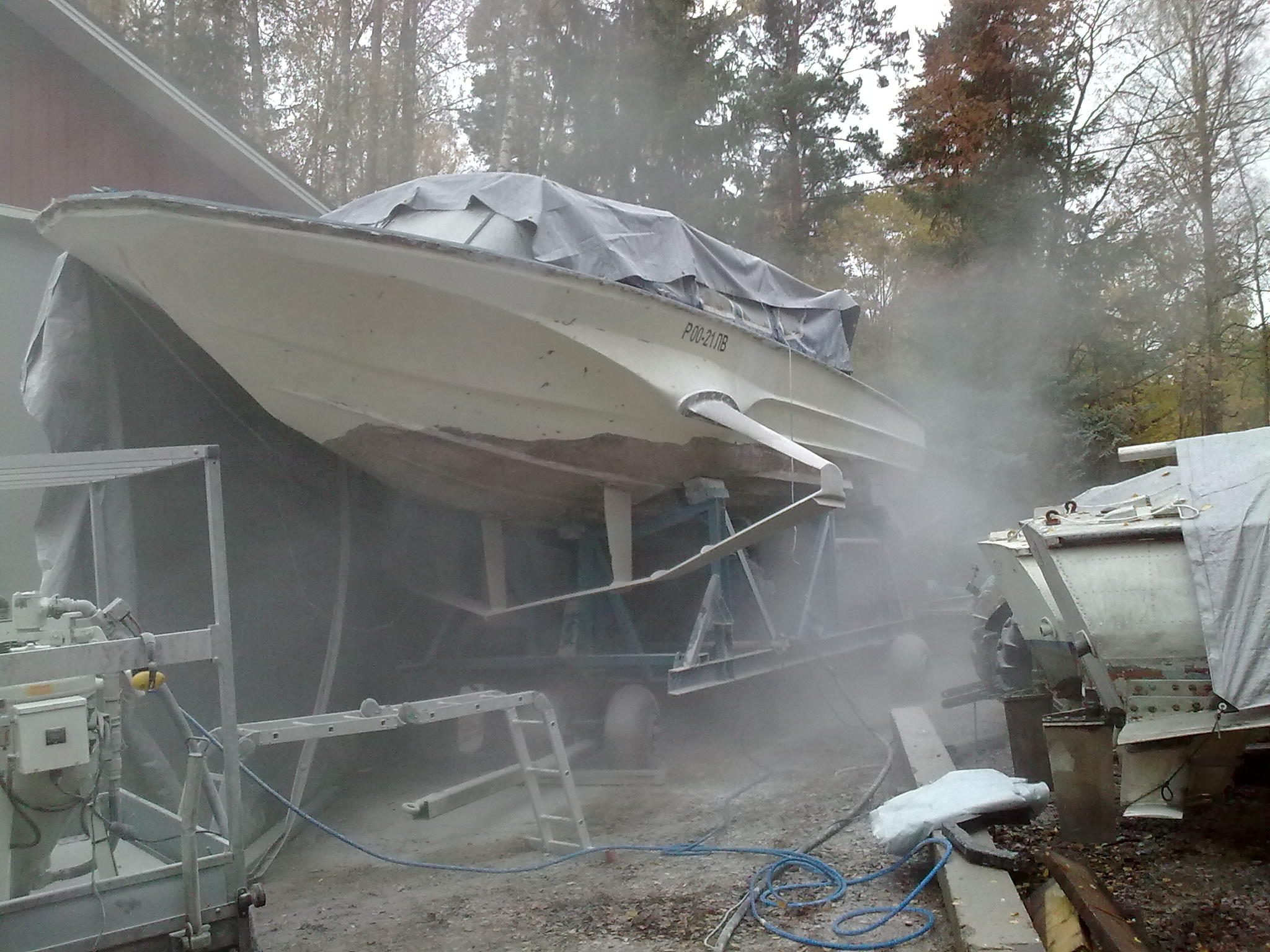

I just bought Soda Blasting equipment, have cleaned some aluminium boats and Nevka.This is the real thing for aluminium and composite.

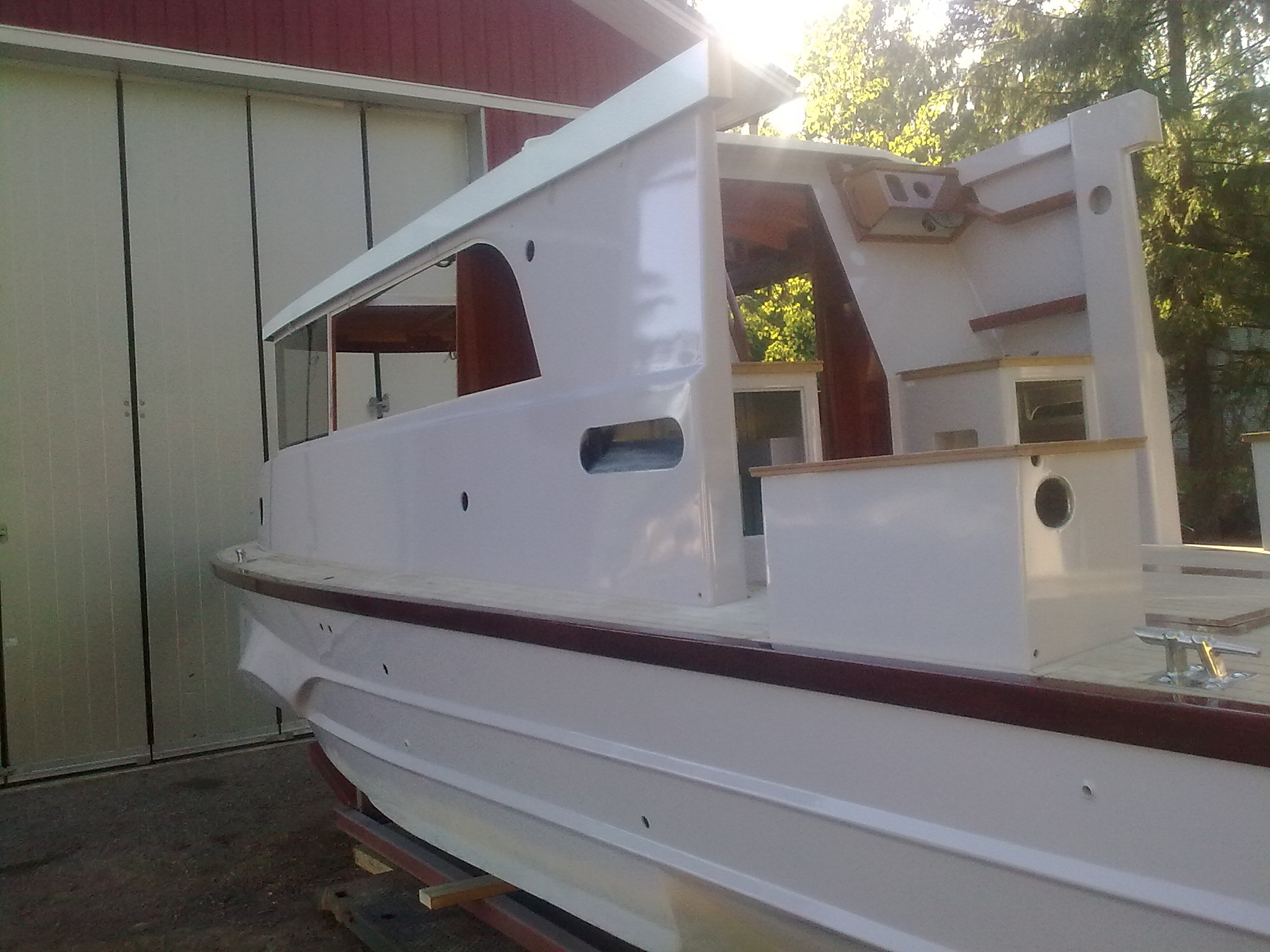

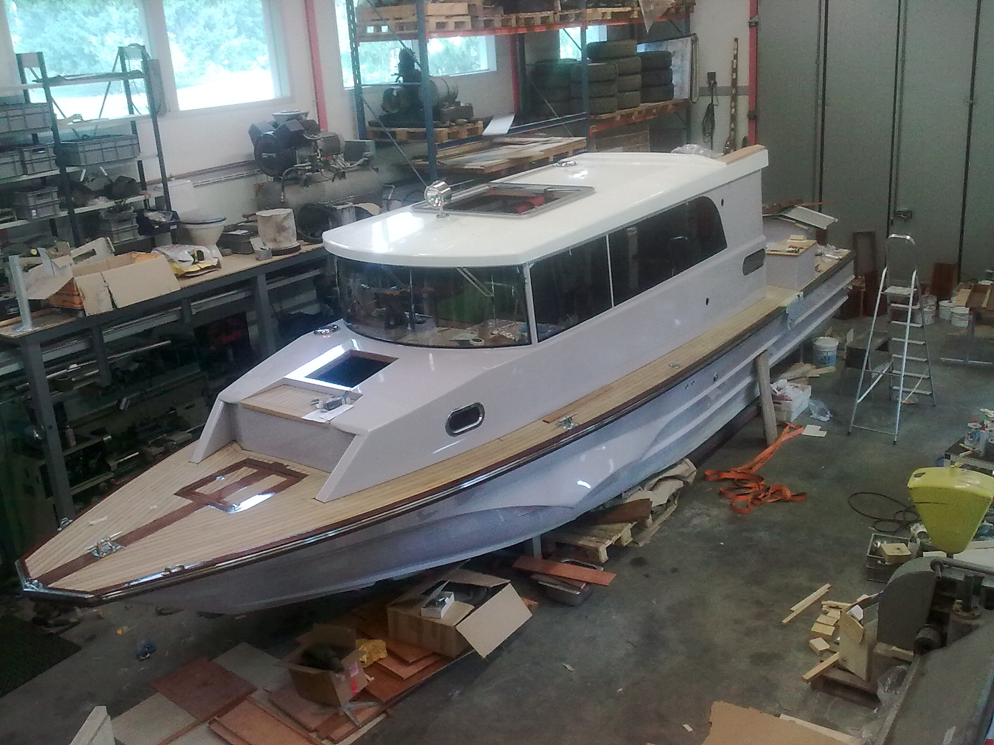

No so bbaddddd news here..... just been a hell of a lot of other work the last time. There were even NO Volgas on water here last year, even if there are several just to launch. This is unforgivable, yes I know it.
But something new has been done, a completly new Nevka. Only original, is the outside of hull and the drive line.
Enclosed some pictures.
BR
Robert

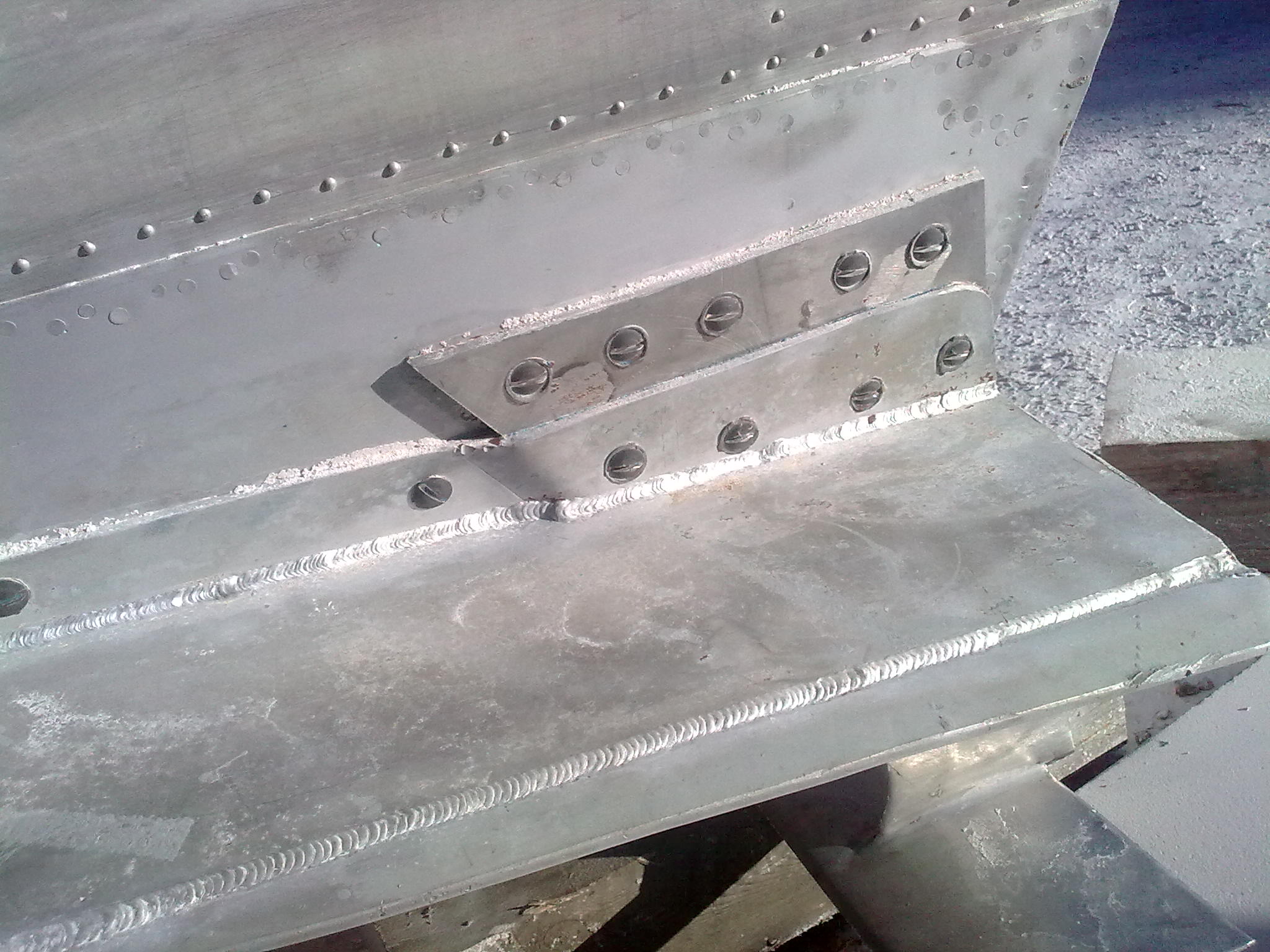

BR
Robert
