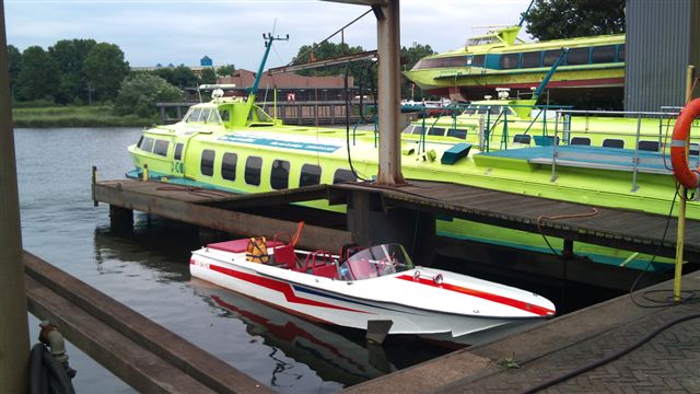

Just let you know i have joined the bulletin board. I have a Volga 70 for over some years now. Bought the hull in 1996 in Kiev together with two bigger Voskhod hydrofoils for the company I work for. That is Fast Flying Ferries or Connexxion Water in Amsterdam Holland.We now have a fleet of 5 Voskhod´s which we operate on a daily bases from Amsterdam to IJmuiden. On a canal which is 25 Km in lenght. This is for daily commuter passengers.
I bought my Volga hull with shaft and V-drive only. We placed the engine, a Yanmar 6 LYA 310 Hp, here in Holland. Runs great, do a lot of water skiening and treyed para sailing but that did not work out to good. Boat has a problem of barnical grouth here in the waters of the IJsselmeer. So one's so often we polhis the foils for smooth operation. This is also a problem on the commercial Voskhods. The full out speed is 71 Km/H. at 3300 rpm on the engine and propellor shaft. Transmission is 1 - 1 and the prop is orginal. I like the set up from your site about the bow thruster. This is on the wish list, and this winter it will get done.
I have enclosed a orignal brocure of SUDO export from the USSR. This was the leaflet i found in the Ukraine, when we build the new Voskhods for the company.
Best regards
Peter Venema

Your Volga looks great at the dock along the Voshods too.
