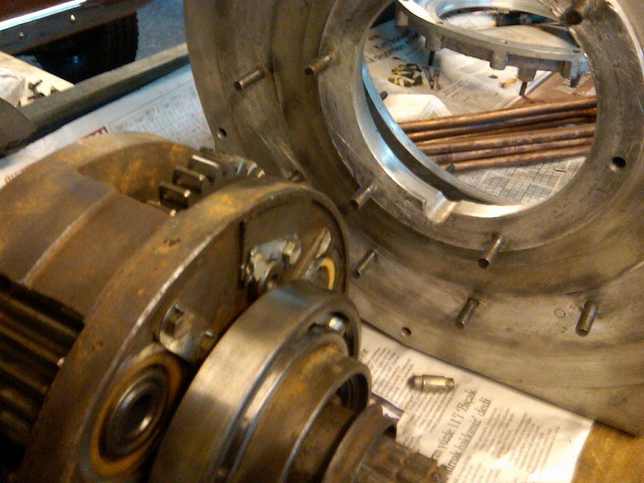

Anybody who had to take the gearbox appart will be surprised to see something very special, I would even say ''Jawbreaking''!
It is my job to sell marine gearboxes, therefor I know, that usually all gearboxes available on the market are vertical offset (plain, A- and V- drives) or coaxial types. But what we have seen when opening our gearbox was very unusual for marine use: A planetary gearbox! What a surprise! A planetary gearbox is by far more complicated to built, than a regular gearbox. The idea is to make a powertransfer via many gears rather than only one! The weardown of the gears is considerably lower, as the splitted powertransfer reduces the stress on a single tooth.
Again we can recognize, that the guys building these boats tried to use the best equipment possible and available. I couldn't help to make some photos and share this with all of us. One of them being attached, especially for those, who do not know what they have or what they had, but throw away or never found inside their boat. More of them to follow in a smaller size. Enjoy ....

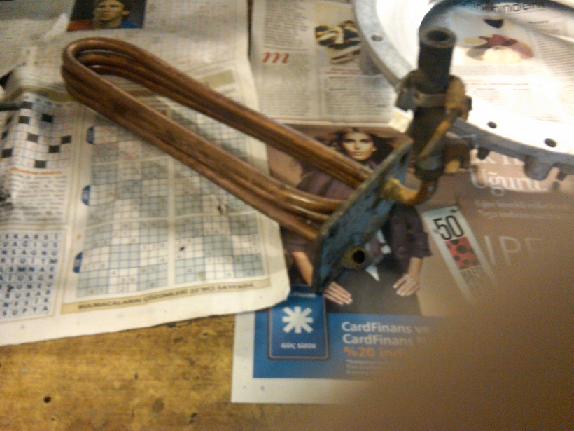

- Nothing has ever been designed more simple. For those addicted to SUDOKU, I can sent hi-rez pictures to make sure the boys stay busy!
- IMG00093-20091107-1440PlantaryGearbox-oil cooler.jpg (35.06 KiB) Viewed 378098 times

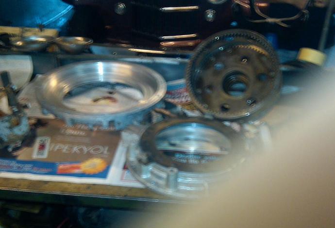

- The aluminium cylindrical housing! None of us were expecting a planetary gearbox inside this.
- IMG00090-20091107-1439PlantaryGearboxS.JPG (30.77 KiB) Viewed 378098 times

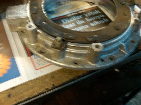

- Cover and some gaskets...
- IMG00088-20091107-1438PlantaryGearboxS.JPG (41.19 KiB) Viewed 378098 times

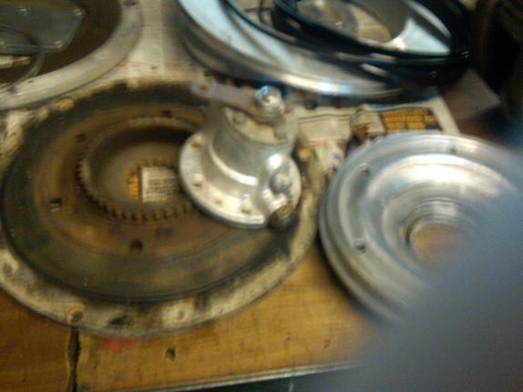

What we see here, are parts of the gearbox of a '86 built Volga and probably nothing new for anybody who was not yet obliged to take the gearbox appart. Once you have taken something of a Volga appart to mend, you are either surprized how simple they made it or you are surprized about them using equipment which was by far not very common in the West. This gearbox is something like this! And dealing with marine gearboxes, I can tell you it is odd to see another approach to boat powertrain transmission technology. I do not particularly want to say that they did things better in the USSR, but they had to use available eastern technology, rather than importing (or copying western brand's V-drives reverse reduction gearboxes) from Europe or USA. In this case it is a rather expensive constructed planetary reverse reduction gearbox with a direction changing 1:1 V-drive gearbox assembly. Any boatbuilder in the West would have installed a Twindisc or ZF V-drive reverse reduction gearbox, which would have saved the boat some 50 - 60 kilos of valuable weight (last-not-least the weight of a well brested lady), but our CCCP chaps just couldn't, because it was neither available, nor did the funds allow them to import something and besides this they must have been (and most probably still are) gifted with enough skilled women, where they had to take only one, rather than us being urged to take more(!?)

- The female part of the planetary gear cartridge on the right.
- IMG00092-20091107-1440PlantaryGearboxSFemalePart.JPG (37.52 KiB) Viewed 378096 times
- The mechanical actuating control valve. Simple technology - easy to repair if ever necessary!
- IMG00095-20091107-1441PlantaryGearboxActuator.jpg (29.46 KiB) Viewed 378096 times

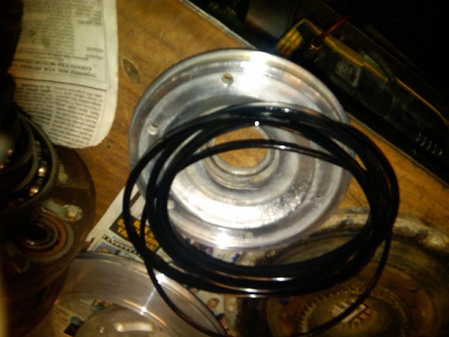

Part showing an aluminium cover with clutch discs fitted. You may see how much they were worn out.
Easy to be replaced by bolting or rivetting new ones on it.
- Some parts of the clutchpats are already missing. No wonder it did not function properly...
- IMG00096-20091107-1443PlantaryGearboxClutchDiscs.jpg (35.08 KiB) Viewed 378095 times
