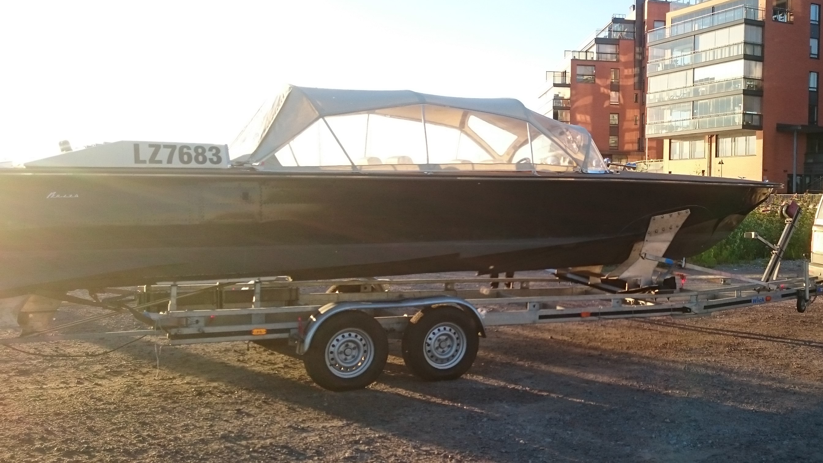

Re: autocad drawings for custom made traler and wings
When I bought my Volga I got this trailer with the boat. It works ok, but getting the wings in the right places usually takes a few tries.
--jWs
--jWs

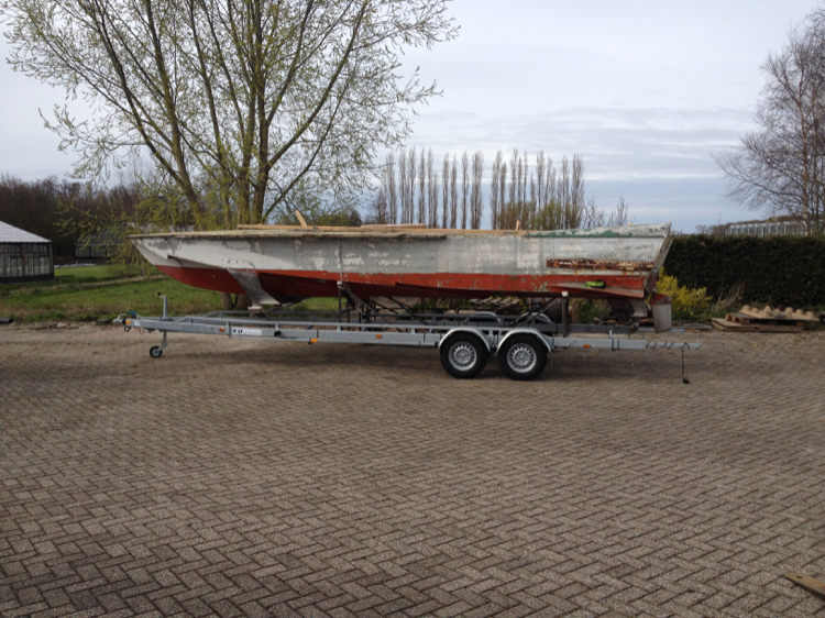

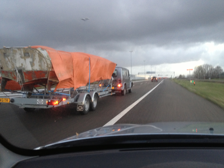

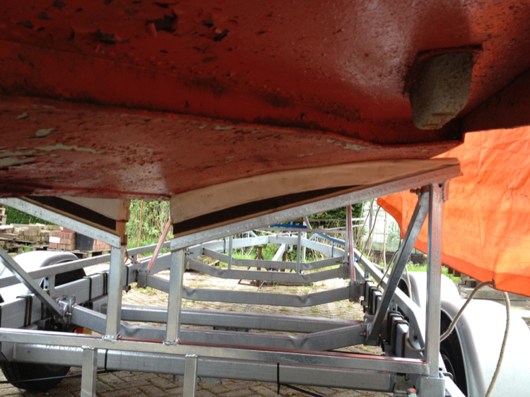

Here is my custom trailer.
It is rock solid behind a the car!
Trailer and trestle(?) are galvanized.

Hi, thank you for the pics.
At one photo there are the boat supports of the trailer lengthwise mounted. At the other trailer the spports are across the driving direction.
Has anyone experiences with the optimal adjustment? Because of the hull structure shouldn´t it be better to mount it lengthwise? Then the supports bear the boat over two bulkheads if they are long enough.
If the boat is beared with the across mounted supports, won´t this take effect to the hull? I could imagine there is a high bending moment from the overhangig back or front part of the hull. And with relatively small cross supports isn´t there an energy transmitted to the hull which is equal to a hammer stroke?
Second thing is, some lay the boat with the front foils directly (with a rubber support) on the trailer construction. What do you think, because the shocks from the road are stronger than from water, will this cause a damage to the hull?
I would appreciate your experience with it.
Cheers
Olaf
Cheers
Olaf
Good Question Olaf,
I copied the supports of the original "crate"what was delivered with the boat.
It is very solid.
And i think it is a good set up.
My trailer bends some on the front section,but not between the sports.
I have seen the trailer of Daan,Standing on foils,That trailer is SOLID.
I wil not bend.
Personally i would have made mid support on it..
It is very solid.
I wil not bend.
